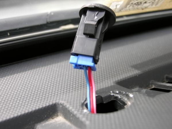

I popped up the dummy plastic piece. I just used a screw driver. A credit card was not stiff enough. At the bottom there is a blue connector with 3 wires: blue, red, and white. Since I at least have wires, I suspect the sensor ought to work.
So I'm buying an Automatic Light Control Sensor 89121-50020.
I just punched 89121-50020 into ebay and bought the cheapest offer: $6.83, free shipping- it's from China. I may be cheap, but I'm patient.
EDIT 2019-07-06 Finally got the pic to load. The dummy plastic piece, at the bottom there is a blue connector with 3 wires: blue, red, and white. This is from a 2016 SR5 Premium.

I popped up the dummy plastic piece. I just used a screw driver. A credit card was not stiff enough. At the bottom there is a blue connector with 3 wires: blue, red, and white. Since I a least have wires, I suspect the sensor ought to work.

I believe you are correct in that the premiums are fully wired to accept the sensor. The base trim models are only partially wired. I have a base SR5 and the plug was on the underside of the dummy plug for the sensor, but the wiring is dead ended at the large white connector in the dash behind the instrument cluster. I had to add three wires from that connector to a connector on the main body ECU. This was on my vehicle, but if you have a non premium and you plug the sensor in and get no dimming based on ambient light, then that is most likely why. I’ll try and post up the terminal repair part numbers for those who might need to order them for Toyota if the wiring is not fully there.

Lol yeah, it would make things much simpler! I'm actually surprised your 4R doesn't have the connector on the dummy plug. You could add the connector, but in order to do that you would have to pull the entire dash panel to feed the wire and connector. You can't feed the connector up under the dash because the hole where the solar sensor sits is completely encapsulated below by the defrost air ducts. No way to access it through the radio opening either. I learned that the hard way on another project.

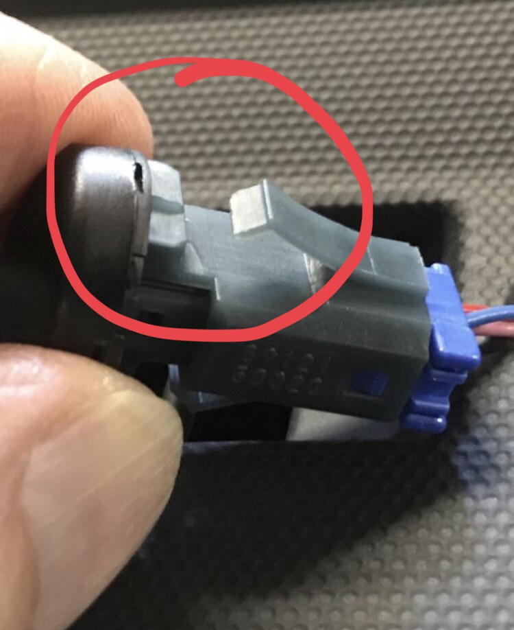

... I just hope these cheap solar sensors last, because getting it back out of the dash if it gets stuck is going to require going from the underside (I put one in my rig too...
Yeah. I was worried about that too. The clip-in tabs for the dummy plug are totally different than the light sensor tabs. It will require dash disassembly to remove a failed unit. Better test it with a flashlight before snapping it into place.

I just hope these cheap solar sensors last, because getting it back out of the dash if it gets stuck is going to require going from the underside (I put one in my rig too. I was going to go with the OEM, but when I saw the price of the OEM sensor I choked on my morning coffee).
I suppose if it doesn't last you're simply back where you started - with a dummy plug that probably just isn't worth the trouble to remove this time around?
