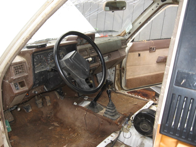

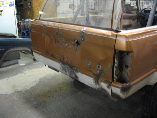

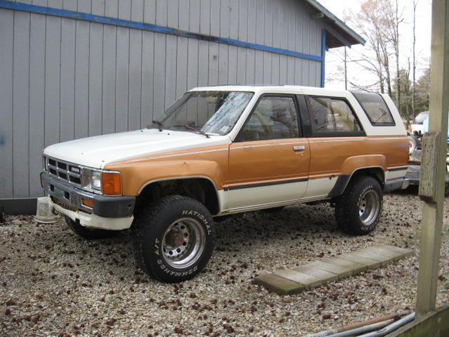

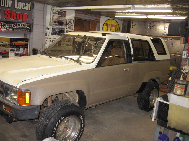

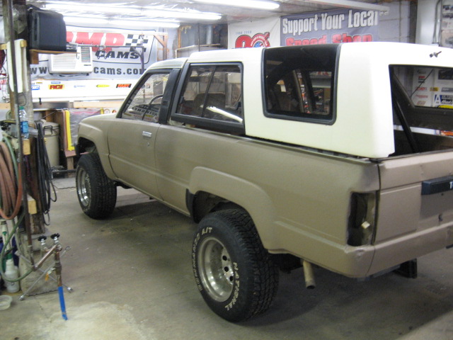

Been lookin for a while now for a First Gen Solid Axle & here is what I found.
For $1000 I got a Bad Mtr SR5 that needed some Love ....This is Gonna be my Huntin/Fishin/Creepin thru the Bushes Ride . I will do all the work myself except for the Mtr Build,I have a Former Toyota MNGR over the Repair shop to do a full Engine Rebuild [pull ,Rebuild & Reinstall] for $1450.
I have $650 in ...Bedliner I Sprayed on sides,New ,Clutch Kit,Plugs,Wires,O2,Dist Cap, Rotor,Coil,Tail Lt Lenses,Marker Lts, & a Windshield.

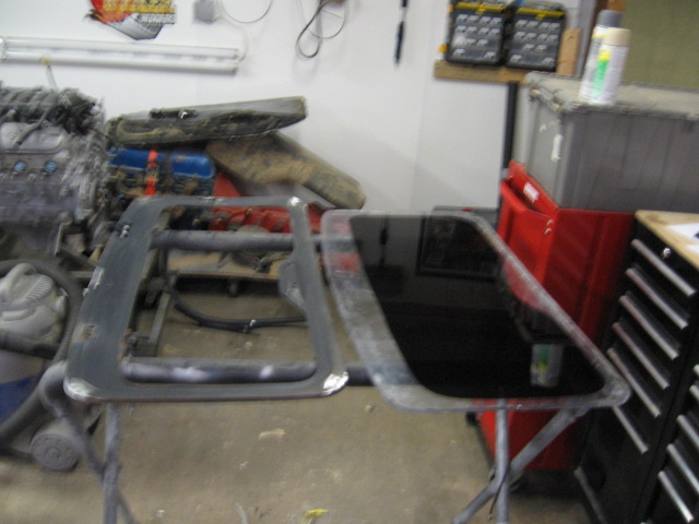

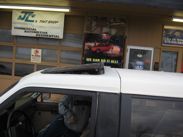

Sunroof was busted up BAD with a Piece of Lexan Self Tapping csrews Holding in & Leaking.I cut the lexan Dwn & used it back in the Frame.
HOPE U LIKE IT !

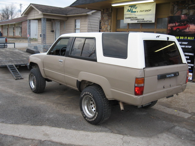

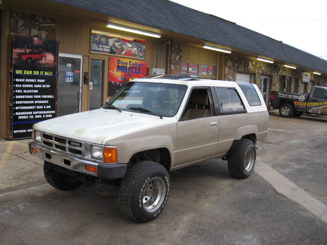

I got the Windshield set & the Lexan Sunroof in ....it works! I will post up some Pics tonight .
She will be dropped off for the Mtr Rebuild Tomorrow. It's almost like Christmas ....Funny ....to be Excited over my Lil Turd !

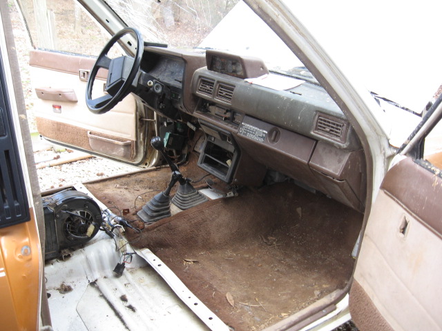

Finally got the mtr tore dwn....3 Spun Rod Bearings,1 Bad Rod & the Crank is Junk.Let's move on....The Lexan Modified Sunroof is Workin ! & so is everything but my Brake Lts & Turn Signals ? Any Ideas Guys ?
Can't Wait to drive her & make sure the Running Gear is OK ! As it sits I will have $3k in it with all the fresh Parts I listed & a Fresh Mtr ,What do ya Think?
