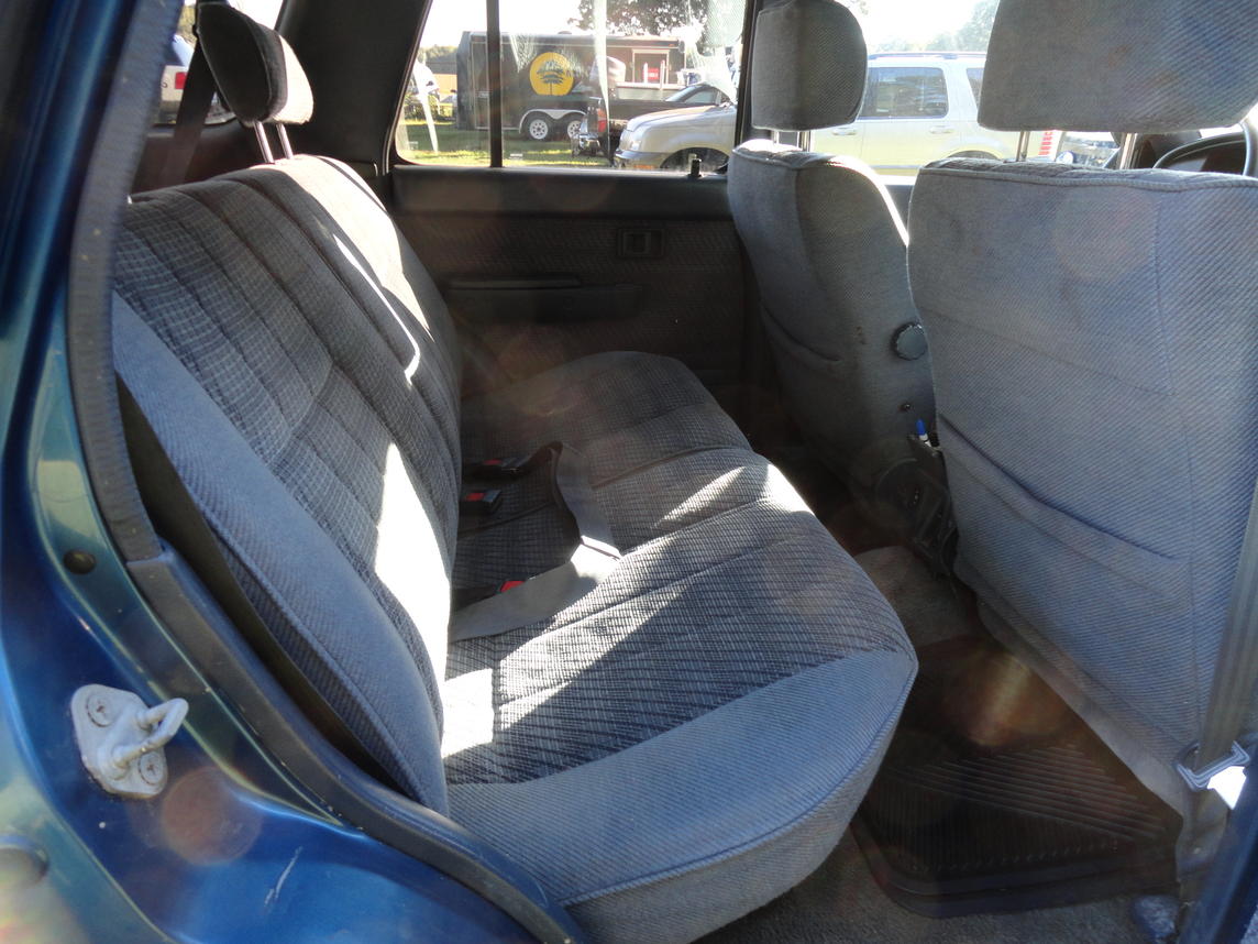

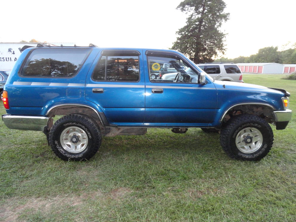

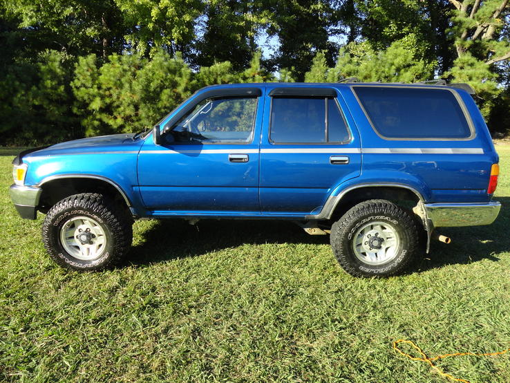

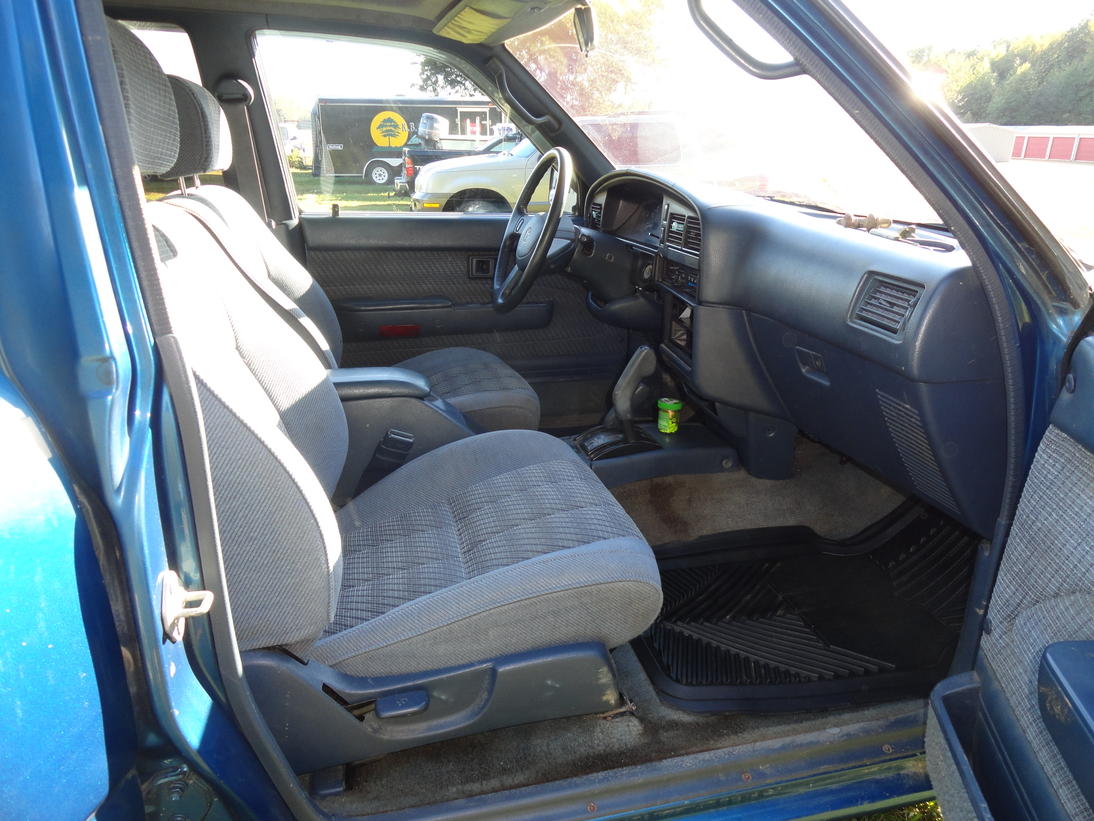

On my 3rd day & it's cleaning up pretty good. I actually started it today ( just for a minute-blown head gasket ) i drained the chocolate milk yesterday and flushed some oil through, topped off with new oil, pulled the plugs @ hit each cyl. w/ MMO. Returned the plugs and got some oil cycling through the motor. I found a used, running 3.0 for $300 local but i gotta help pull it which is np. Monday i'm taking it to a mechanic that's going to do a dye test to tell me if the existing engine is worth repairing. Getting excited seeing it cleaned up a little.
