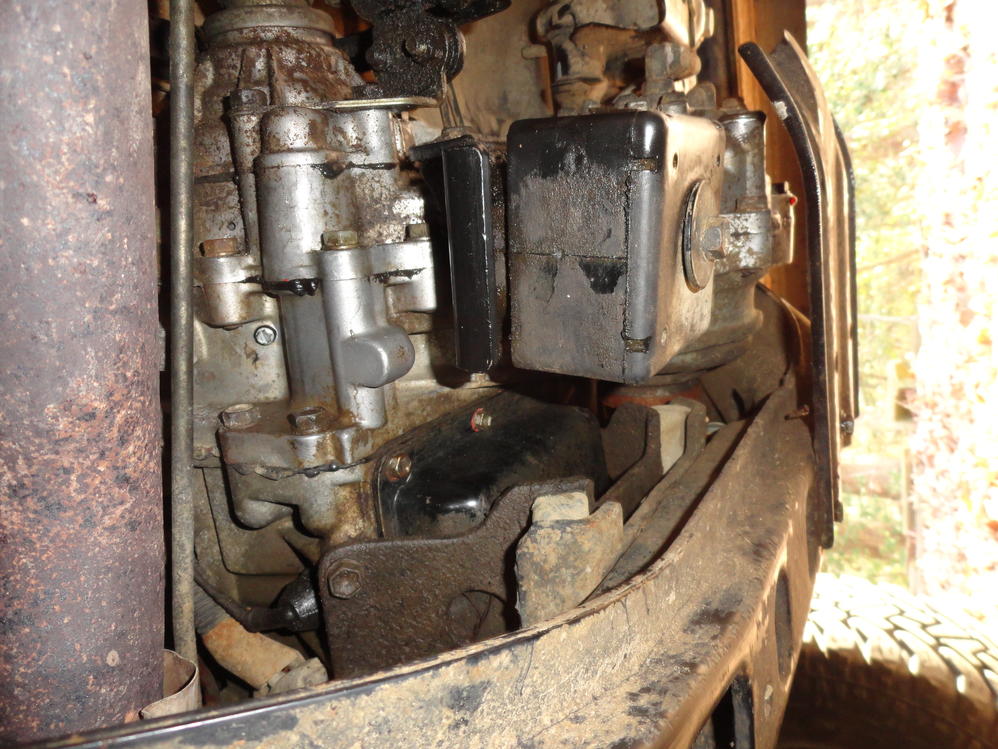

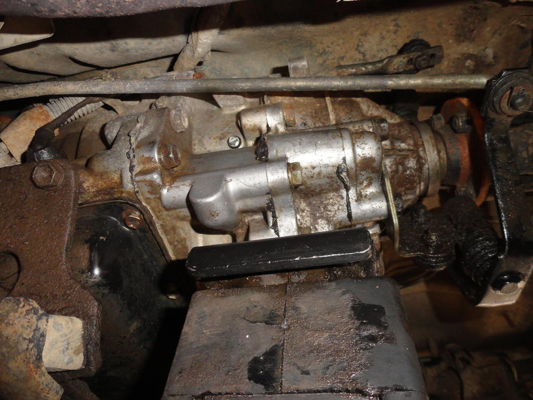

Led, yes, although in the end, it was only the pigtail not meeting up as it should have in the wiring connection. While trying to do good by my g/f, as it will inevitability be her T4R, i got a new one from rock auto.
So, i got an inspection sticker on it today, all front brakes brand new, pass. side idler arm swapped from the wrecked T4R, like new. I saw a puddle in the inspection bay under the transfer case ( transmission mount area ) and dipped my finger in it to smell and it was gear oil. I drove it back into my friend's shop and examined it, the only thing we could see was a small weep hole on the driver's side of the transfer case, everything seemed to be clean underneath the weep hole....and the trans. mount was drenched in gear oil, as was the gas tank shroud, the muffler and cat ( smokin ).
The transfer case oil was still full. The motor oil was still full. My friend ran a small screw w/ silicone on it into the weep hole, and i parked it till tomorrow. No idea what's causing it....hoping to find some info tonight online.

That's an Auto V6 right? There shouldn't be gear oil in the transfer case. I just went through this with mine as my trans is out of a 2nd gen and the transfer case should only have ATF fluid in it. I guess being that it's pumped through a cooler then it needs to be thinner. If its gear oil on the floor make sure its not coming from your diff and running down. If someone has put gear oil in the chain case I'd change it out with ATF. That wont fix your leak though, still will have to find where that's coming from.
Got the new pads on, swapped an idler arm from the wrecked runner ( like new ). I watched a puddle form while it was being inspected, ( single bay shop ) i smeared my finger in it and it smells like gear oil. Drove it back and went under it, muffler, cat, gas tank cage, all covered in gear oil. I'll probably attempt to replace the transfer case rear output seal tomorrow, after watching a video on it. Truck running solid, rides great, quiet for the big tires on it, just gotta pan this fluid leak down.
I thought the transfer case was supposed to have gear oil ? Yes it's an auto trans.
I'll post more as i find out wassup !!
Edit: i'll drain the gear oil and replace w/ atf, the 4runner came with 3 or 4 jugs of it hmmmm.....drive it around and check it again for leaks, before i go replacing anything.

I managed to get all the gear oil out of the transfer case, topped it off w/ ATF/DEX. Drove it up the road & peaked underneath, all good, came back, put it in 4wd and peaked under again in friend's garage, still good.
Yesterday all the evidence was showing the leak coming from a small weep hole on the driver's side. My friend put some atv sealant on a small screw and closed the weep hole up, he said there's still a vent up top, anyway, it's not leaking anymore, i hope it stays that way.
Drove it today to test for leaks, i saw one drop of atf before i took off, there seems to be a small area of the seam in the transfer case that doesn't have much silicone. Other than that, it did fine. I felt some air seeping thru the back of the sunroof, i opened it and closed it and found you have to push up just a tad on the back at the very end of shutting. Closed right up.
2 pics of the screw in the weep hole, and a pic of her new steering wheel cover !! :bluejump:
