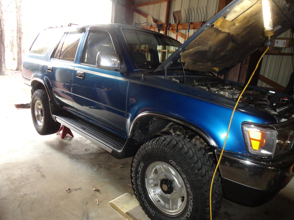

Running boards & the new ( to me ) engine

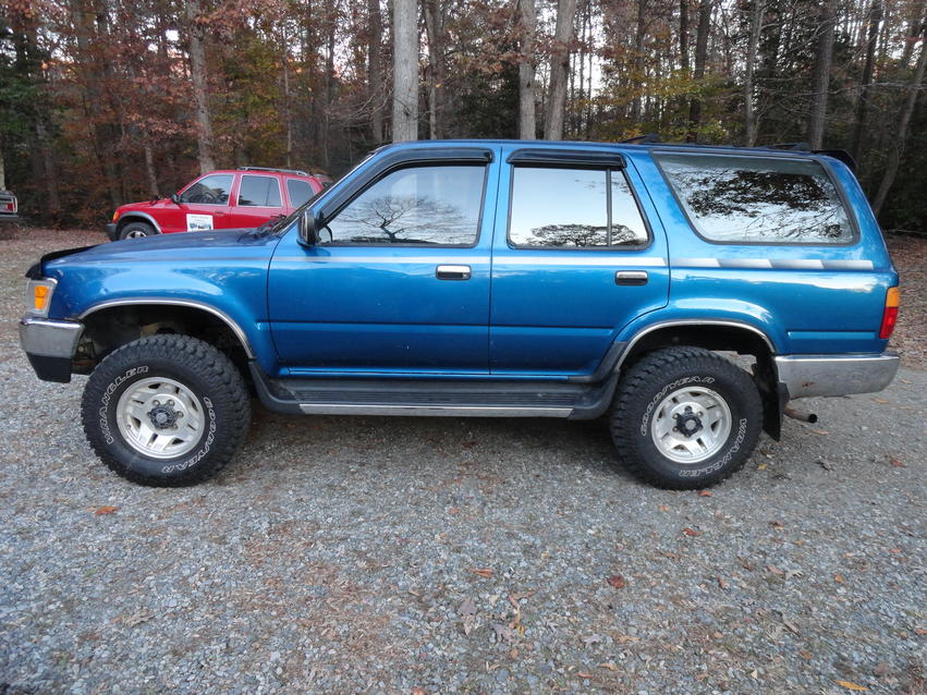

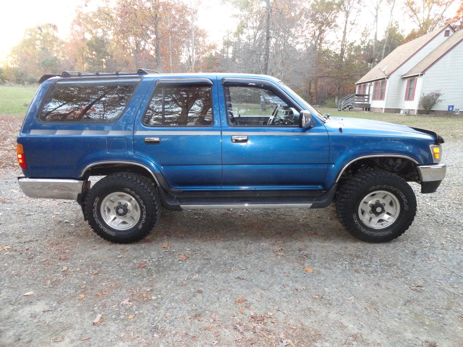

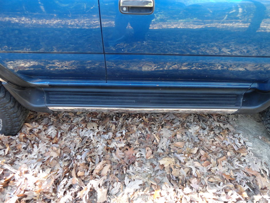

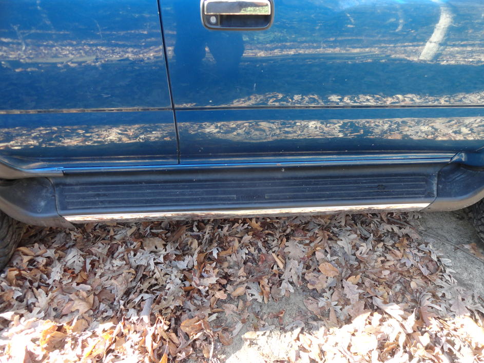

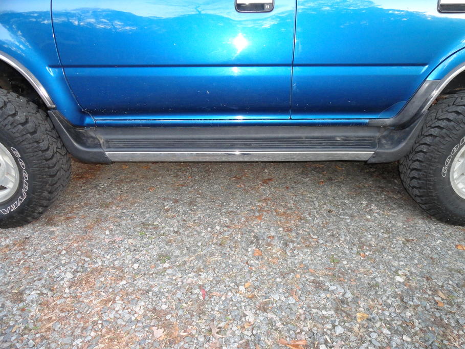

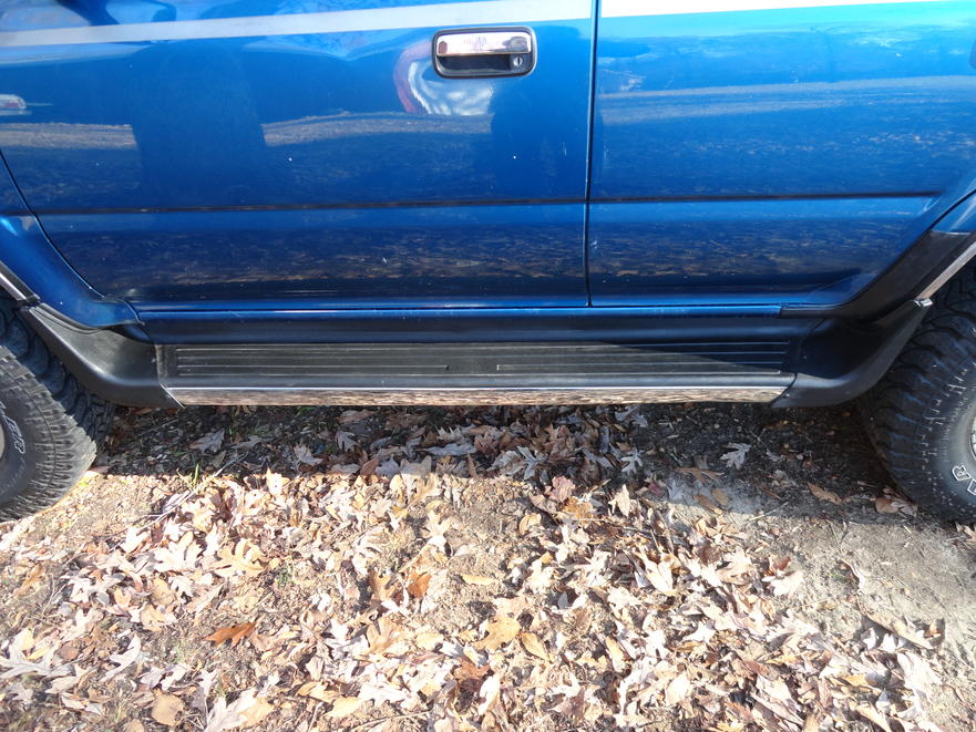

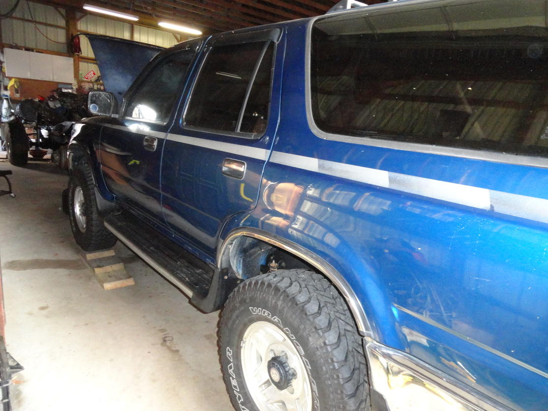

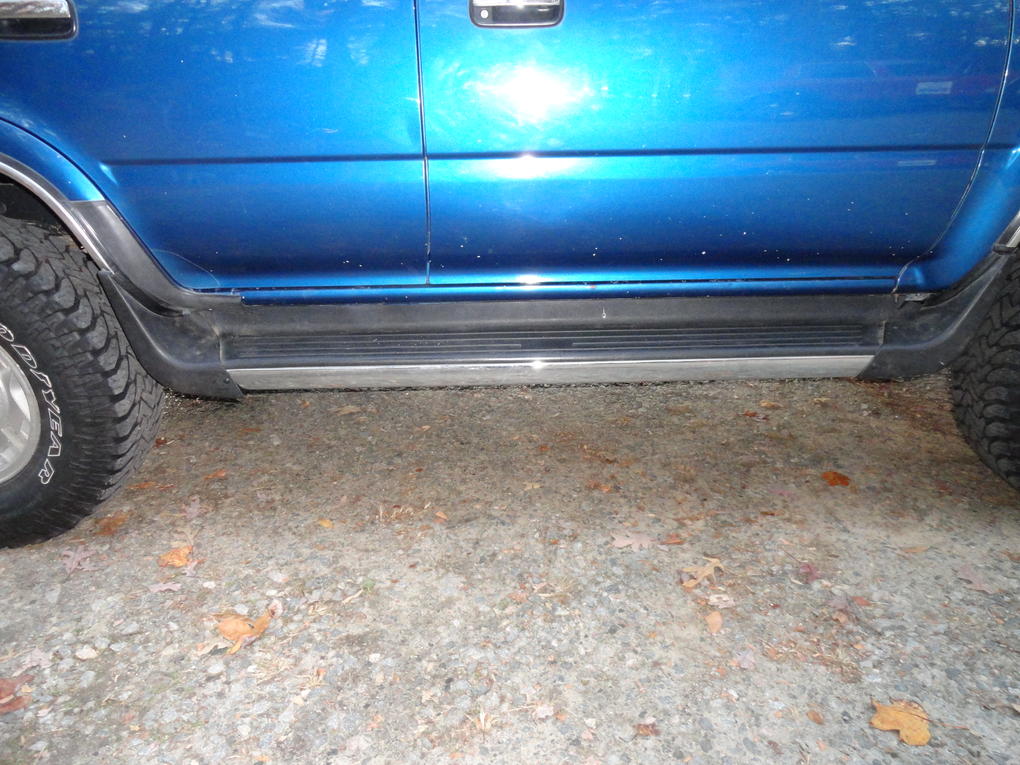

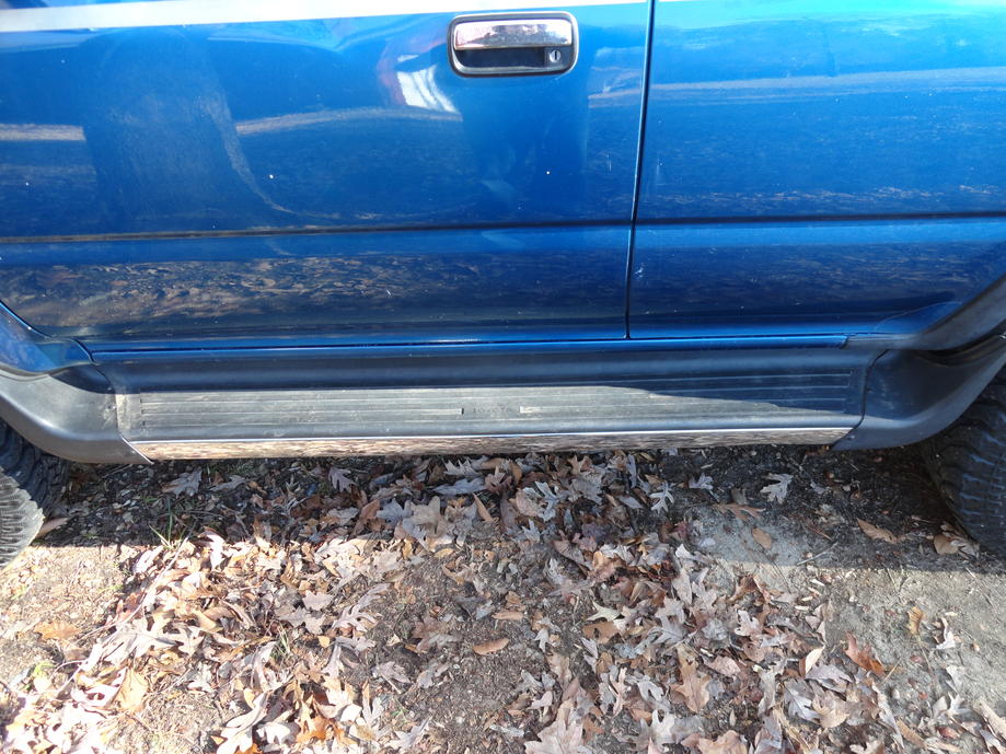

Got the running boards on today w/ the end caps after some finagling on how to attach the outside lip to the running boards, i ended using black trim screws to secure the plastic in place.
The bolt pattern didn't line up on the wheel well, nor did it line up on the mounting brackets, but no biggy, i knew the boards were from a different year and figured i'd make it work.
Checked the brakes/drums/rotors today, needs pads and front wheel bearings had a little play.....anyone know if the bearings are adjustable on the front?
Anyway, here's the progress so far....
Oh and noone had a quiet muffler in stock, going to look online tonight, was told to check out rockauto too. I just want an inexpensive muffler to quiet it down. I'm really liking the way she's shaping up !!

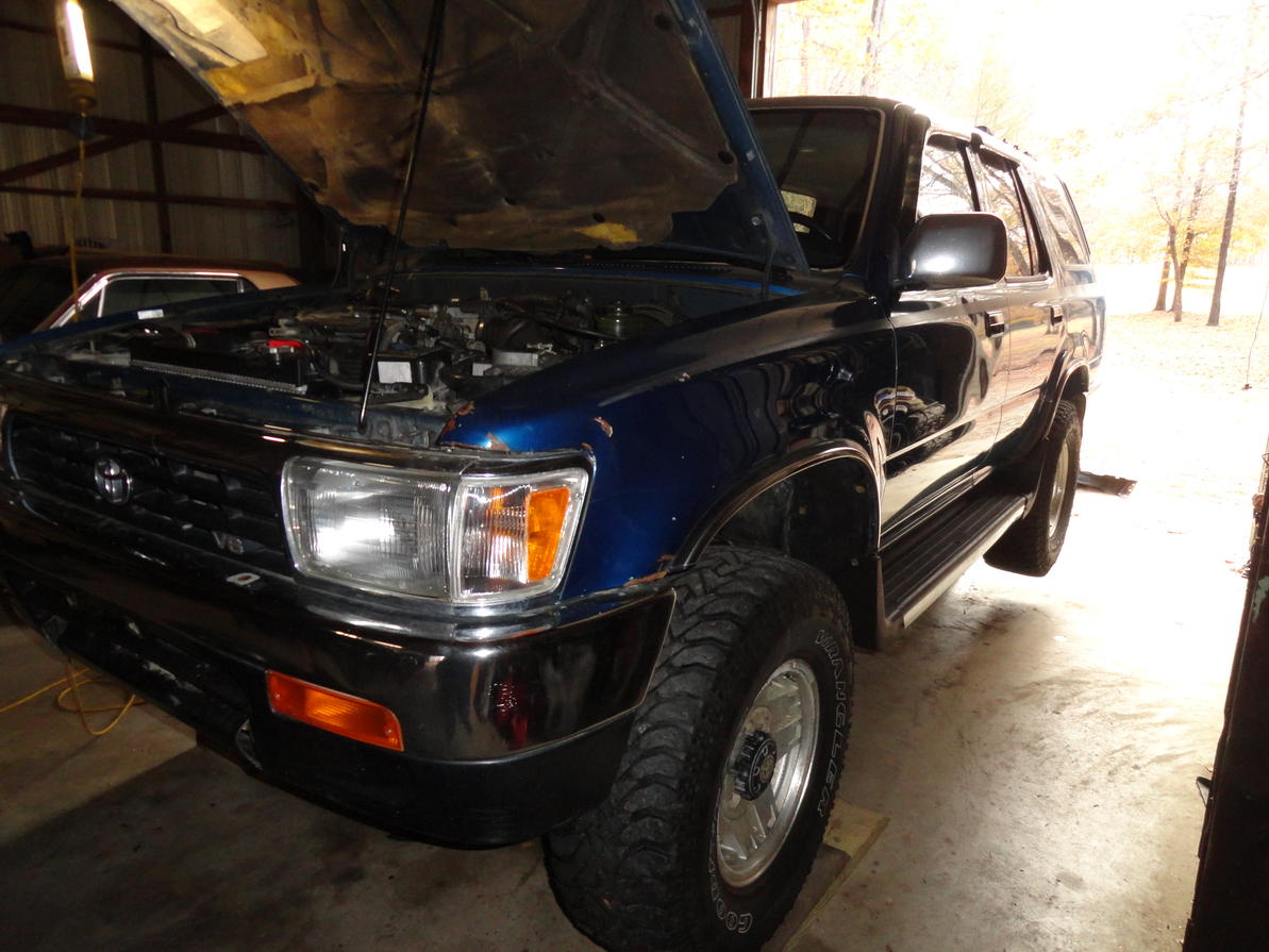

Today, replaced a fuel filter i replaced yesterday. Tweaked it to the hilt and just couldn't get it to stop showing liquid on the threads...not as much as a drip, but still the threads were wet. Replaced that today & had a mechanic friend help, he took his time working both sides back and forth, and instead of manhandling the protective cage around it when he was done, i cut the top half of the cage off and bolted on the lower half and it held the filter snug, and dry.
We put the muffler on it, now it's purring and the only thing you can hear is the engine. My friend topped off the read end, diff. & transfer case while i cleaned the skid plate, we got the one back seat to flip down that has the plastic pull button missing. Swapped the throttle cable from the wrecked one, the current one was like stepping on a cinderblock.

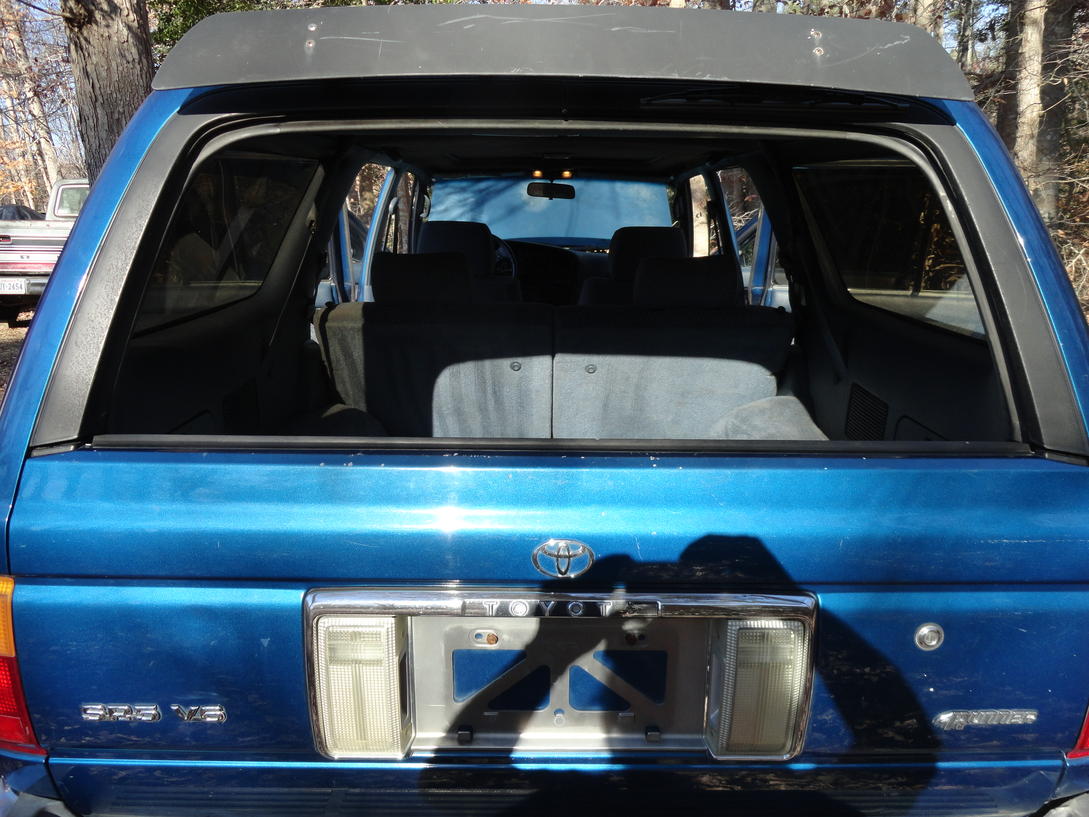

Today

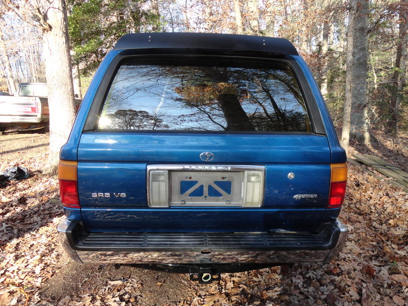

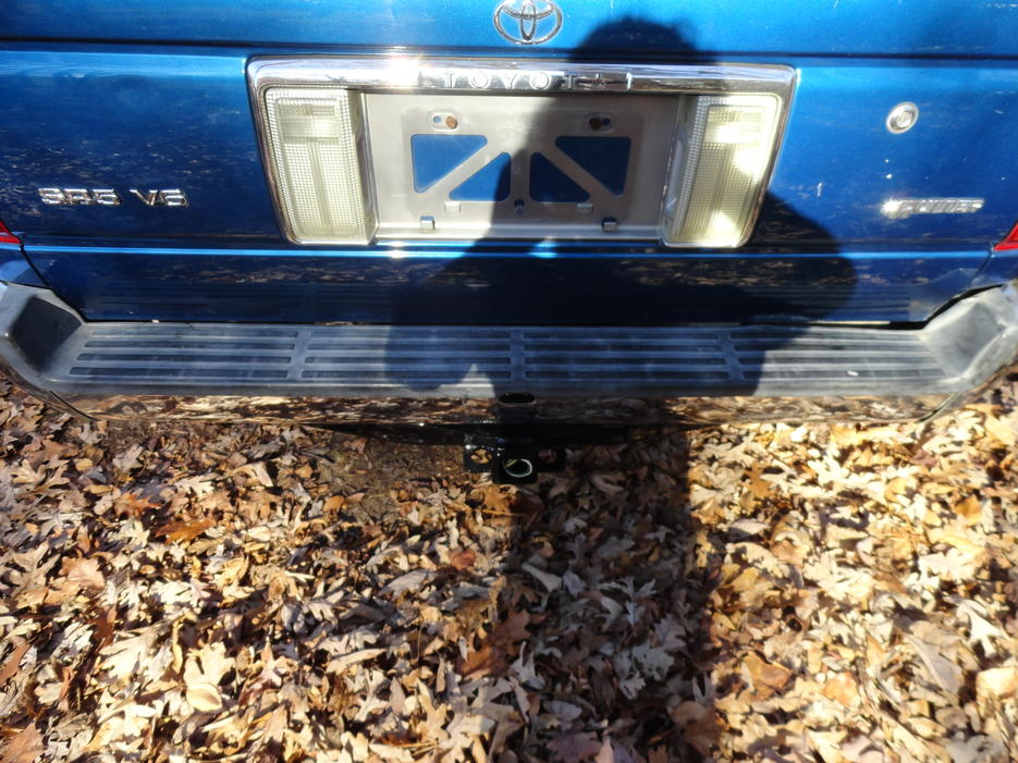

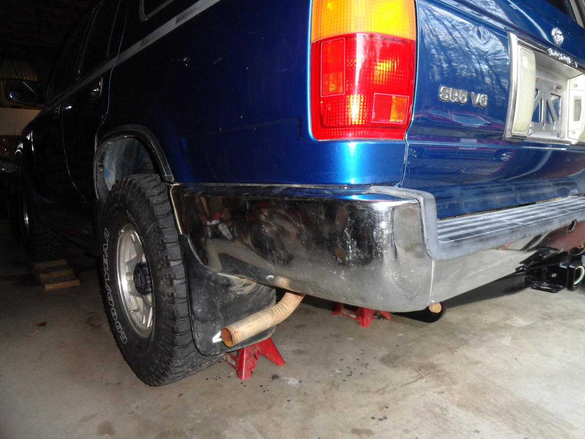

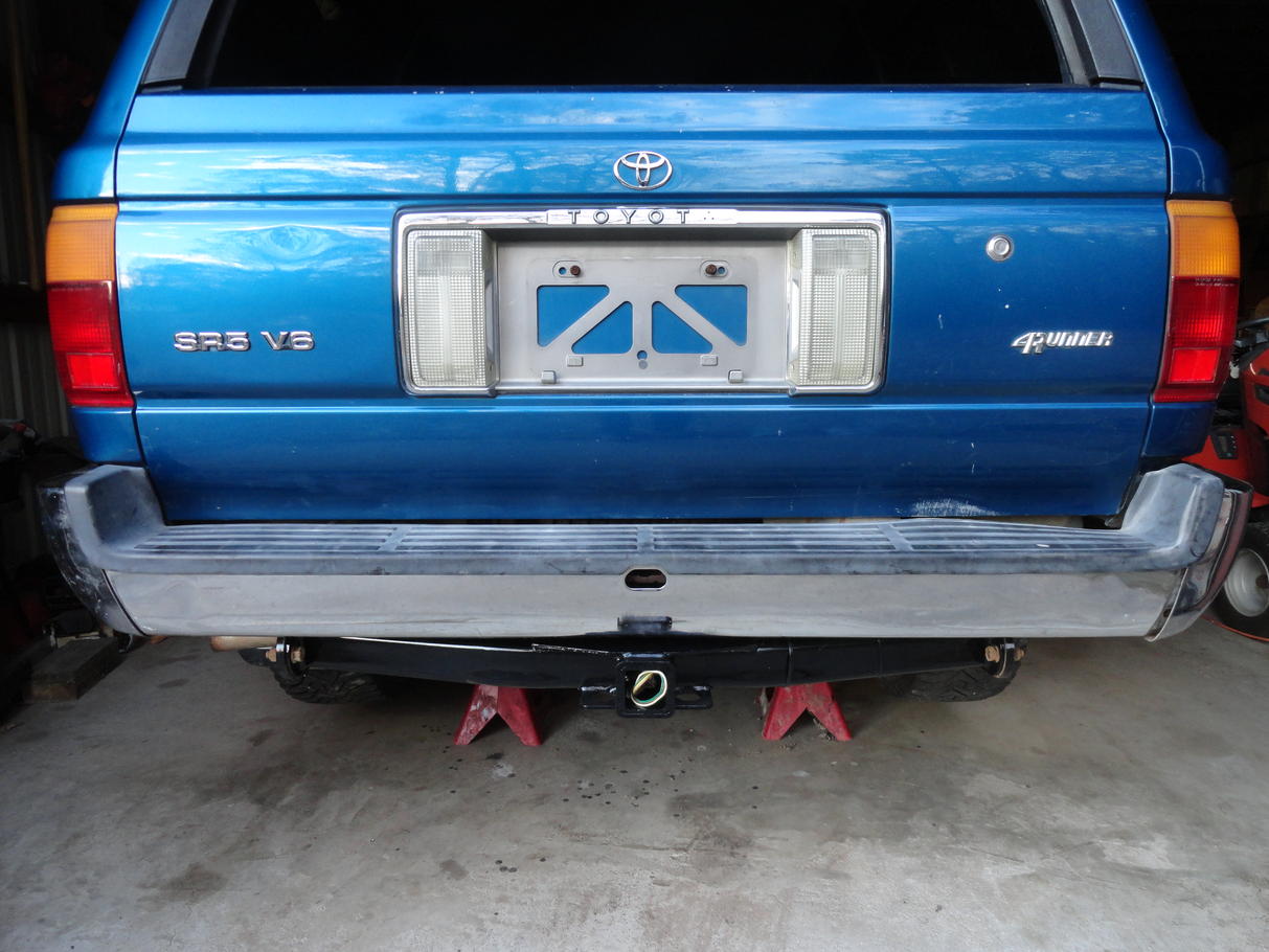

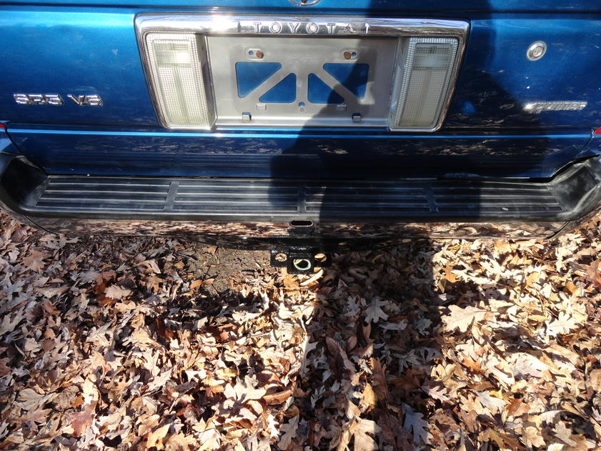

Today, the back bumper swap & one corner piece ( the one that had the rust ), the undercarriage greased, the hitch sanded, scraped & painted. Messed w/ the air shocks enough to see they need to go, wouldn't hold any air. Also got the spare tire carraige functioning and greased and hung the spare. My friend helping me ( Lenny ) beat most of the dents from the bumper pieces. The wrecked runner has what looks like a great set of rear shocks so, we'll see.
Tomorrow, front bumper replace and fresh paint on the bottom black section. Something came up on finances so the carpet will have to wait. Also, tomorrow i'll use 'back to black ' for the first time on the rear bumper rubber and the running boards, heard all good things about it.

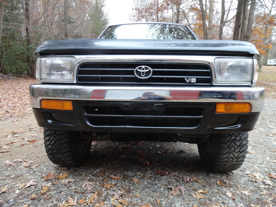

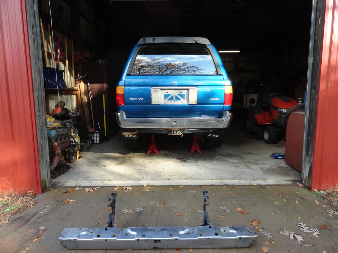

Today

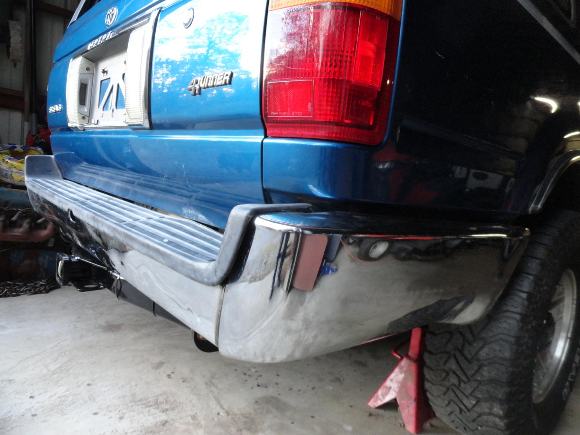

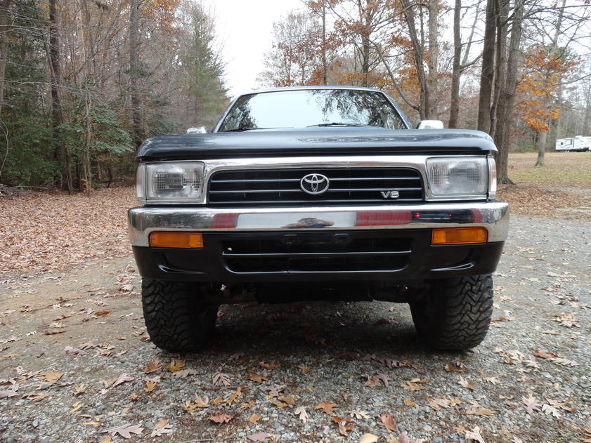

Swapped the front bumper out all together, also some fresh black paint. JB welded a mud flap mount hole and a crack on the rubber front part of the bumper. Forgot to bring the 'back to black'. Called it an early day. Happy Thanksgiving everyone !!

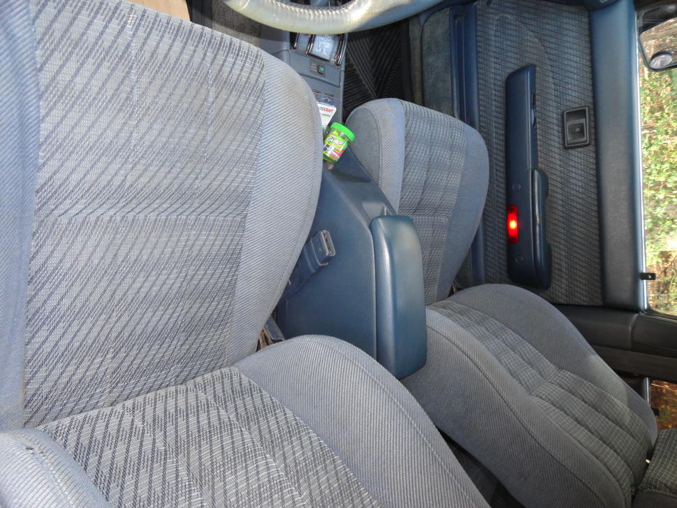

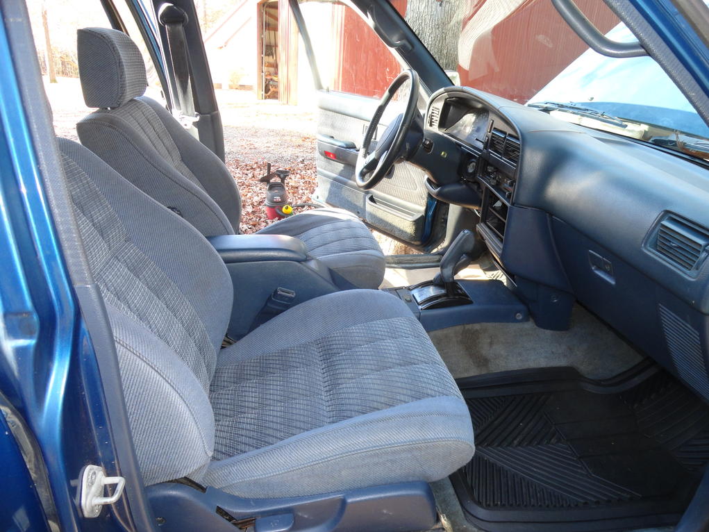

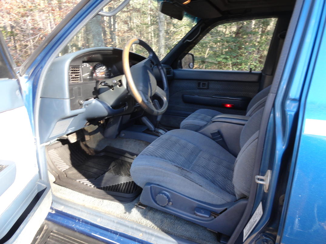

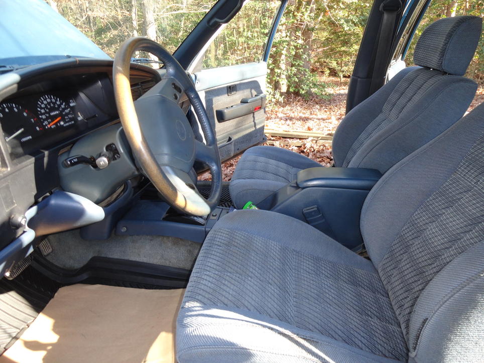

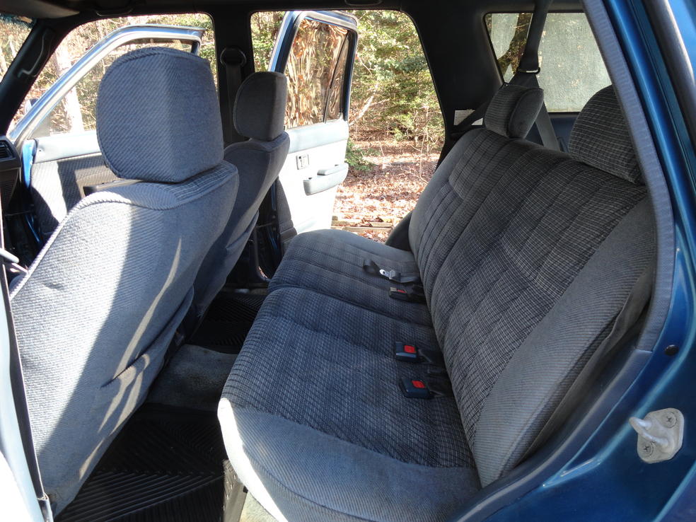

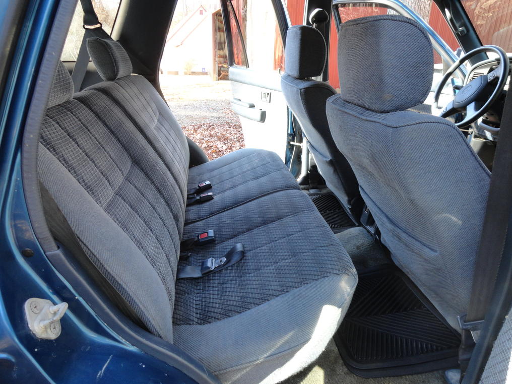

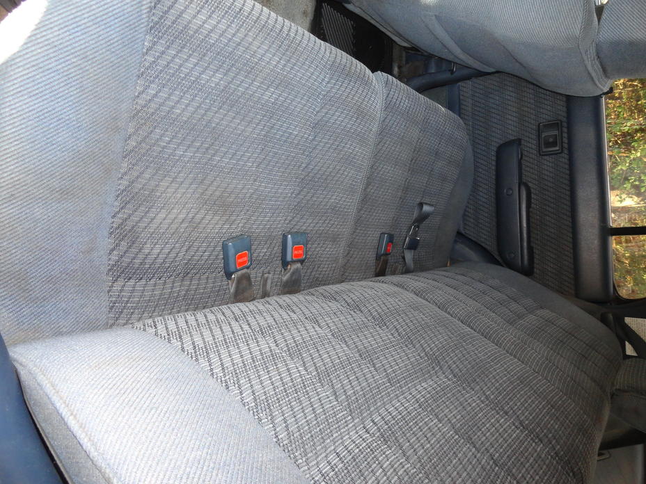

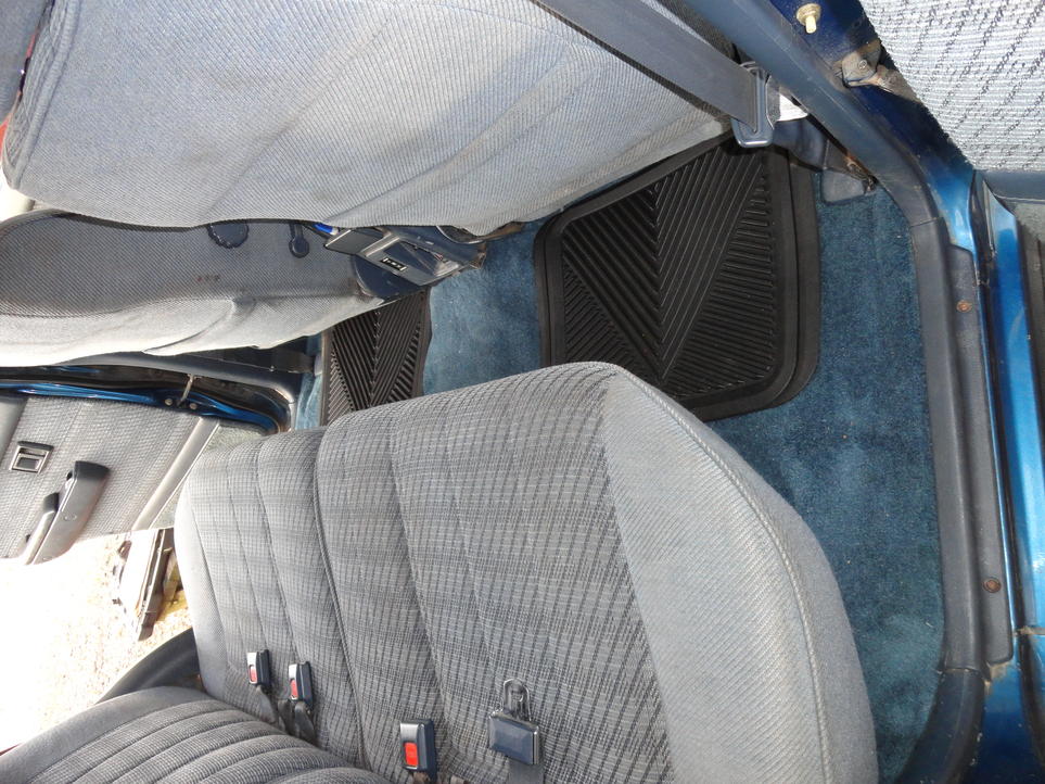

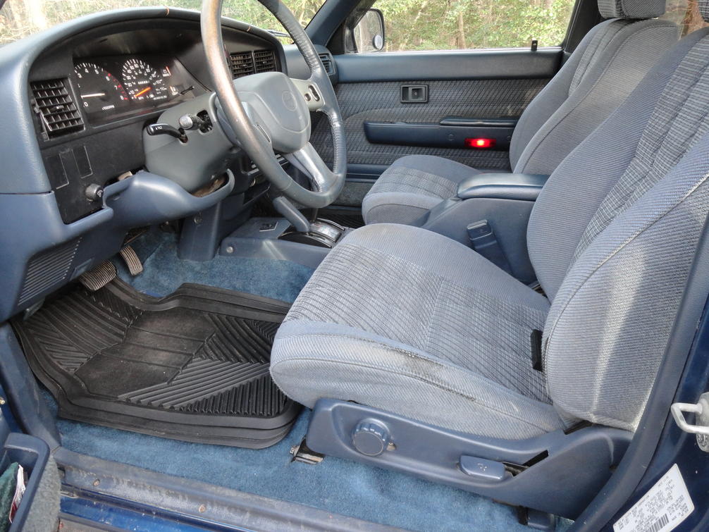

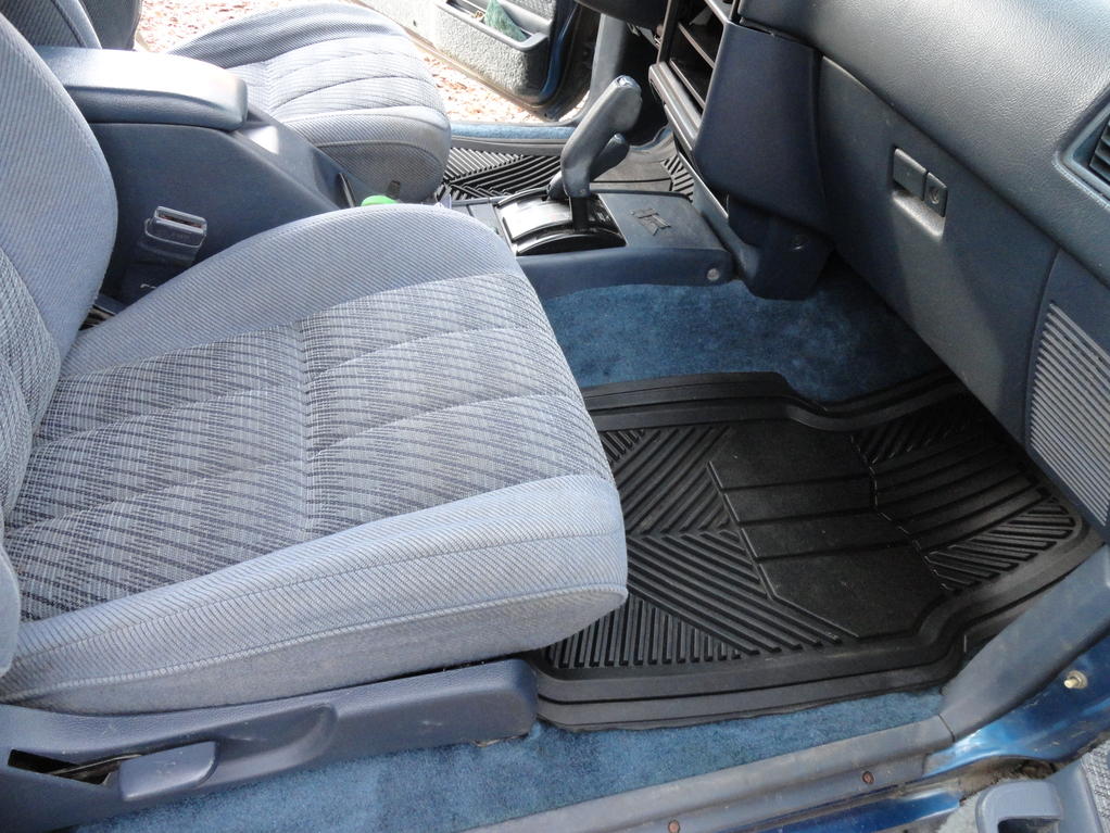

Some cleaning today, nothing fancy, figured out how to fold the back seat bottoms down. Cleaned the upholstery again, the door panels & cargo area carpet as well. Applied some 'back to black' on the running boards and the rear bumper rubber, also hit all the chrome with 'neverdull'. Lastly, spray painted the rear 'spoiler'? whatever that flare is that hides the rear wiper. Also cleaned the inside of the door jambs & weatherstripping.

Also took a small wire brush to hit the cold start injector thoroughly. I read up lastnight about loose T4R gear shifts ( automatic ) so i delved into that some and indeed, it seems as if the bushings are shot. I like the way the back in black made the running boards look, i think i'll end up buying a can of black duplicolor for fabric/plastic and painting that rear bumper rubber piece, it's seen some days.
You can barely tell this used to be a hunting truck. :loco:

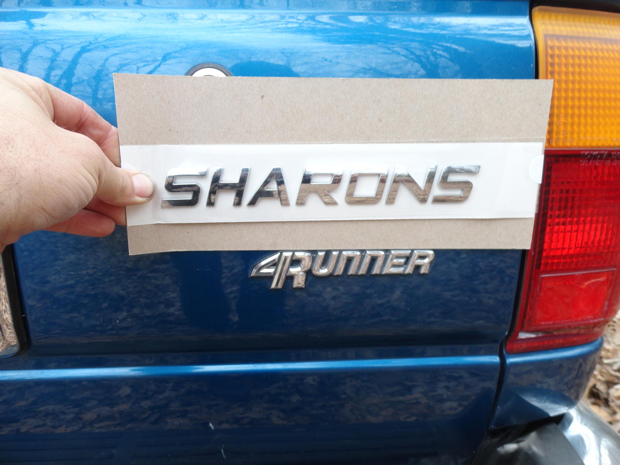

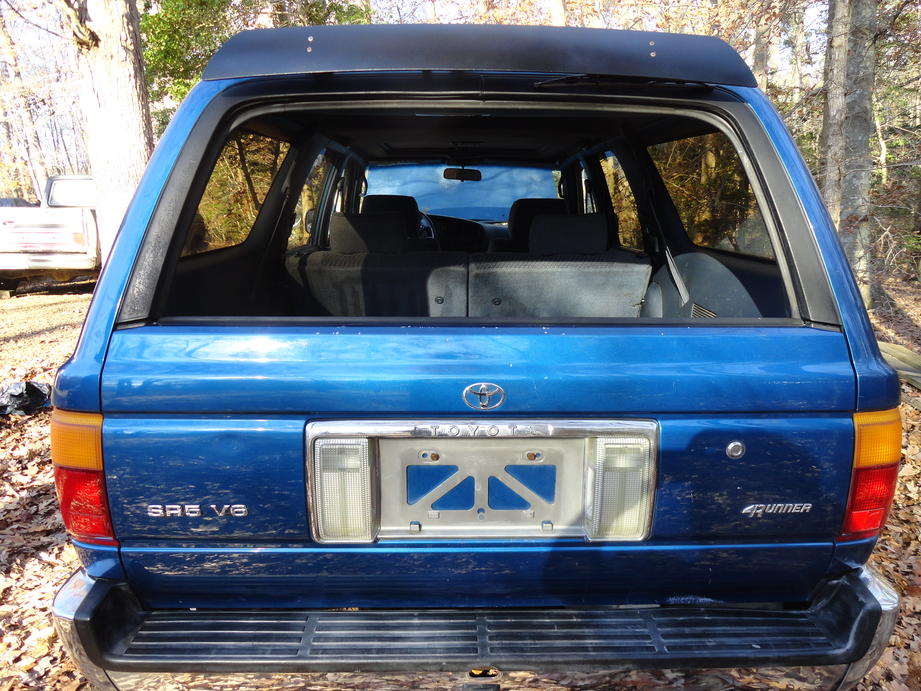

The lack of funds has brought things to a brief stand still, i pieced together 2 windshield washer fluid containers and jb welded the pump relays into the rubber boots and they'll be ready for install tomorrow. Drove it up and down a gravel road alot last week, cleaned the MAF & the TB, checked resistance on about every piece of the cold start system. I got the 2 free emblems i ordered ( thanks to the thread here @ T4R )
Here's hers
I may try to carve an apostrophe out of an old emblem i have laying around. The name emblem is really going to personalize her 4R, thanks so much for the heads up on that.

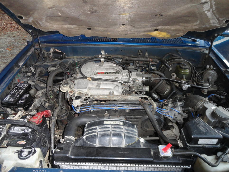

Seems like forever since the last post, in an effort to cure the hesitant cold start, i bought a cold start injector ( even though i had cleaned the old one ) and it didn't change much. TBH, it hasn't been very cold since i put it in. I did put tags & insurance on it, i plan to pack the front bearings and put the new pads on and get it inspected next week. Was just a little play on each front wheel when i checked the brakes prior, that should insure it passes the inspection. I ordered the front bay carpet today, i still plan to paint the hood, just $ has been trickling in slowly. I've been going over and starting it regularly, and driving it up and down the lane, rides very nice, everything on it works.
My fear is the check valve in the fuel pump is the 'initial start' problem. It runs like a dream after it's first hesitant start, no hesitations, no misses, very responsive. I'm HOPING that running it up and down the road after getting a sticker on it, and getting everything used to being ran again, will HOPEFULLY assist in the engine firing up normally again. Not that replacing a fuel pump is the worst case scenario, i was just hoping i'd be spared that expense & trouble.

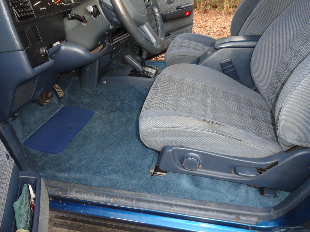

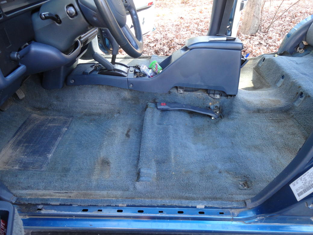

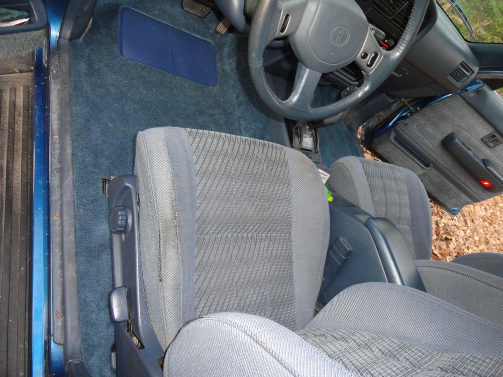

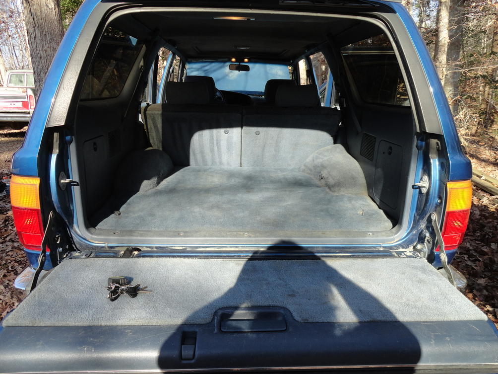

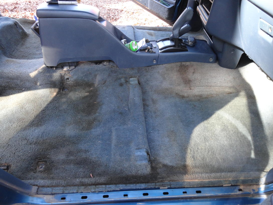

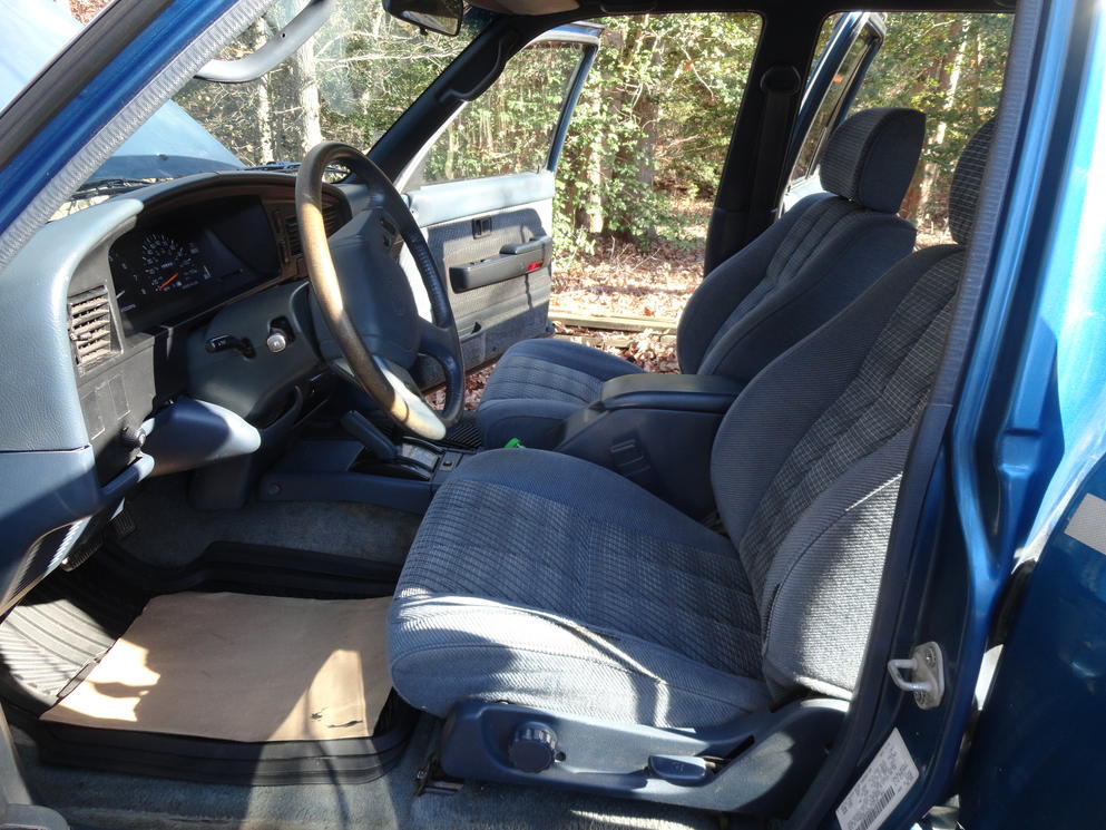

Carpet today

Much better

Thank you sir, i get my pre-made headliners and molded carpets from Stockinteriors.com, in case anyone needs a line on either. They also sell coverlay dash covers. I've about come to the end of my spending on this project, i feel pretty good about the condition i've got it in since day 1.

Oh and the cold start issue was the cold start injector pigtail( the truck's side ), the ends were pushed in too far and not touching. Starts right up now !! The mechanic that did the install, found it for me in minutes. Thank you thank you !!
