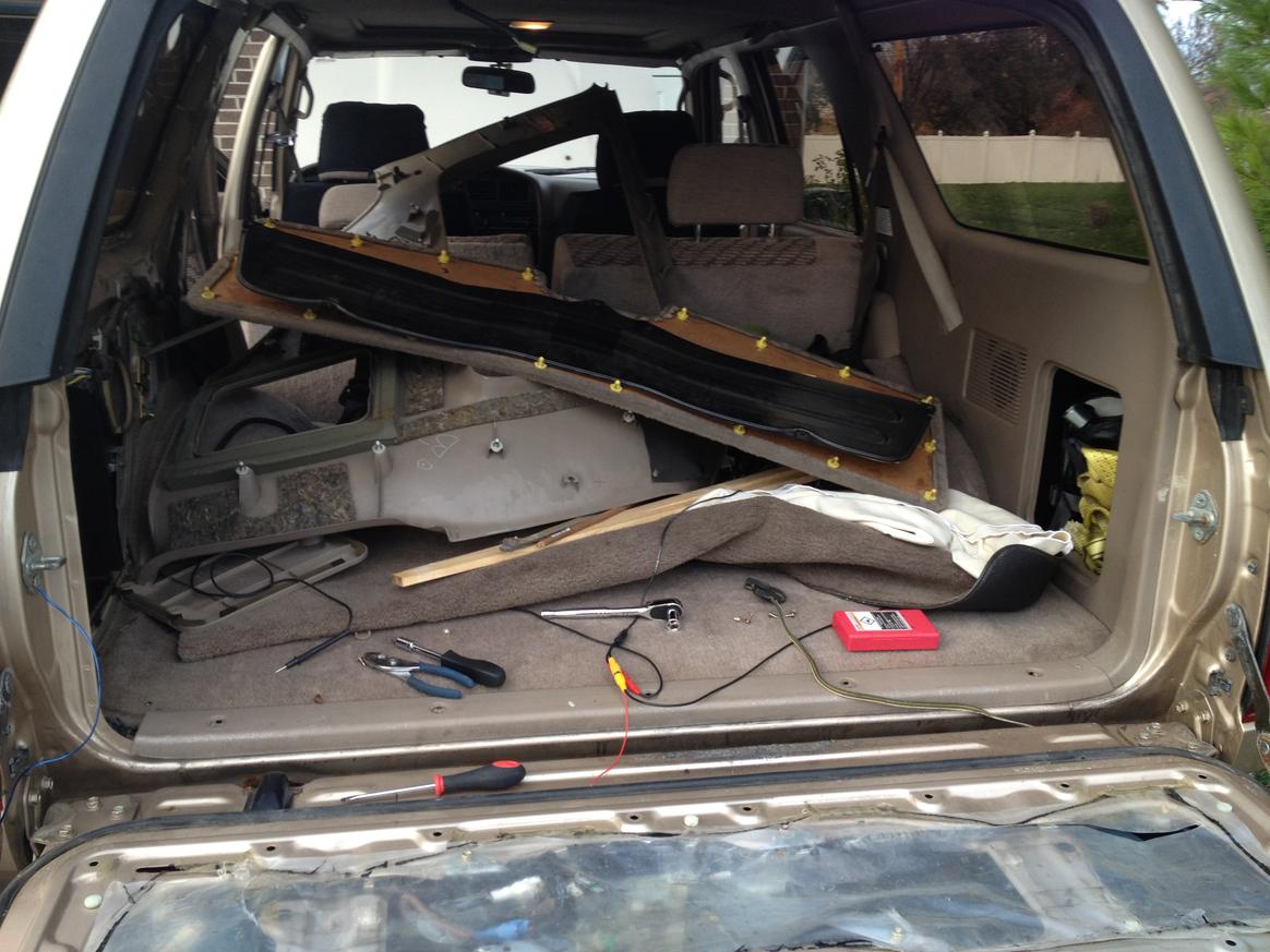

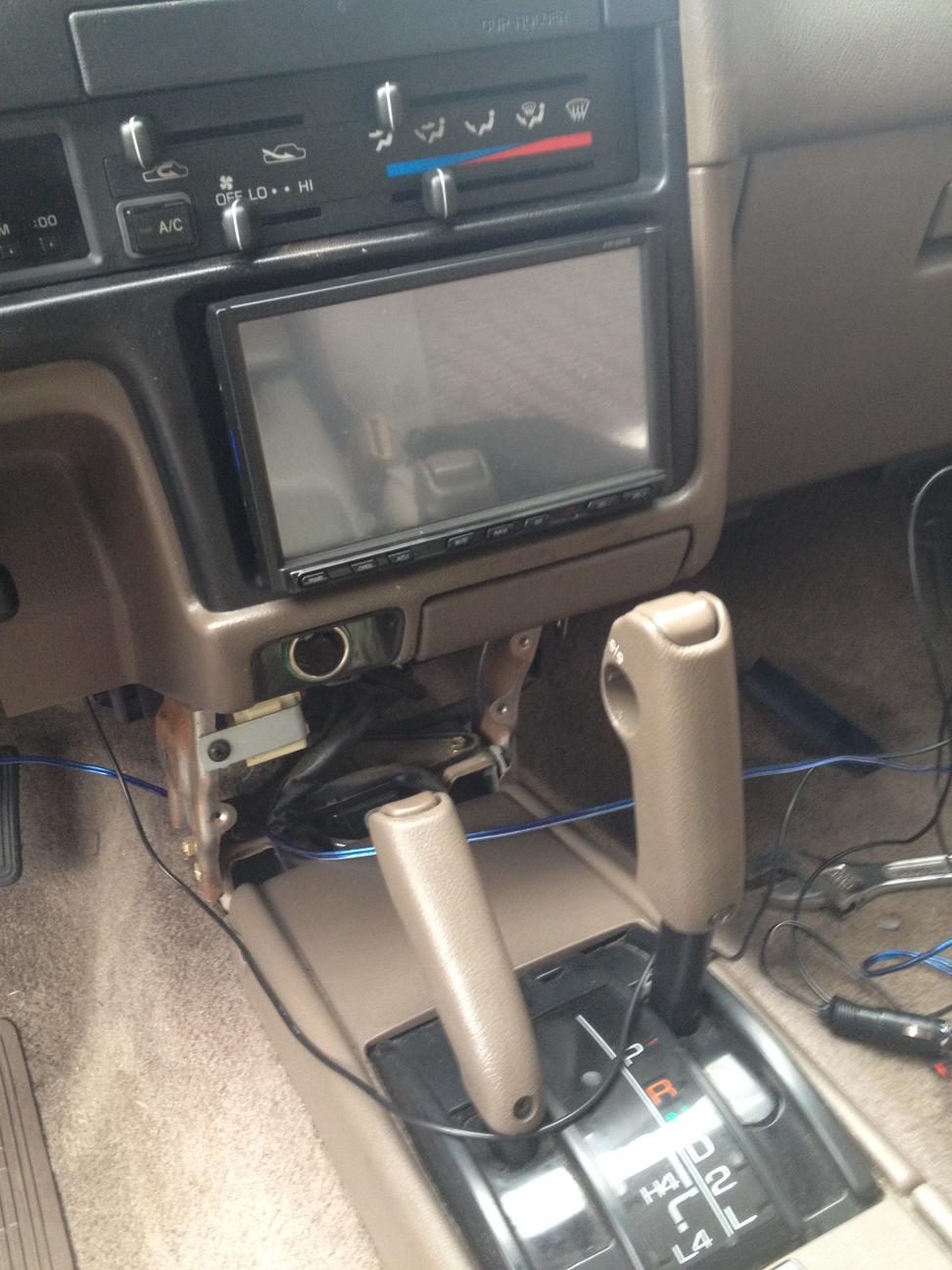

Anyway within the first week I changed the brakes and calipers (both sides were frozen) and put in a touch screen dvd player nav radio, new front speakers, window deflectors from junk yard, then installed backup cam for it a couple weeks later.
Also modded the shifter about 2" shorter so the radio could open and close in park.

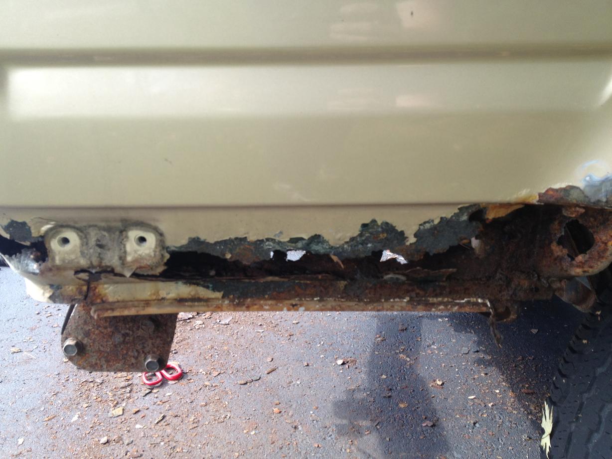

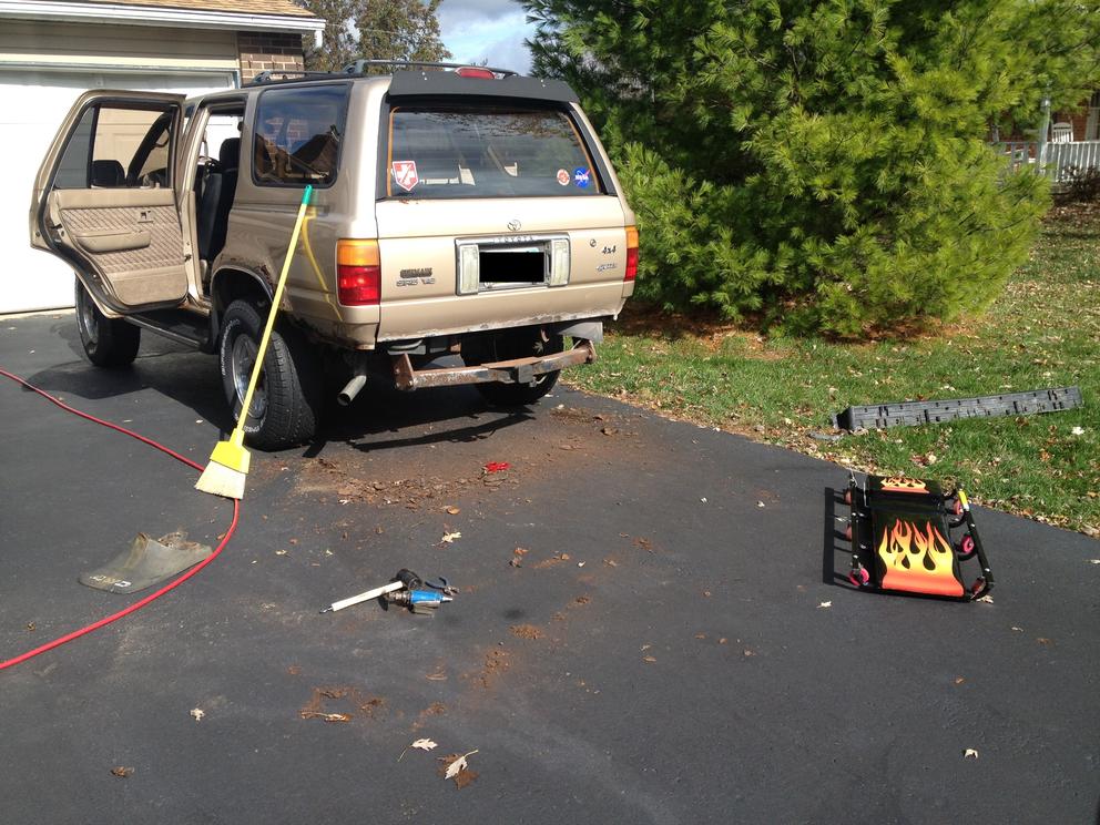

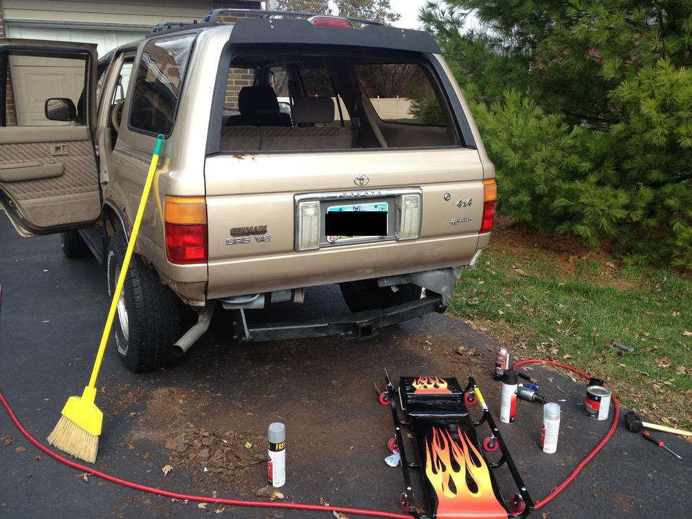

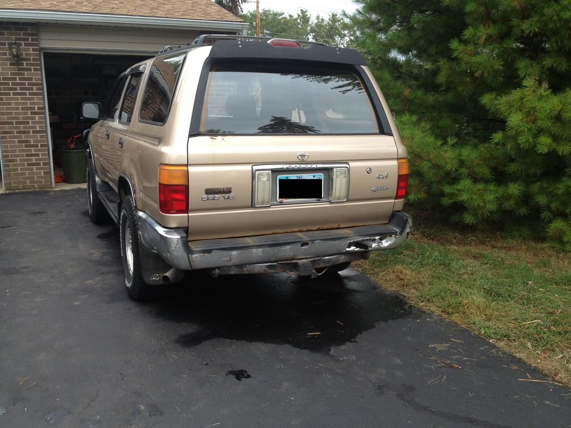

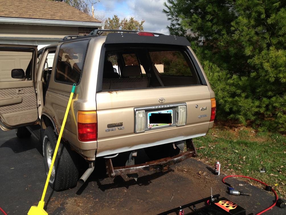

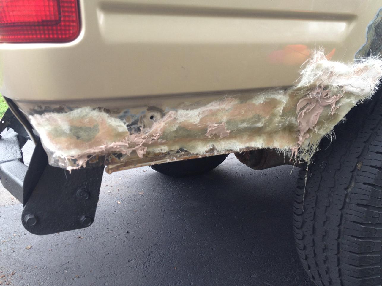

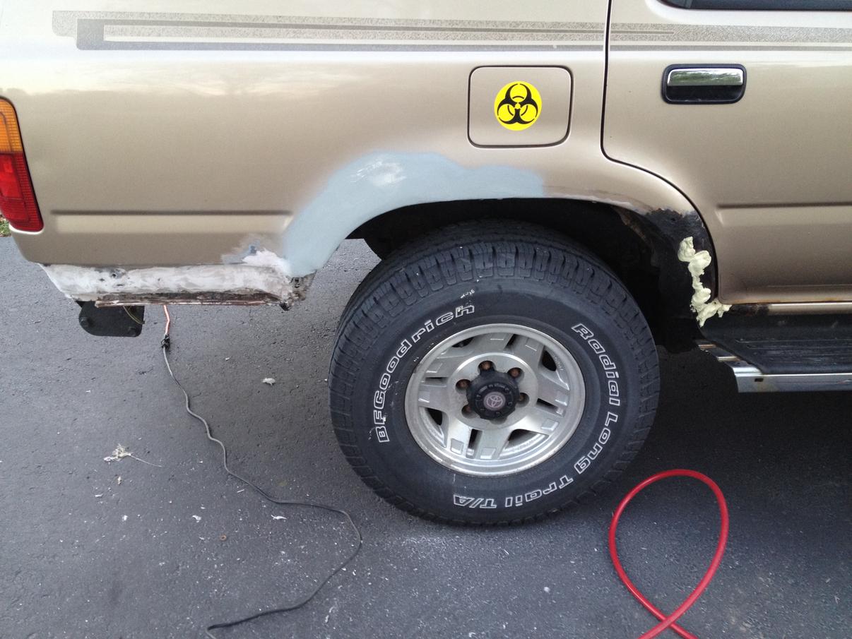

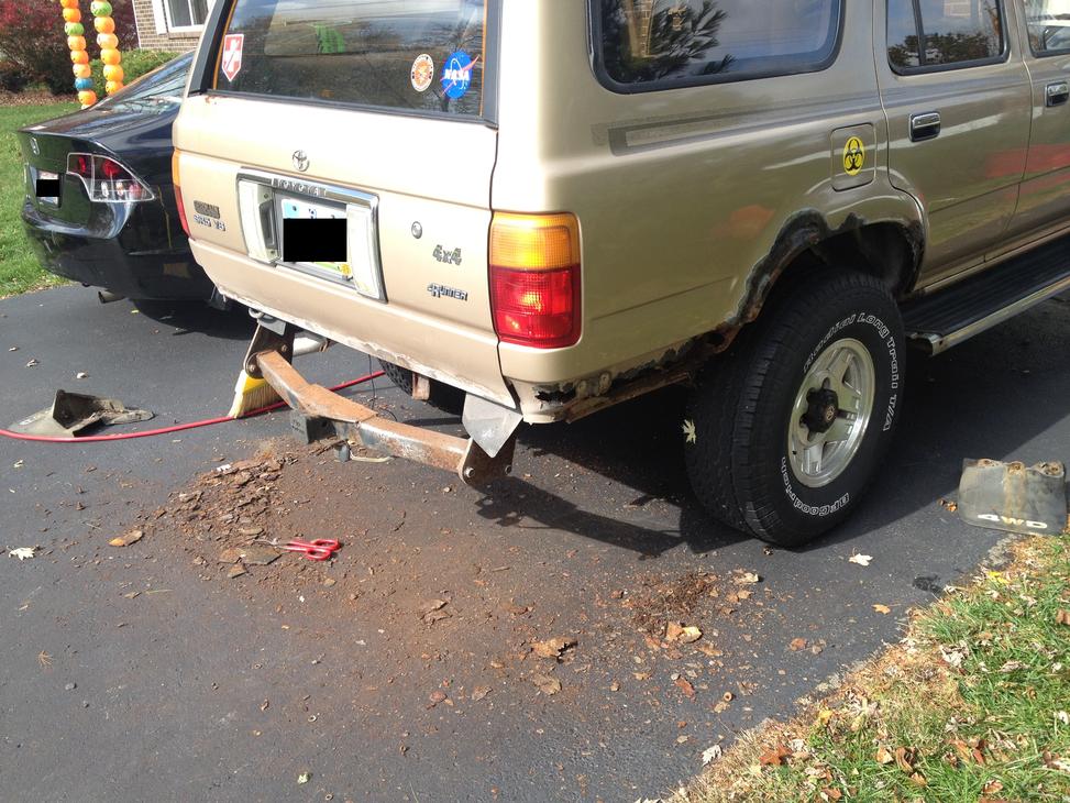

Anyways I had picked up some bumpers from my local junkyard and started removing some rust.
This was the first time I really tried to do any major rust work. Picked up a corded angle grinder from Harbor freight for really bad sections, and used air tools for the rest.
Of course after I made holes in the panels it rained for three days straight. Today I was able to get some work done and am happy with the result.

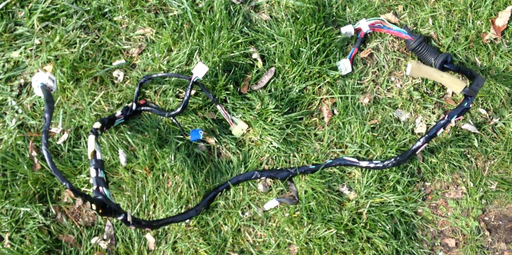

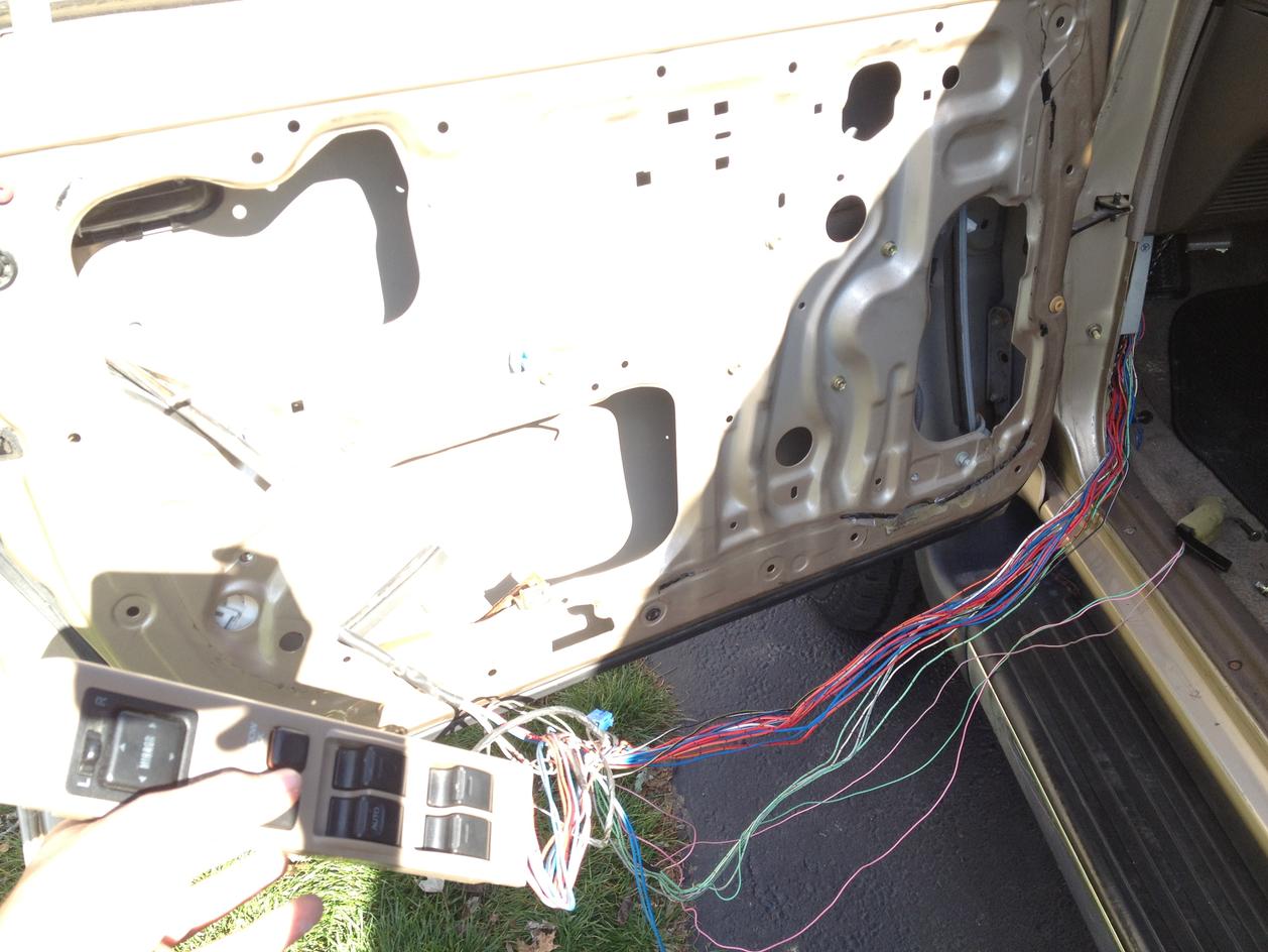

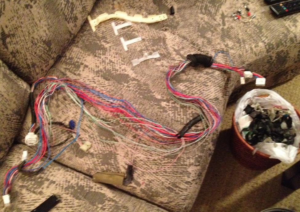

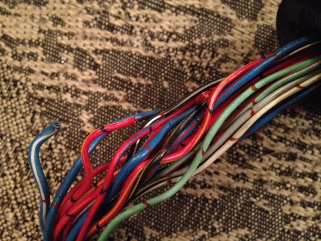

I tried changing the door lock actuator with one I got from my local junkyard today, to find out it didn't work, leading me to think that since it was only the drivers side not working, the wiring was bad. the sensor for lock unlock worked fine. I removed the wiring harness after much work, and found two broken wires. I didn't realized that the door wouldn't be able to close :ybrick: so I had to screw in the door latch for tonight. The only way to open the door is to crawl in from the passengers side and manually activate the latch. Hopefully tomorrow everything will get put back together

So I got the wiring harness re-installed today, Drivers side power lock now works! Still more rust work for tomorrow, hopefully get the bumpers on. not looking for a perfect repair, just getting the bulk of it done before snow hits. Here in ohio we do get lots of road salt :/
