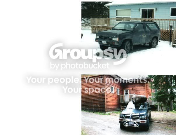

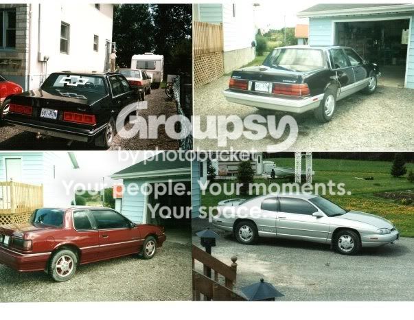

I personally, like the looks of a lifted 4Runner. I've always liked customized vehicles, as it adds personality to them. Whether I drove my 4 door 89 Chevrolet Celebrity, 87 Pontiac Grand-Am, 87 Pontiac 6000, 87 Nissan Pathfinder, 95 Chevy Monte Carlo, and now my 4Runner. I always went the custom route.
untitled-1.jpg~original
again.jpg~original
My opinion, if you're going to replace something on the truck, replace it with something upgraded!
