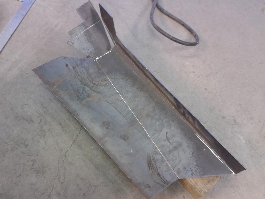

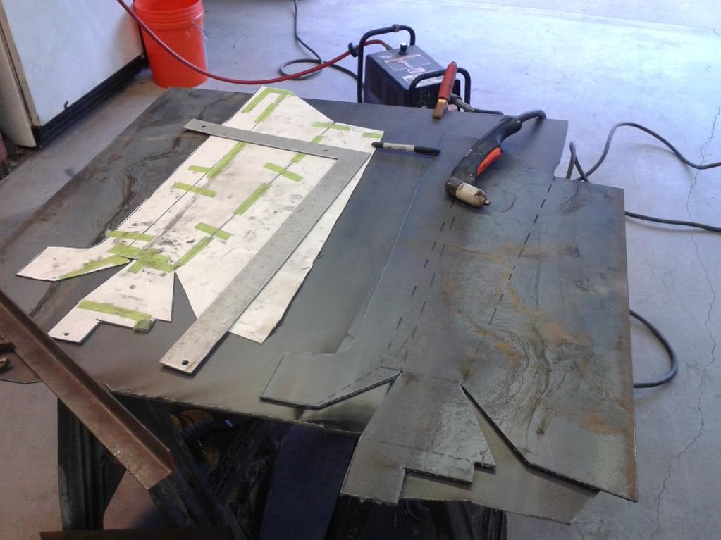

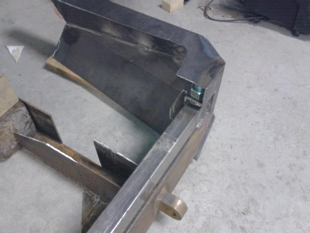

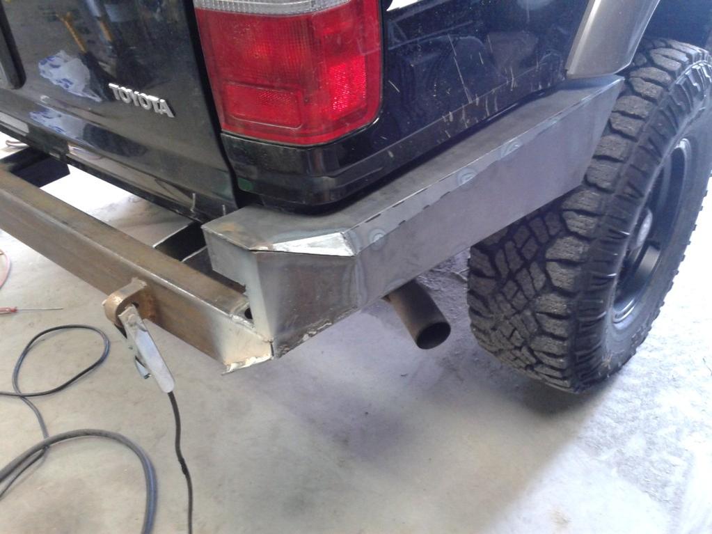

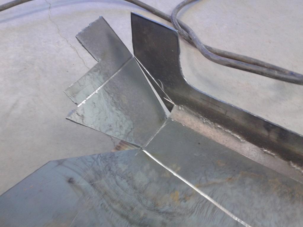

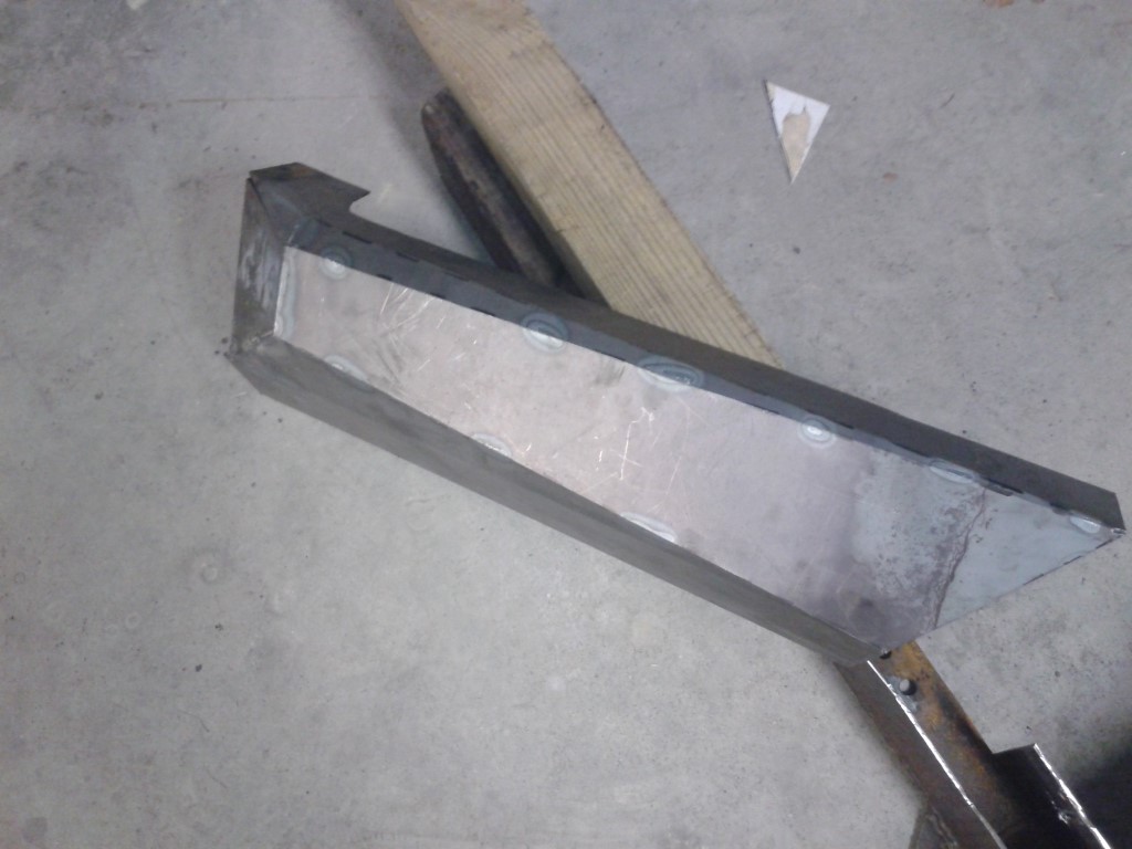

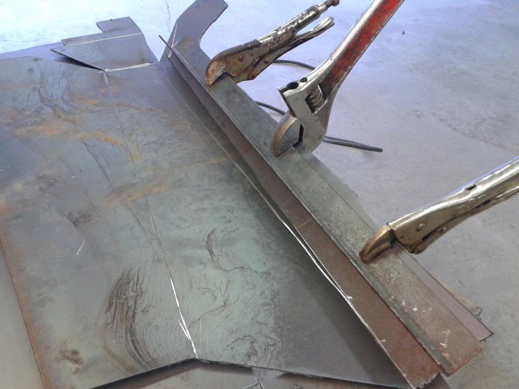

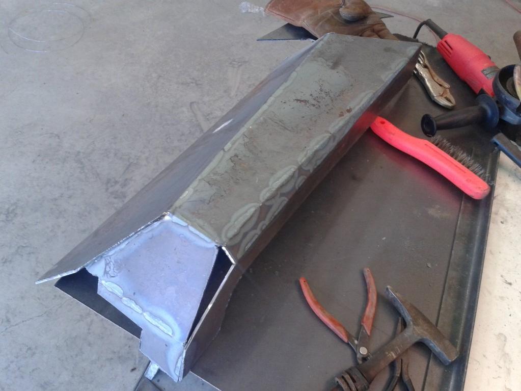

I haven't had much time to work on the bumper. I took the pattern and transferred it over to a sheet of 11 gauge steel.
I bent it and tweeked it and right now it is fairly close to the form it needs to be.

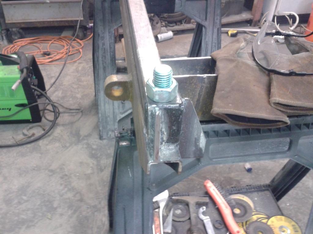

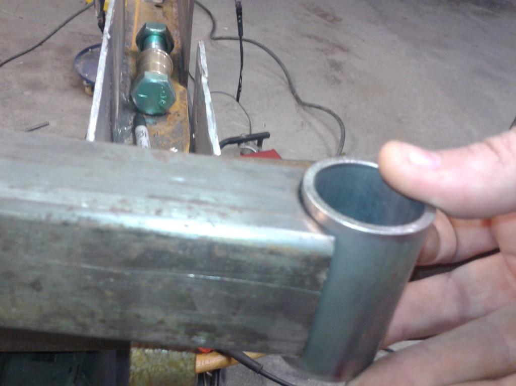

I also started the process of making the swing out carrier. I want the hinge and the latch finished before I finish the sides
so as to avoid any "surprises".
While I was welding on the "wing" I forgot to turn down the setting on the welder and burned through along one seam :frusty::doh::ybrick:
so I will have to do quite a bit of "massaging" of weld seams.
Anyway, you can see how it is starting to take shape. Next I will work on the latch side so I can begin on the drivers side wing.
In the pics, the wing is just sitting there, so the gaps are "big", but when I go to weld it together, it fits much better:hippie:

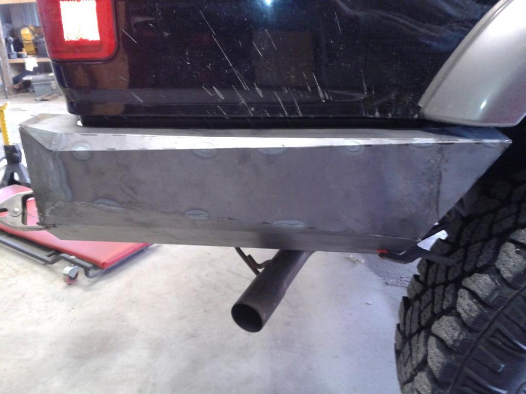

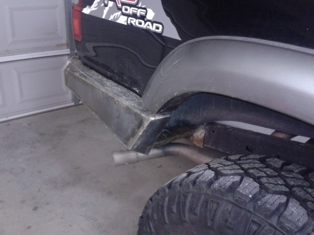

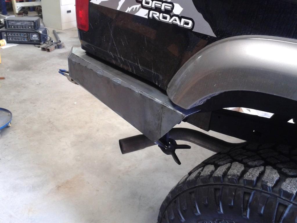

Test Fitting
Some more random pics from my test-fitting.
I am either going to have to remove the exhaust OR make a removable brace
for the passenger side....I fear that the exhaust will be in the way when it comes time
to install the bumper otherwise.
Soon I will finish welding up the seams, then the REAL work begins :whip:
I will need to grind down the exposed, welded seams to a nice crease to match
the other bends....should be interesting to see how good of a job I can do with
a grinding disk and "flapper" disks :bounce:

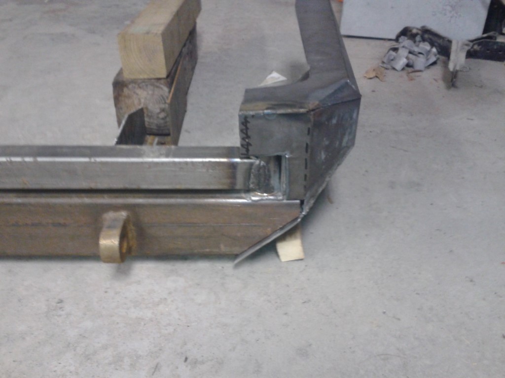

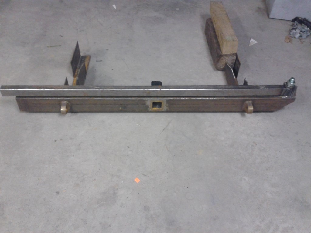

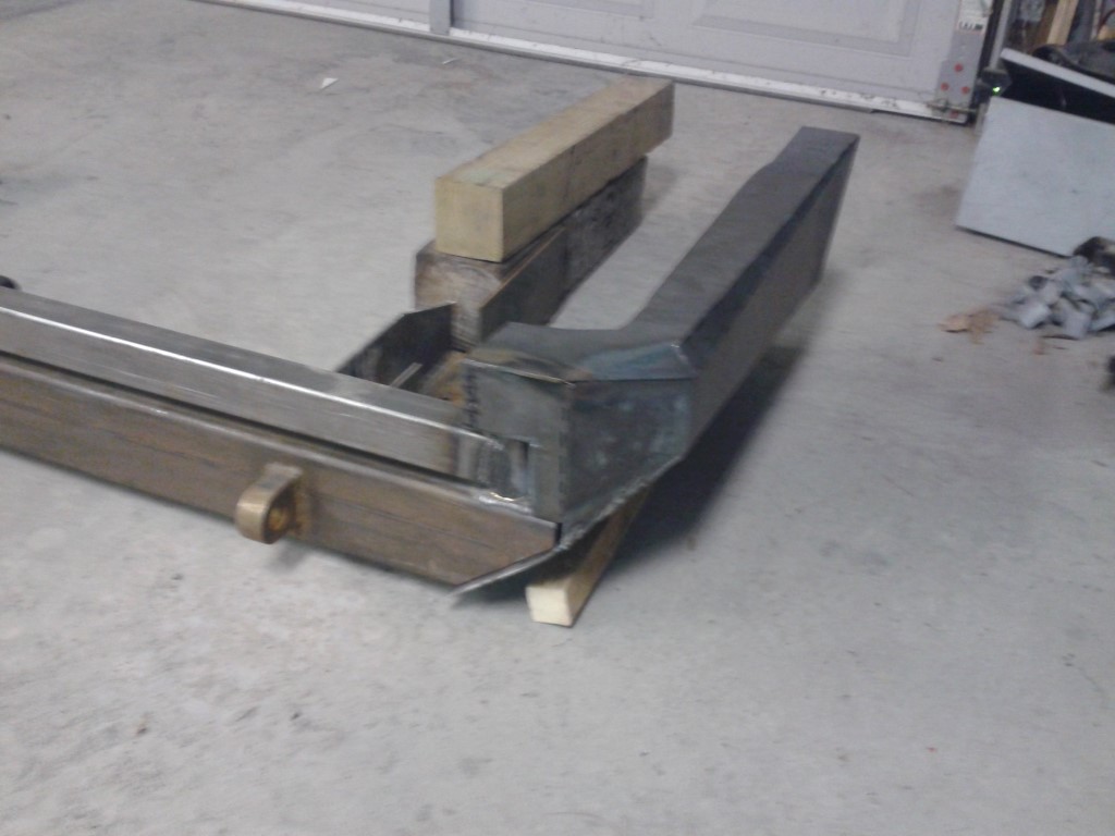

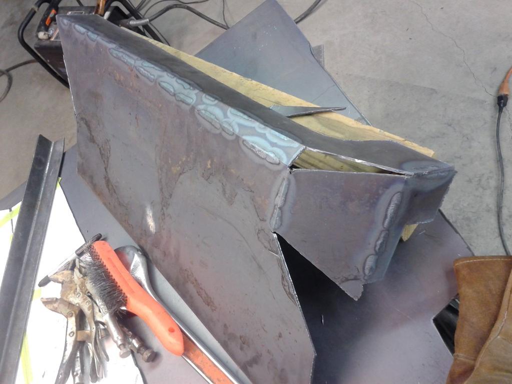

more progress

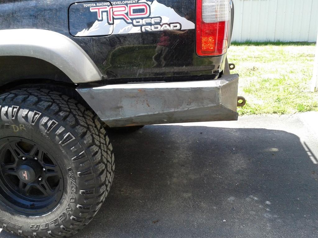

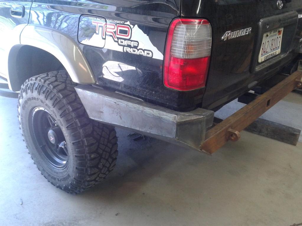

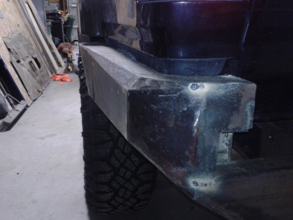

I finally had some time to work on the bumper some today.
I took some pics while I was bending up the drivers side of the rear bumper.
I used the same pattern I had made for the passanger side, and just bent it
"backwards" and voila, instant bumper.:eyebrows:
Hopefully I will be able to spend some time this week and maybe get to
"grinding and flapping" on it :frisky:
It is turning out pretty good, not perfect, but pretty good. I am enjoying
doing this, and I see the fruits of my labor beginning to pay off.

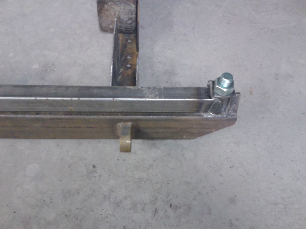

These are poor quality, and keep in mind that this is a work in progress.
I still need to do a LOT of finishing work.
I have been leaving it on the truck as I work; to lazy to take it off :wacko:

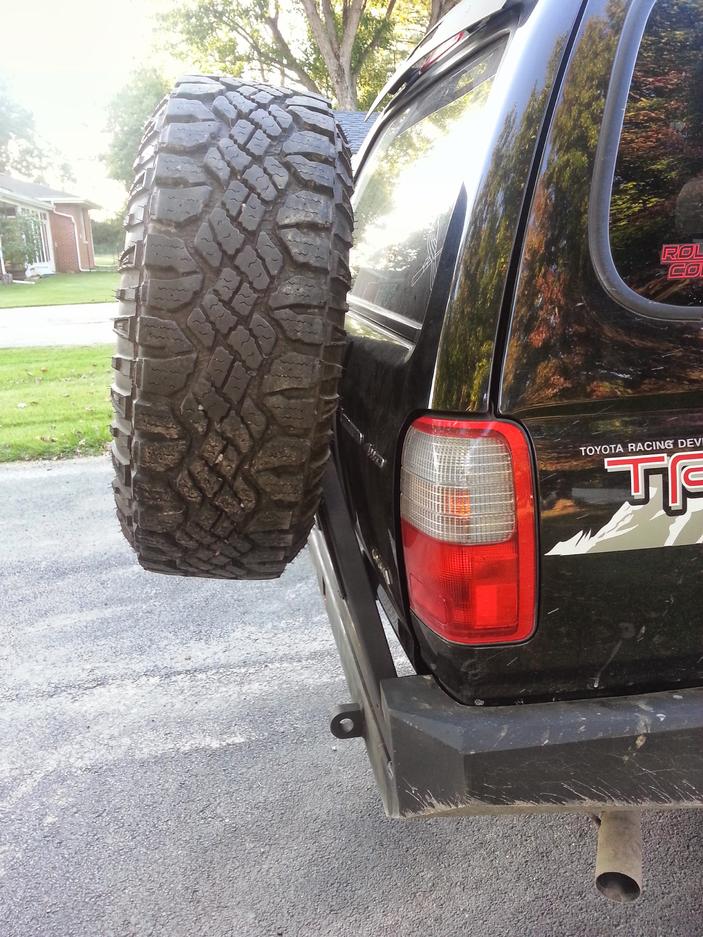

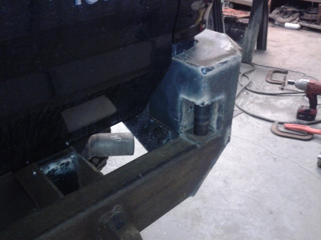

The big-ass bolt on the rear is what holds on the swing-out tire carrier
(not pictured and still in the design phase)

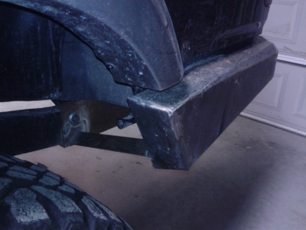

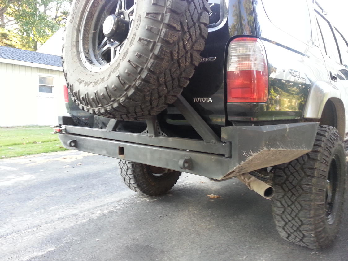

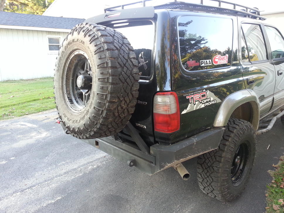

update:
I have been so very busy with work that I just haven't had much time to work on the runner or to post up here.
Having said that, here are some updated pics.
For now I have just rattle-canned some flat black. I plan on some good poly-type primer and a satin black finish.
