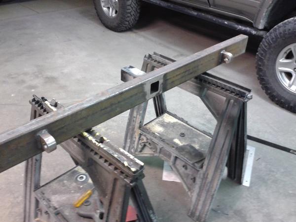

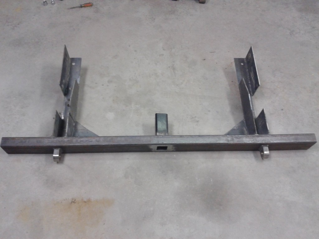

Well, I spend several hours working on the bumper today. I must say that my Forney 130FI welder is performing great. :yo: The steel is 3/16 and I don't think I would want to try and weld anything thicker with it, even though the book says it can do 1/4" stuff. I don't have gas, so I have to use flux core :tape2:. Keep in mind that I am not a good welder, so my welds will not look great. That's what a grinder is for, right?:wink2:

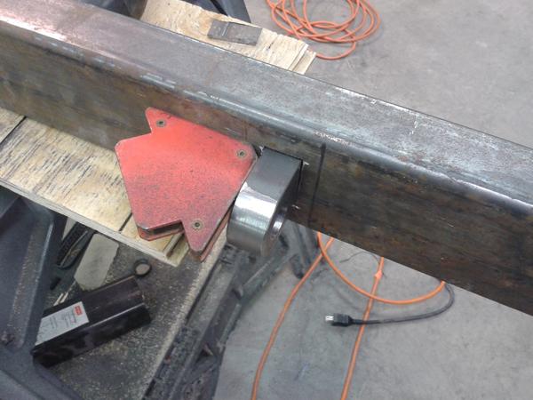

I managed to get the passenger side frame mount "mocked up" and tacked, but I won't do final welding for a while.
Getting it square.....
testing fitment.
Due to the 1" body lift, I have angled the bracket up for more clearance.

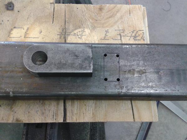

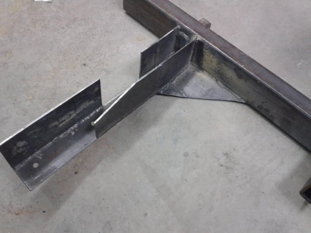

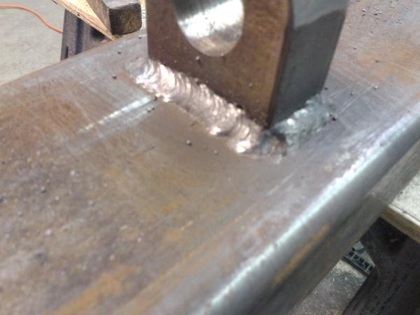

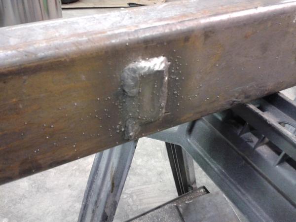

I wanted to tackle mounting the d-ring mounts and the trailer hitch. I wanted the hitch recessed, and the d-ring mounts are designed to pass through the 2" bumper and be welded on the front and rear sides. We don't want those pulling out :mmph:
Starting on the d-ring mounts
One side done :p
full_throttle-albums-rear+bumper+build-picture17181-closer-view-weld-i-am-amateur-shows.jpg
Back side.(I hate the splatter, but that's what I get for not having a gas bottle) :pout:

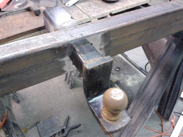

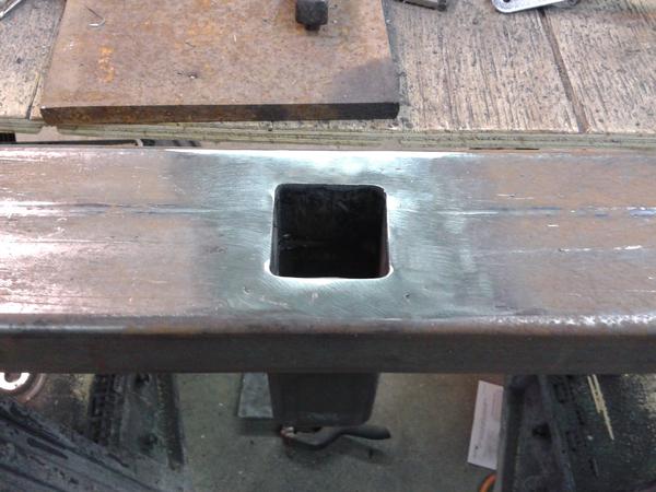

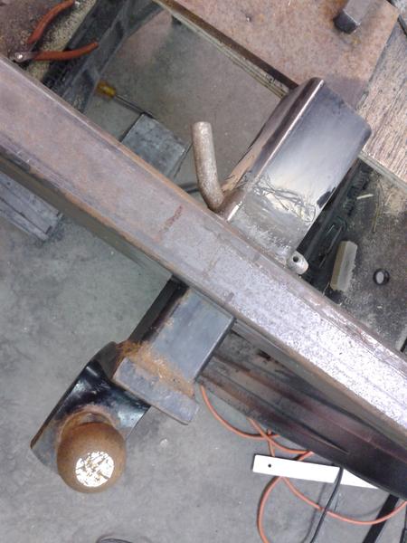

I recessed the trailer mount and made it so I can still put the pin in behind the bumper. Not really sure why I did it this way, vs. having the hitch stick out but oh well.
full_throttle-albums-rear+bumper+build-picture17184-another-angle-testing-hitch-fitment.jpg
Finally, finished for the day. Turned out just like I had planned. This was the easy part.:high5:

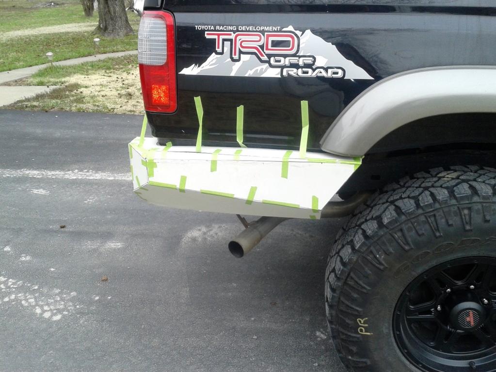

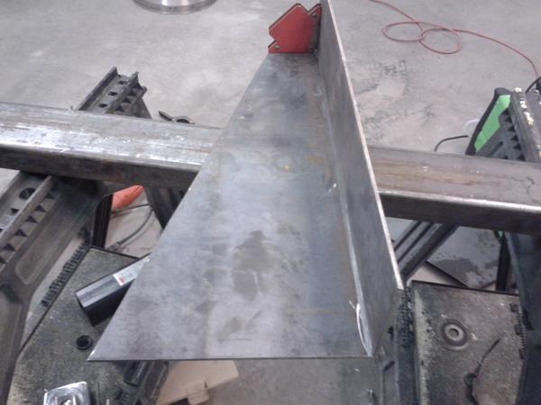

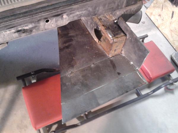

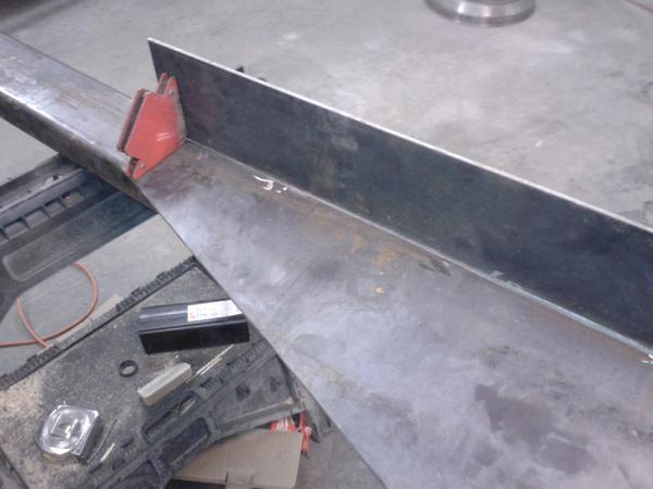

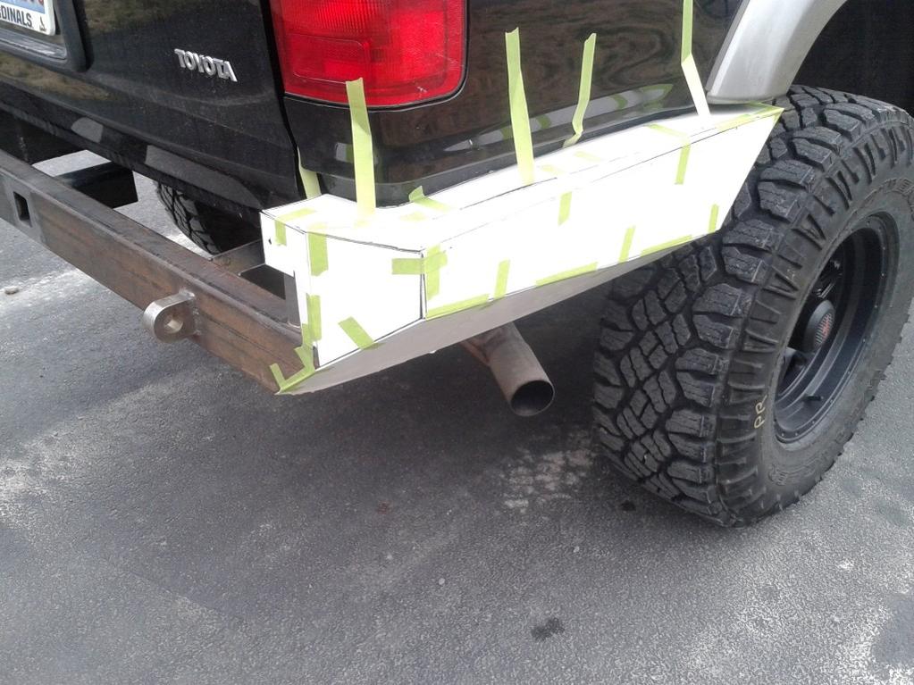

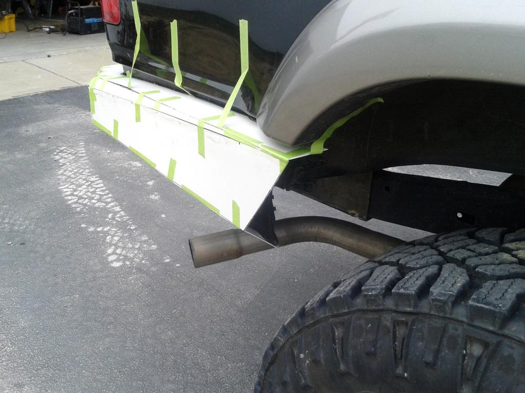

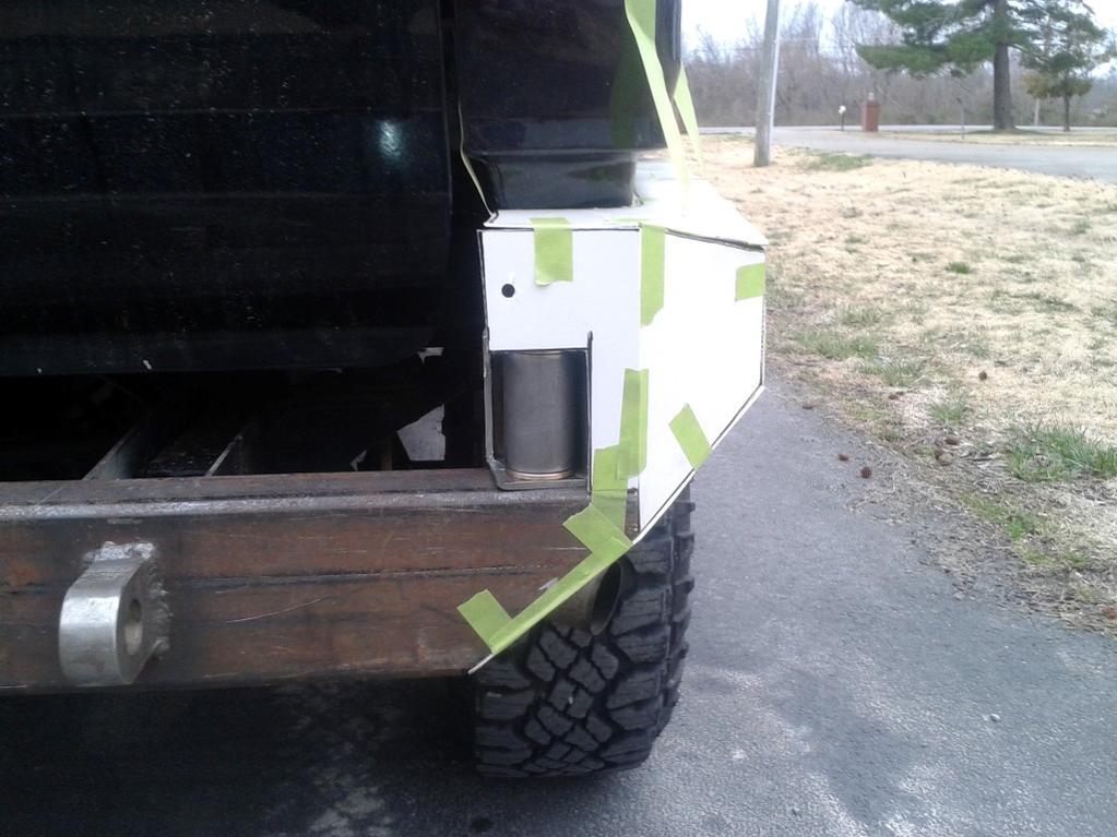

I was able to spent some time today working on the hinge for the tire swing and
working on the passenger side bumper "wing" for lack of a better word.
While I am basing this bumper off of a BruceTS bumper, I am also adding in some of Bandit Runner's design and Prospectator's design.
[No message]
This took close to 2 hours to mock up. My plan is to lay it out flat and use it as a pattern on 11 gauge steel. I will then make the appropriate bends to limit the amount of visible welding I will have to do. It is hard to see because of the brightness of the material, but there is actually a few angles running down the side, it is not just "squared" off. I took inspiration from this thread and this thread. Props to all those who have done this in the past and posted up pics so I could see how you did it and have the courage to try it myself. :love:
