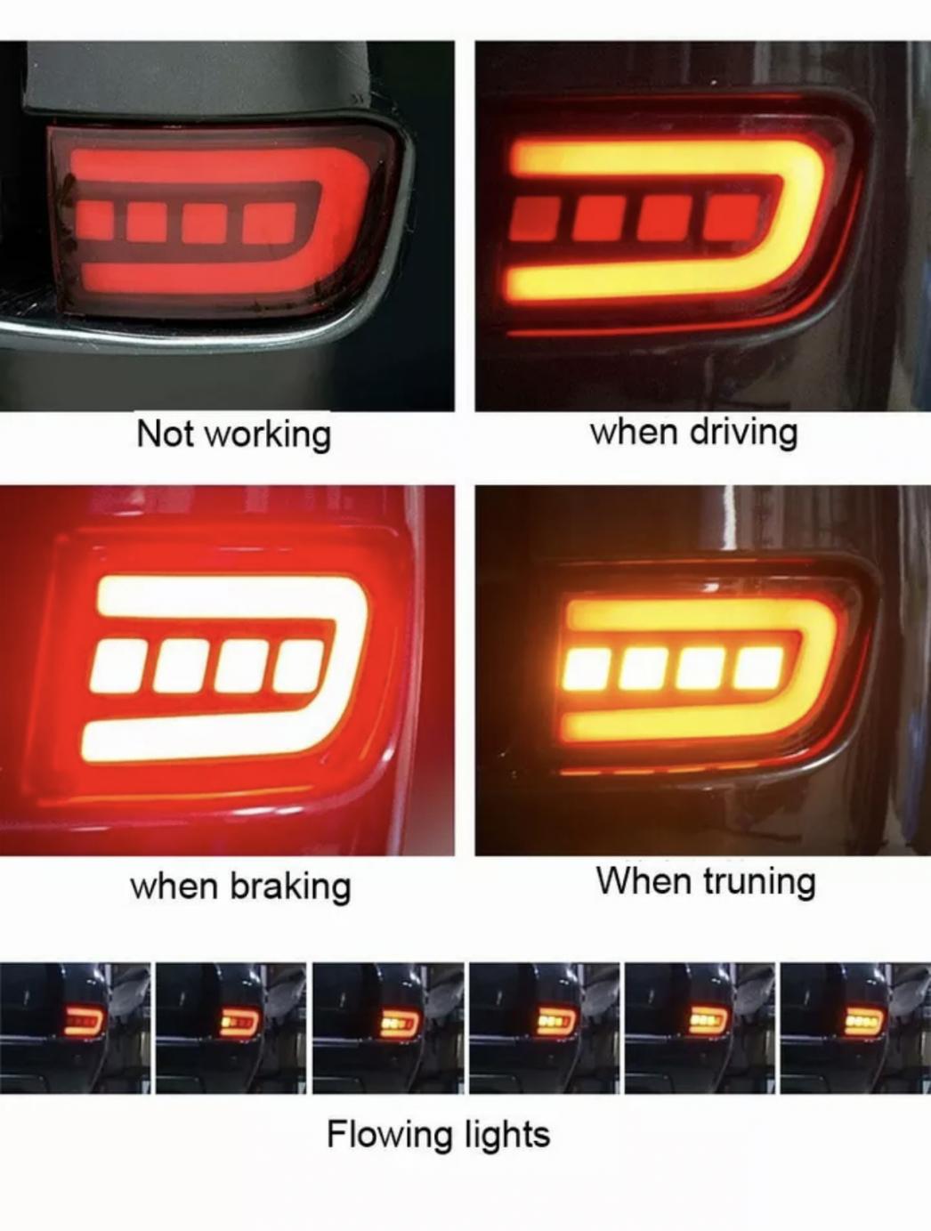

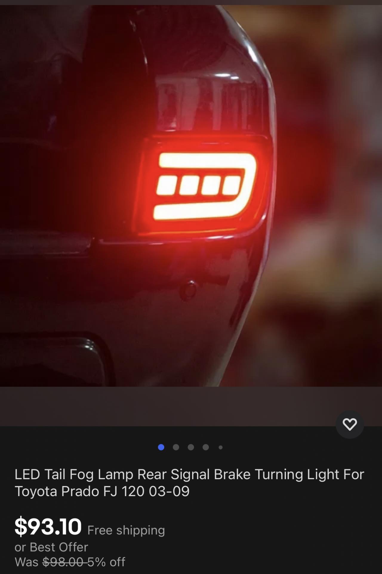

I chose to buy and install these. They work great for run, brake and turn lights. Wired directly to the tail light harness.
