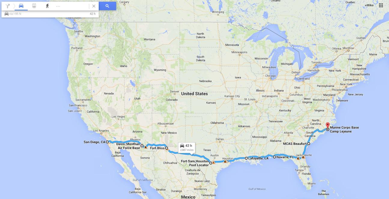

The new route would take me east on I-8 to I-10, all the way to I-95 North. As far as I know, this is just about the flattest route you can take across the country, with the only significant elevation changes occuring early on, through the Cuyamaca Mountains east of San Diego (a few 6% grades and max elevation around 4800 feet, I think).
The final route I decided on came out to 2,894 miles, not including stops for gas, food, and lodging:

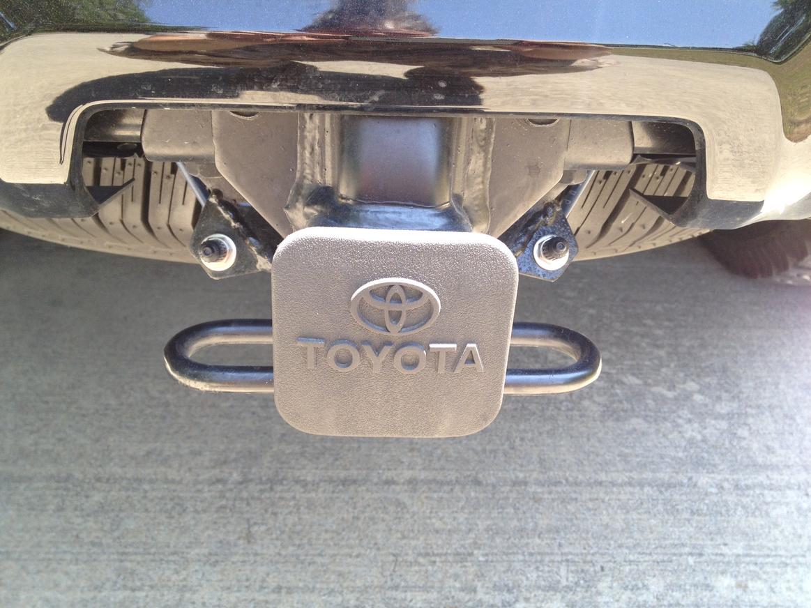

Tow vehicle is a 4Runner, of course. A 2014 SR5 Premium 4x4 to be exact. I know its relatively short wheelbase and V6 engine make it less than an ideal tow vehicle, so I set out to make what improvements I could. The first thing I did was swap out the stock P tires for LT tires. I went with BF Goodrich All-Terrains in load range C, stock sizes. For transmission cooling, I went with a B&M SuperCooler (#70264). For a little extra help with the load on the rear end, I opted for Firestone Coil-Rite air bags (#4135). Finally, for brake control I chose the top-of-the line Tekonsha P3, wired with the 3040-P adapter to make it completely plug-and-play. The tranny cooler and air bags were installed by The Truck Shop in San Diego, a Toyota truck specialist. They fabbed really neat metal flanges onto the tow hitch in order to mount the valves for the air bag hoses:View attachment 119888
Really clean install; I was impressed.

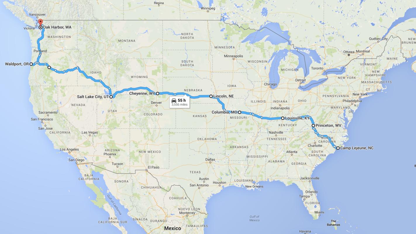

Just wanted to post a quick update to this thread. Recently moved all the way back to the West Coast from the East Coast, specifically from North Carolina to Washington. As before, towed my BMW behind the 4Runner with the same set up detailed in the original post.
Pretty much the same impressions hold true from the previous trip - take your time, pay attention, and know your limits, and this truck can tow just fine. Didn't track MPG's, but gas guzzling didn't seem too extreme. Mostly was able to maintain speeds in the 60-70 MPH range, occasionally dipping down to 50-70 MPH through the Appalachians in WV and Rockies in UT. There were a handful of steep climbs that probably dipped into the 40's, but they were definitely the exception rather than the rule. I think part of this was a function of the route I took (I-80 through the Rockies), as I understand other routes are a bit more treacherous.
Overall, very happy with the pull, and for my purposes I'm still happy I went with the 'Runner rather than a more capable TV (like a Tundra) which would be a compromise in almost every other scenario.
