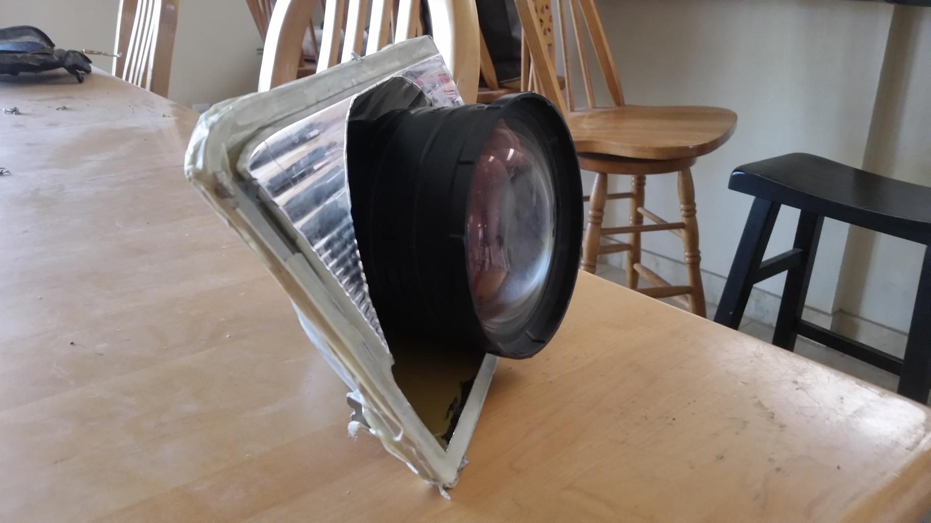

also im starting a new retrofit with these projectors i got. im not sure what they came out of but ive already basically destroyed my headlights so hopefully they work. im deciding whether or not to do a quad retrofit if i can find another set of the same size. let me know what you think.
