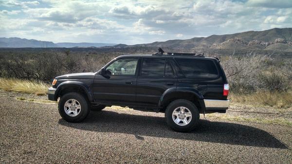

So I finally got the solid platform for my expedition vehicle Ive been planning for a few years. Its a black 2002 4runner with 145k miles on it.
As she looks now with 225k+ miles
This is her on our first day trip.

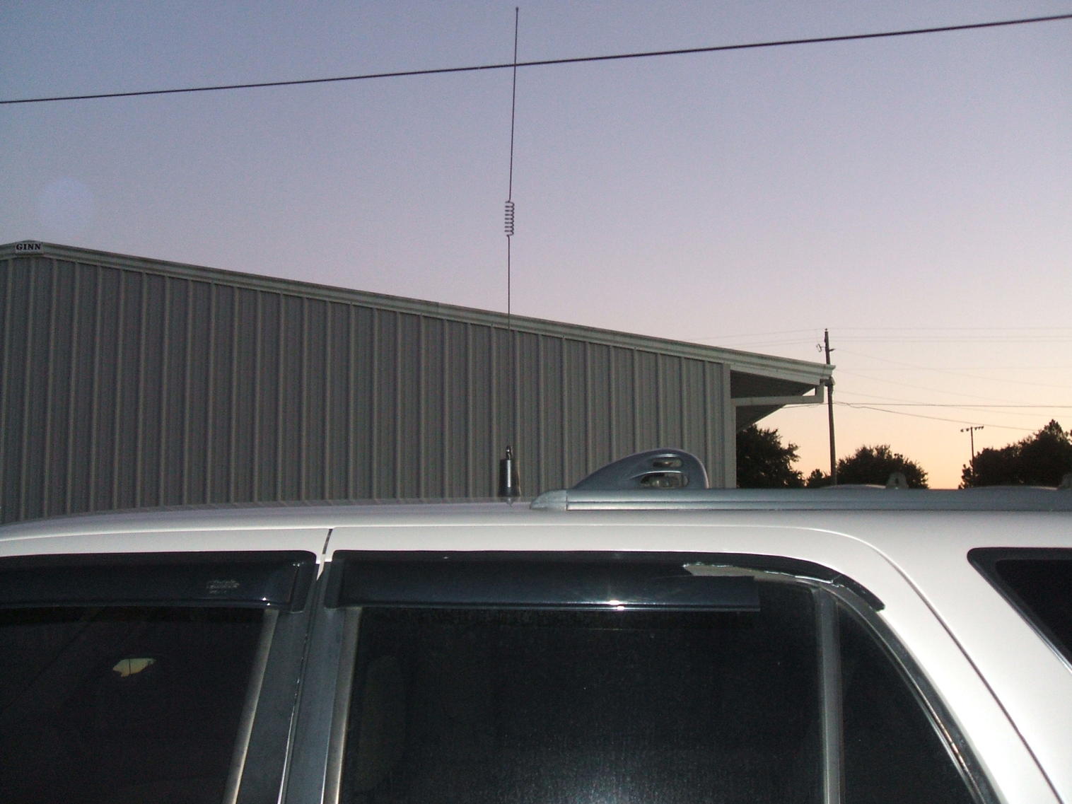

Thanks man, Idk about the rack yet but it will be a short one that doest cover the Sunroof. If I use it for lights I want them set back so I wont get reflection off the hood. Also I think im use a NMO mount for my Ham radio antenna and I want that in front of the rack but behind the sunroof.
In my disaster response group, I always seem to get comments about how well my radio sounds. As you can see, I have a nmo mount antenna just ahead of my rack. Thankfully, I managed to find a t4r without a sunroof hehe. We get enough sun here in Georgia, I don't need any more.
Have fun!
