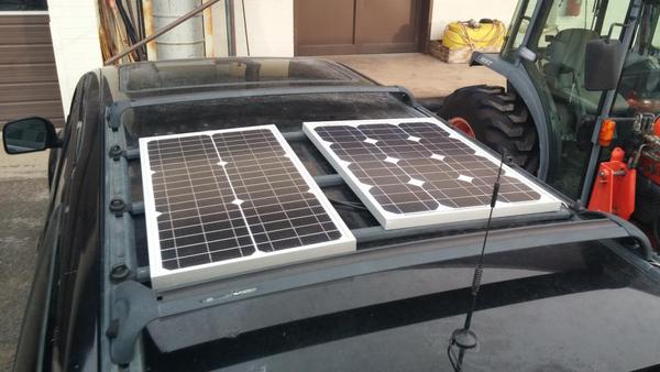

So lets talk solar. I always want more. I installed another 30w panel on the roof, still using the same morning star controller.

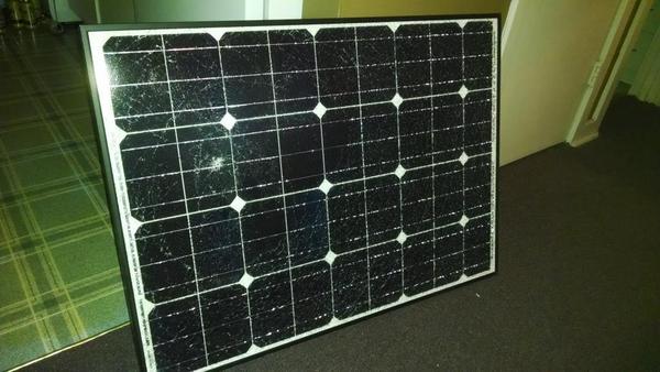

So Im still not satisfied with my solar since its normally hot and im adding more drinks to the fridge over camping trips. Add my heated blanket use and solar cannot keep up So instead of conserve I will add more solar! haha. I ordered a 85w panel that will replace the 60w now. But sadly it arrived cracked!
Im in the process of returning it and Ill try again. At $125 shipped for the 85w panel it not bad at all.

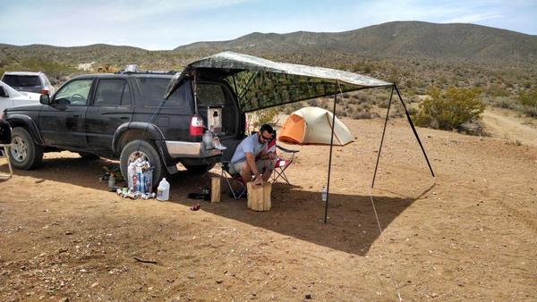

Ok time for shade. I wanted a way for shade but cant handle the super high prices for most premade systems. Yes they look nice and maybe some day ill get one but for now I just wanted a cheap simple option. I bought a camo tarp from walmart for like $15 and some bungie cords. I got 2 poles for either a tent or shade setup idk but they seem to work great.

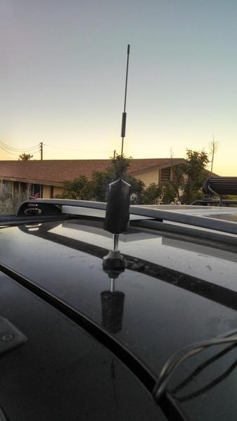

Always trying to improve communications. My magnet mount antenna for the cellphone booster works great but it keeps sliding around from car washes and random stuff scratching up my roof. Also I got a few pretty nice NMO antenna's so I figured it was time to install the nmo and cut into the ROOF! Im not happy with the signal as it actually a little worse then my magnet antenna. I think it has to do with the cheap cable my nmo came with so ill be upgrading to nice LMR400 and hope to see better improvements.

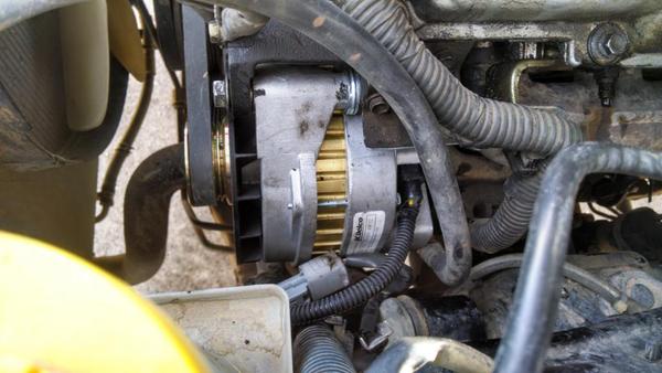

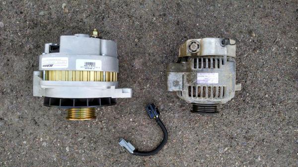

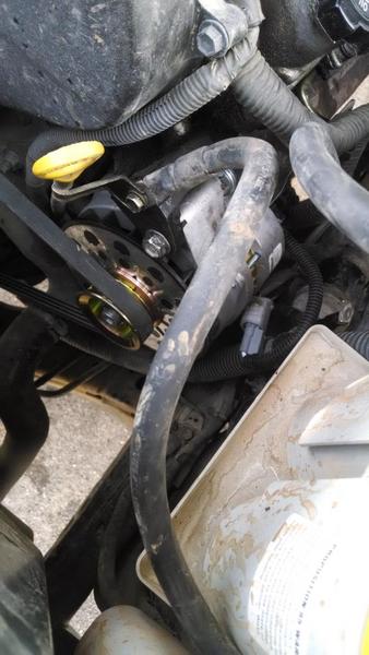

Now more POWER!!! We all know about the cs144 alternator mod-- Is you dont just seach google and there is a ton of write ups so Ill jsut stick to the basics.
I bought mine off amazon open boxed item. $60 shipped ( best price I found by far)
ACDelco 335-1048 Professional Alternator
I found the adaptor on ebay for like $18 shipped, This allowed me to plug the stock alternator plug into the alternator with out splicing or cutting wires.
I also needed 3 3/8 washers so fill the extra room this alternator had, you can see them in the pictures.
It was a pretty straight forward mod, the bottom bracket gave me a little trouble since you need to move it down for it it clear then pull it back up and bolt it up. I was just able to push it down with force and pull it back up hard but not to bad.
This goes from 80amp stock to 140amps and 100amps at idle( ill be testing this tomorrow since I needed to drain the battery down a good amount to push that much amps)
The end large black wire you see is part of my grounding mods

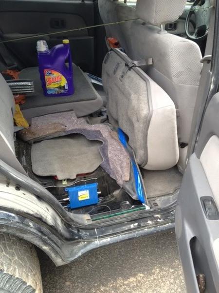

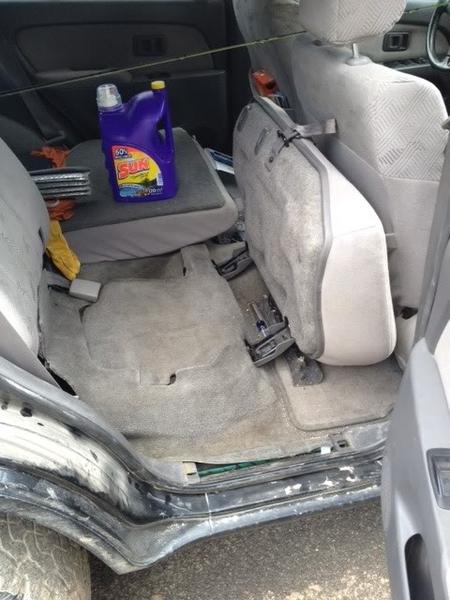

I have also purchased a wilson cellphone booster. You can see the antenna in the solar picture #54 . The wire runs into the car from the brake light wiring boot and runs under the headliner and down the back seat pillar. I just glued the Amp under the carpet as seen in the picture. As of now it still plugs into cigarette plug but I will be hard wiring it with a switch to turn on and off as needed. the phone cradle just sits next to my seat and I use it when needed.
I purchased this unit. I paid $160 at the time.
