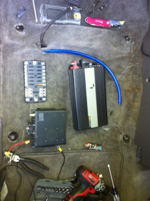

So I finally got around to installing the 1000w inverter. I pulled the #6 wire and ran a #4 from the second battery. So the inverter and blue sea fuse box is running off the second battery :banana:
This is whats under my seat now :)
