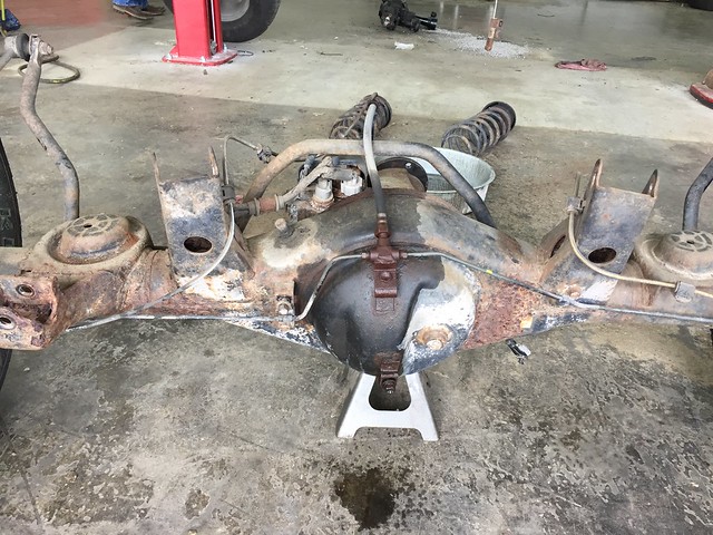

I just spent almost 7 hours pulling the front diff assembly and complete rear axle from my 97 Limited and my 02 Sport to swap them.
The 97 had 4.30's and an e-locker. The 02 had 4.10's and no locker, so you can understand the reason for the change.

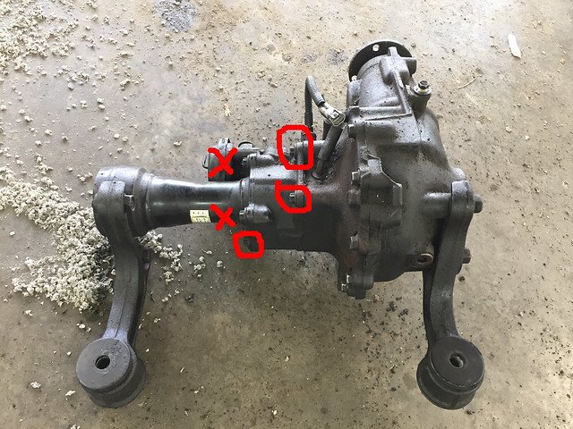

A couple of quick photos from my axle swap. Checked everything over again today and all seems well.
The front diff assembly is somewhat easy, just needed help rotating the assembly 90 degrees to clear the rear mounting stud. The donor was vacuum actuated and mine is electronic. Simple as swapping ADD tubes.
4 E14 bolts hold the tubes on, 2 long and 2 short. Heat may be needed, I had one bolt that would not budge without it. Also be aware they are easy to round off the heads if the socket is not straight and properly seated.
Orange 3-part FIPG is needed to seal the tube to the diff.
3 of the 4 bolts to be removed are circled, the 2 with an X next to them are to be left along with swapping tube and actuators together

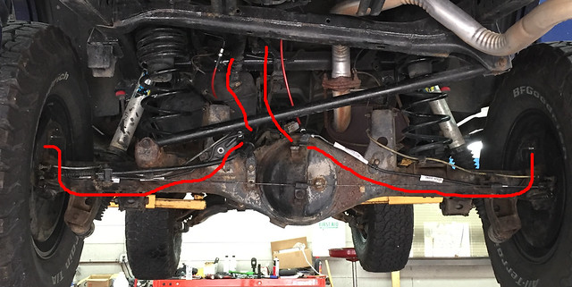

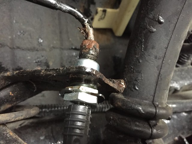

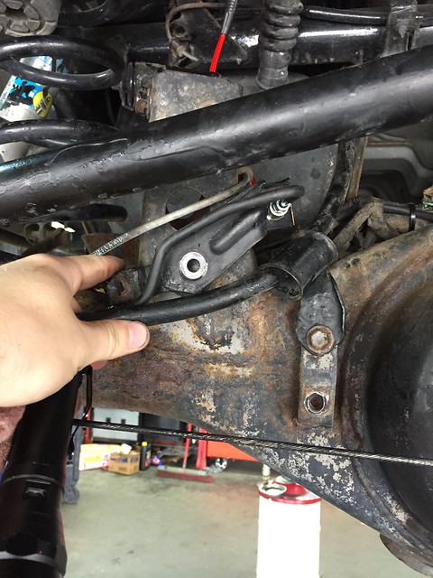

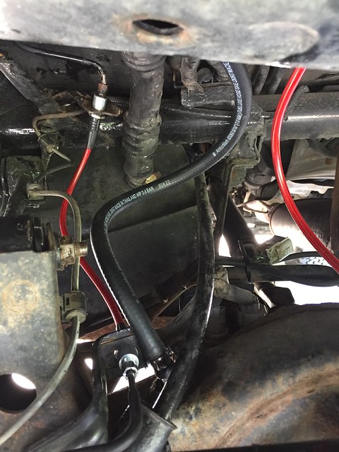

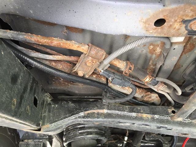

The rear was just as easy, only needing to swap over the brakes lines due to having VSC.
Donor axle with single brake line
The new lines followed by red. Simple as swapping from one axle to another, I opted for new hard lines and Wheeler's extended lines. Toyota hard lines are under $20 each which isn't bad at all.
All of the line brackets line up with the exception of one. I will drill a hole, weld a nut on the backside and bolt it into place eventually.
As for the Wheeler's extended lines, I can't say if this is an issue with them, or the bracket on my 4runner, but I need to find a solution for one end not fitting in the bracket and allowing the retainer clip to hold it in place. The c-clip fit fine, but the hex portion does not fit in the bracket so I can slide the retainer to secure it.

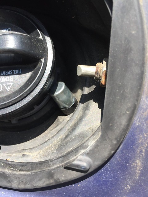

Rear diff breather extension

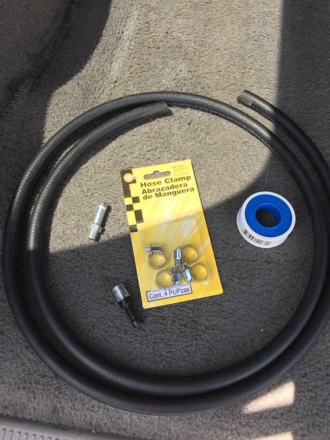

Decided to get this small mod done today in anticipation of a few water crossings I'll be doing soon.
All that you need for this....
6ft of 5/16 hose (tight fit, 3/8 would work too)
Appropriate sized hose clamps
90404-51319 - Union part number at axle housing
90930-03136 - Breather
Teflon tape (probably not necessary, but it makes me feel better)

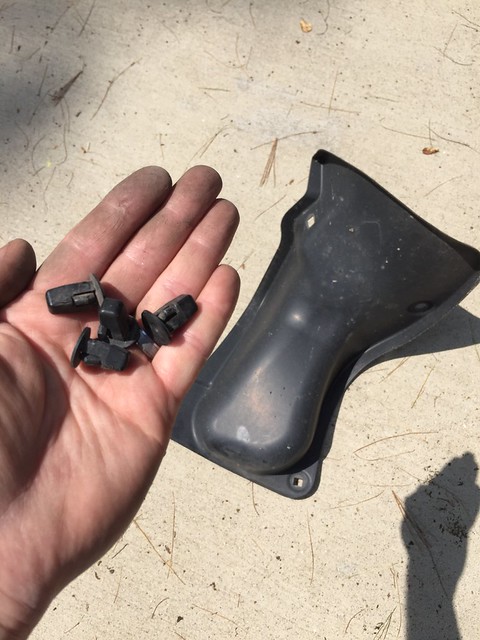

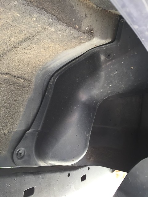

I started off by removing the fuel filler neck cover, held on with 4 plastic retainers. These have teeth on opposite edges on the backside that need to be pushed in to allow the retainer to release.
I then poked a hole in the rubber trim around the fuel cap. Some have said the fuel cap interferes with the breather, however once the hose is secured along the fuel filler neck, the breather is angled more to the right leaving plenty of room.

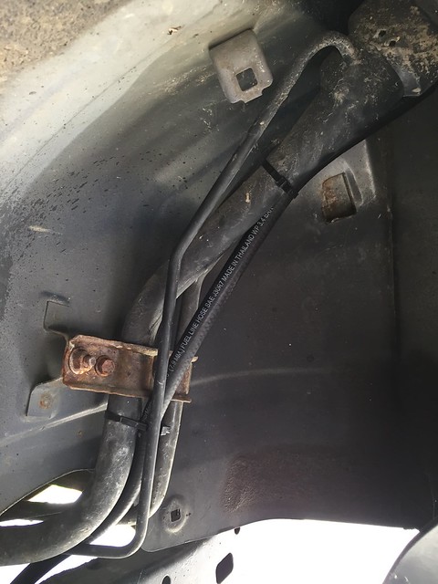

The hose is attached with a hose clamp, and ran along to the fuel filler neck, zip-tied in place.

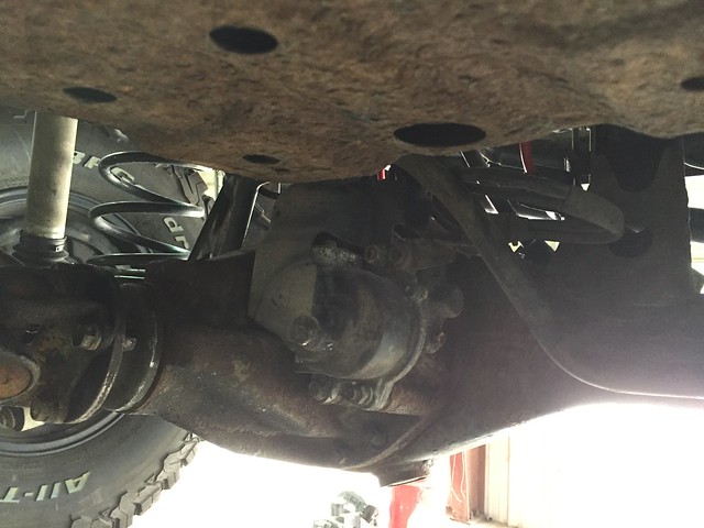

I continued running the hose along the fuel filler neck above the rear crossmember and then down to the union location.

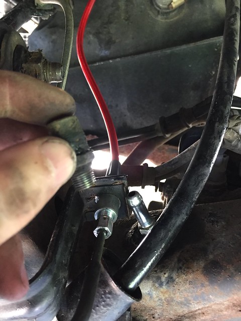

The old breather is removed from the housing and the new union with teflon tape is put in its place. The hose can then be secured to the union with another hose clamp. Be sure to leave plenty of slack for articulation purposes.
With that, the rear diff breather extension is complete.

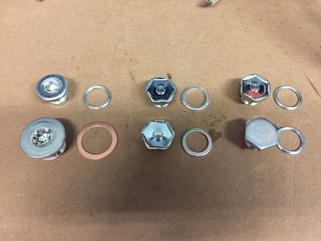

While changing the fluids in the front diff, transfer case, and rear diff...I decided to get all new fill and drain plugs along with the seal washers. The plugs will be kept on hand in case one strips out and gets damaged during a trip.
Info on what is used along with part numbers
Front diff - 75w90, 1.2ish quarts
Transfer case - 75w90, 1.1ish quarts
Rear diff w/ locker - 80w90, 3.1ish quarts
Rear diff w/o locker - 80w90, 2.6ish quarts
Front fill plug - 90341-18032 - torque to 29ft lbs
Front fill plug washer - 12157-10010
Front drain plug- 90341-24014 - torque to 48ft lbs
Front drain plug washer - 90430-24003
Transfer Case fill and drain plug - 90341-18006 - torque to 27ft lbs
Transfer Case fill and drain plug washer - 90430-A0003
Rear fill plug - 90341-18006 - torque to 39ft lbs
Rear fill plug washer - 12157-10010
Rear drain plug - 90341-18057 - torque to 39 ft lbs
Rear drain plug washer - 12157-10010

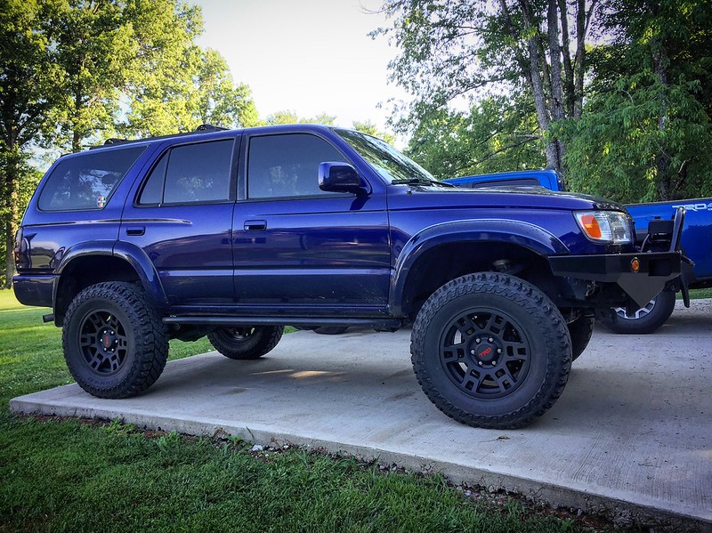

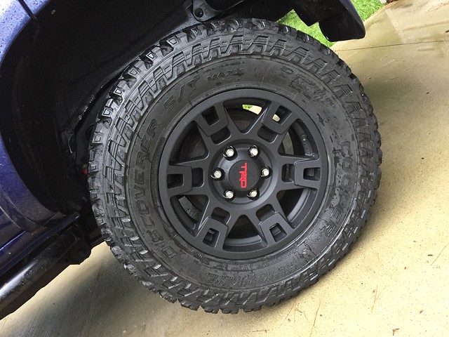

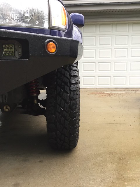

New wheels and rubber
I made the decision quickly after picking this up that I wanted to change to 255's and 17's. I sold the SCS's and picked up some new shoes....
17x7" TRD Pro in black
255/80r17 Cooper ST Maxx
For me, this is a perfect fit and look. I will be ordering black lugs soon.
