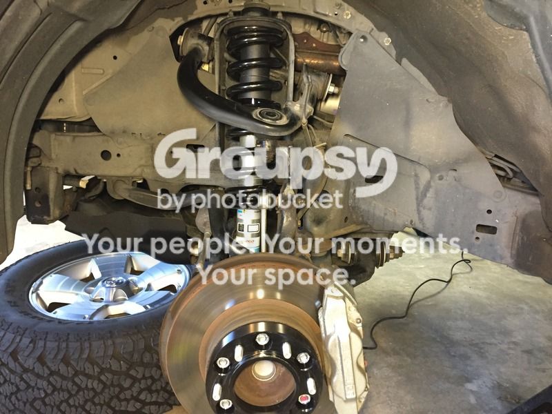

Installed the front today. It went very smooth. I did the "jack the LCA to compress the spring" approach. Way easier than using a traditional spring compressor.

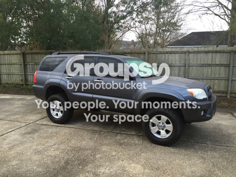

Overall I love the stance. Could not he happier.
Not sure that is next on the list other than to upgrade the headlight/fog bulbs but do not want to go HID. Any suggestions???

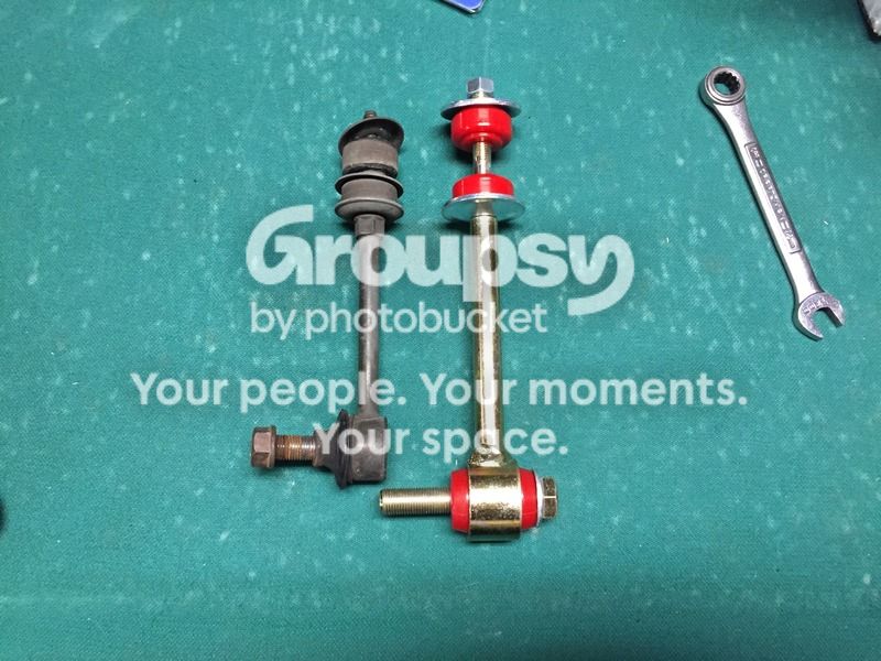

-Extended Rear Swaybar Endlinks

I am adding some OME 10mm Rear Spacers when my Extended Rear Links arrive. I do not have a big lean. Maybe 1/4"

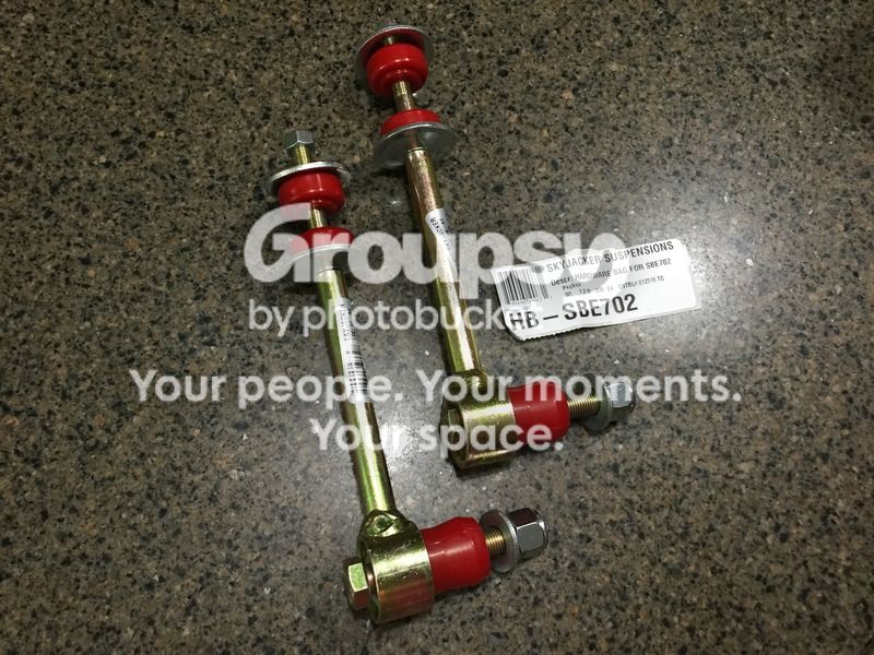

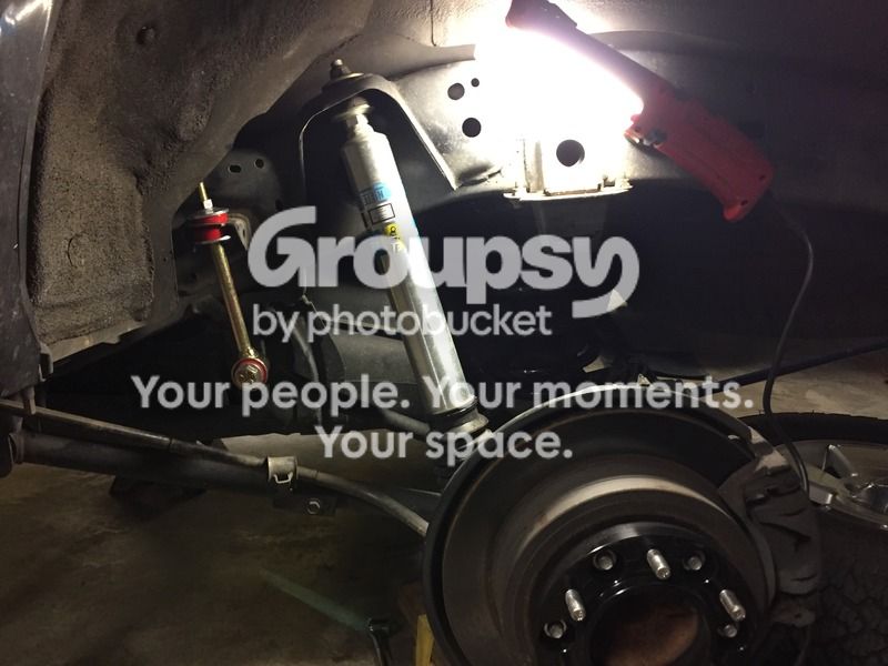

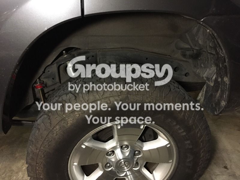

Installed the links last night. Install was straight forward. While I had it up in the air I added OME 10mm Trim Spacers to the Rear. I also bent the brake line bracket so the lines wont stretch under flex.
Looks good. Help me understand when longer end links are necessary?
You have a pretty big lift. I just have FJ coils and bigger tires on mine. but I need to replace. In that instance would it hurt anything to get these?
