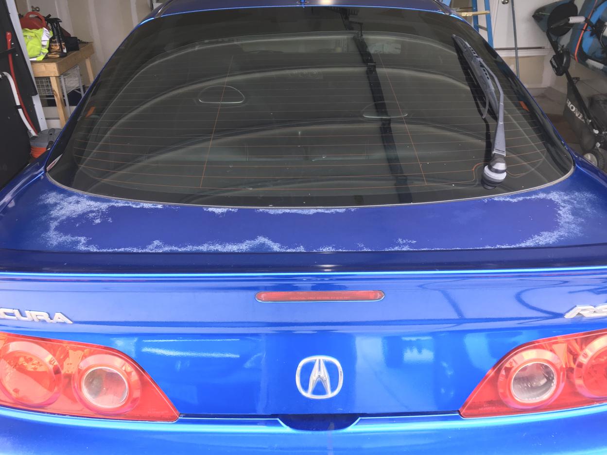

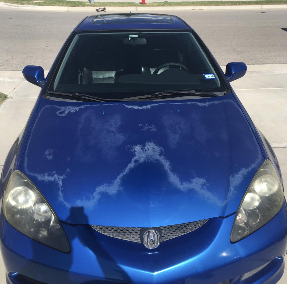

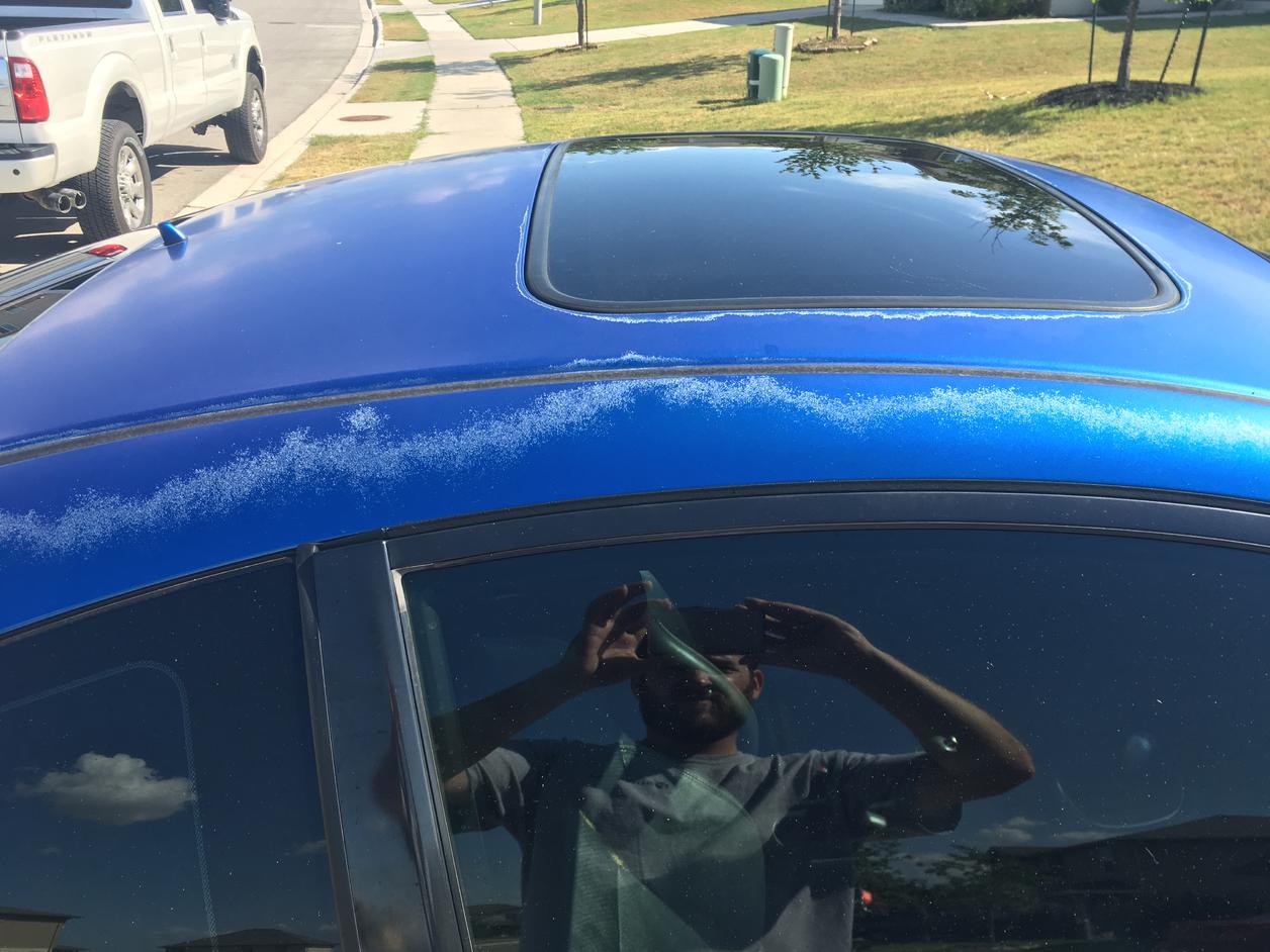

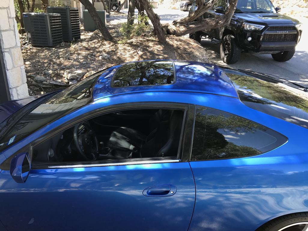

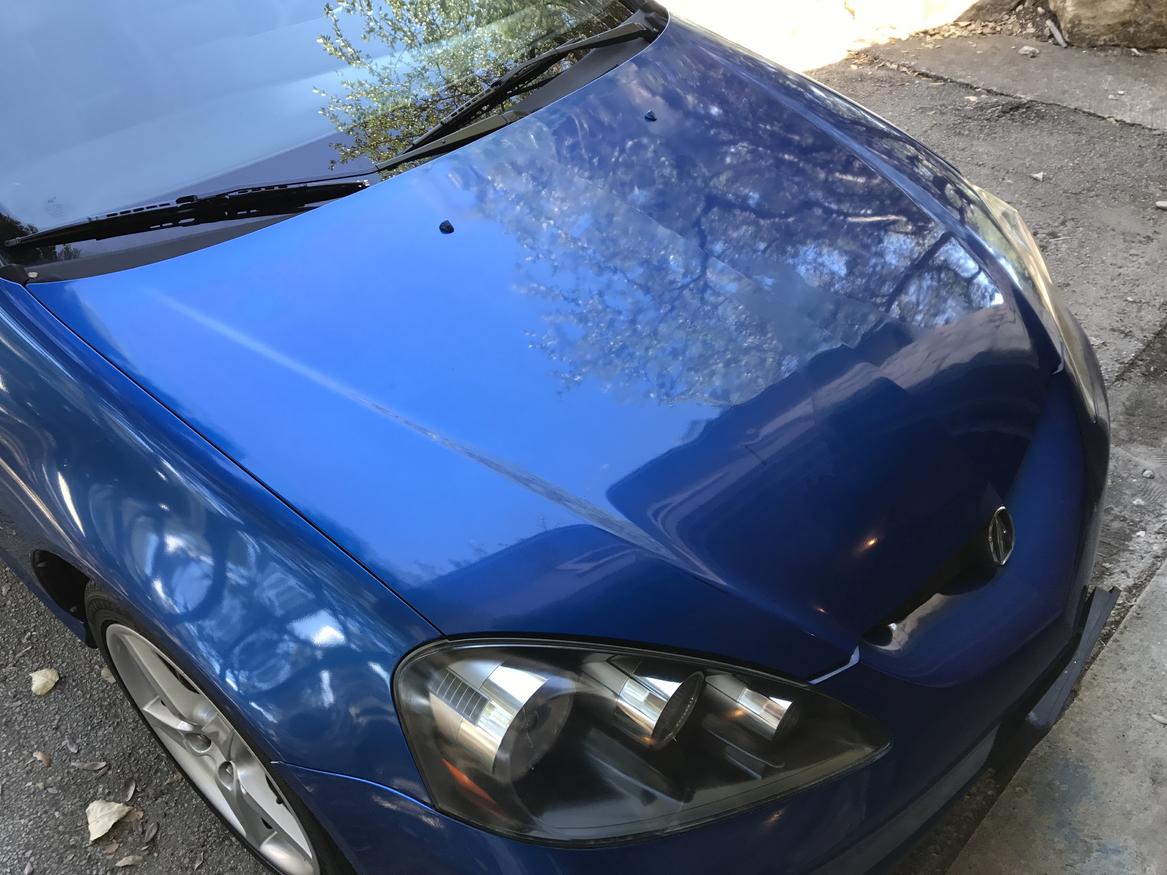

Clear coat was shot and peeling on multiple panels from exposure. I hit the paint with 1500 grit wet sand making sure I blended in the exposed paint with the good clear coat. After the sanding I used this rustoleum wipenew product that I have used in the past with good results. See the before and after pics.
Clear coat product I used.
These pictures were taken about a week ago.

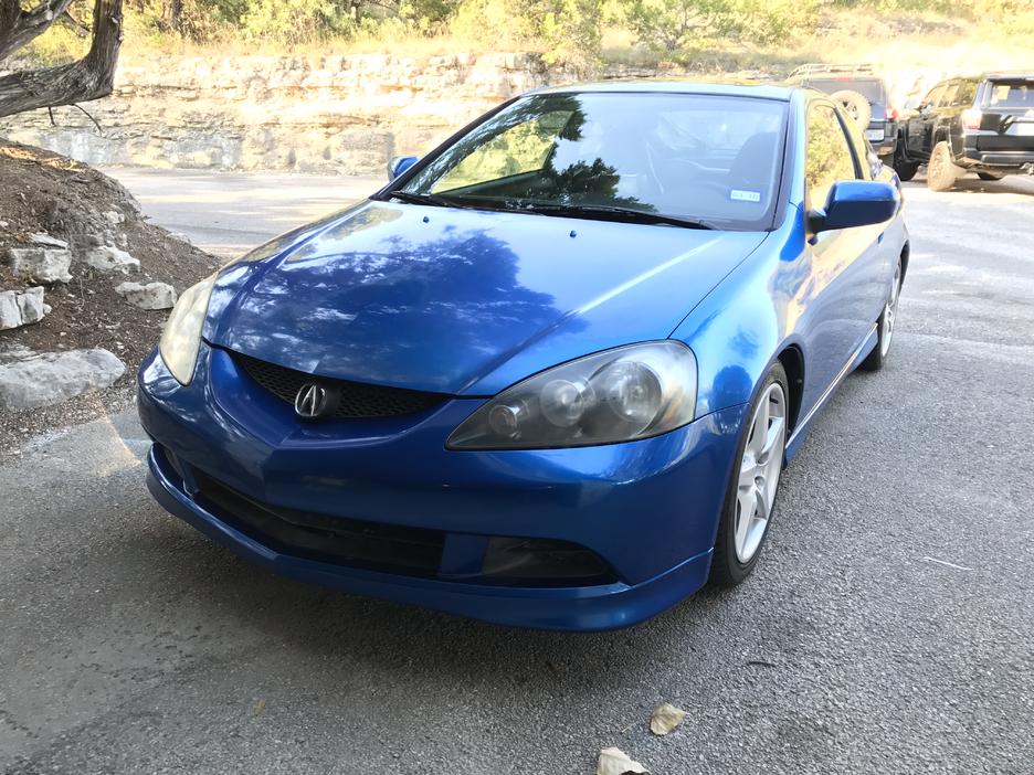

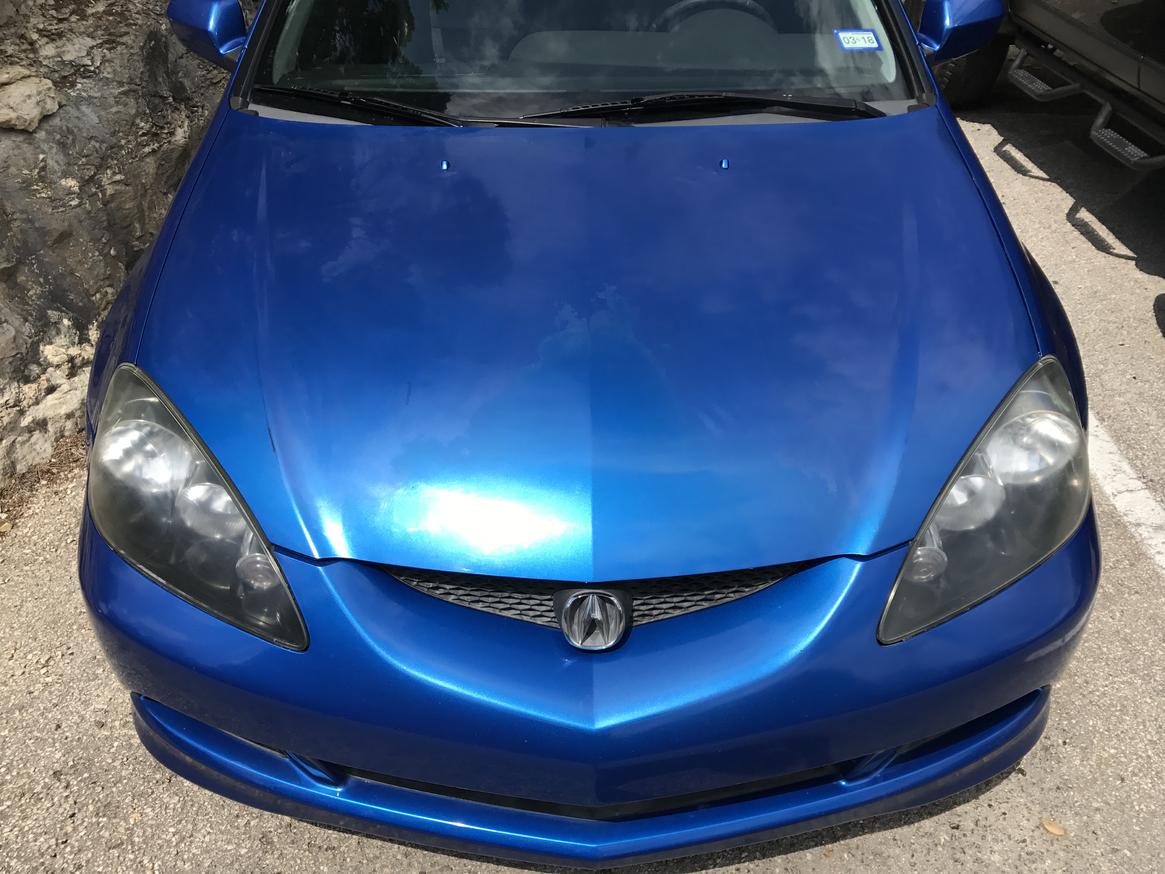

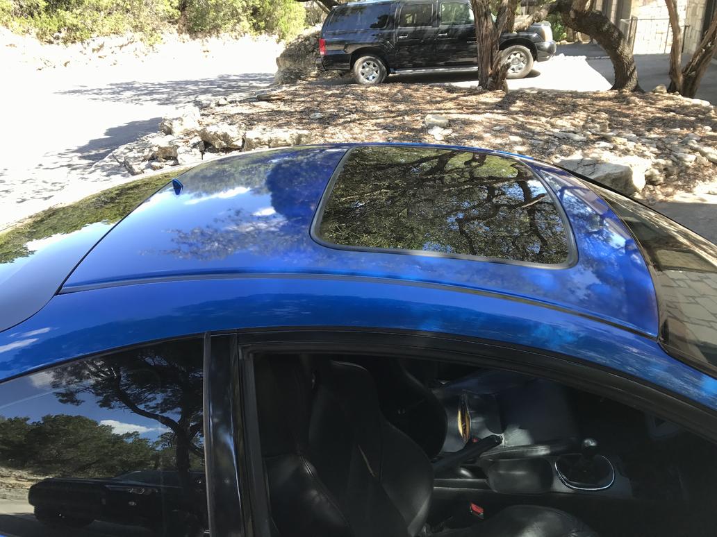

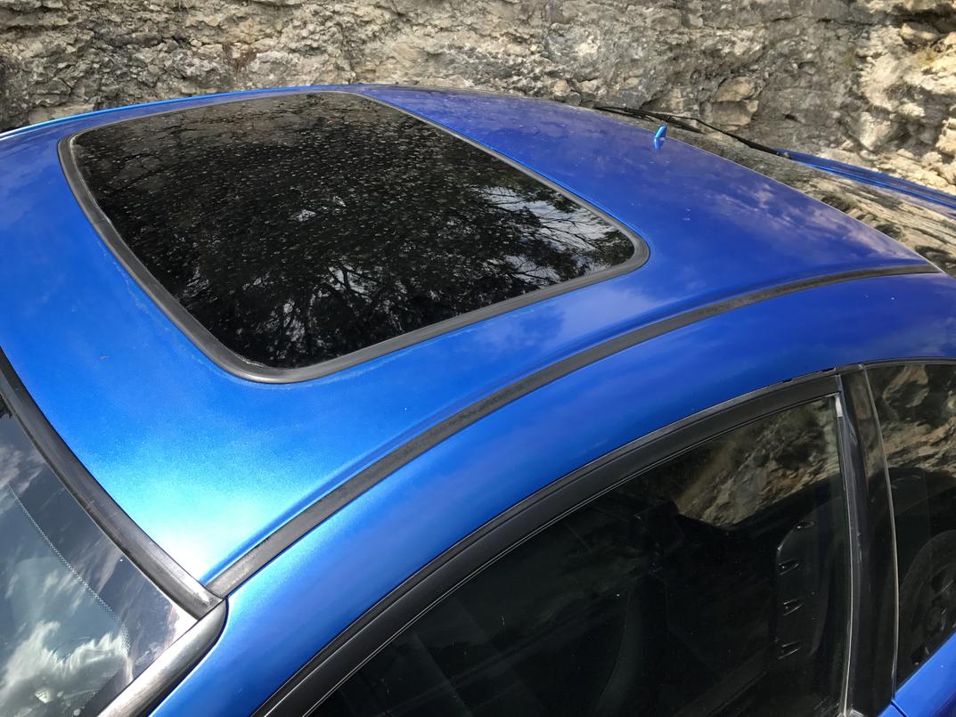

These were taken today after the product hardened into an acrylic like state.

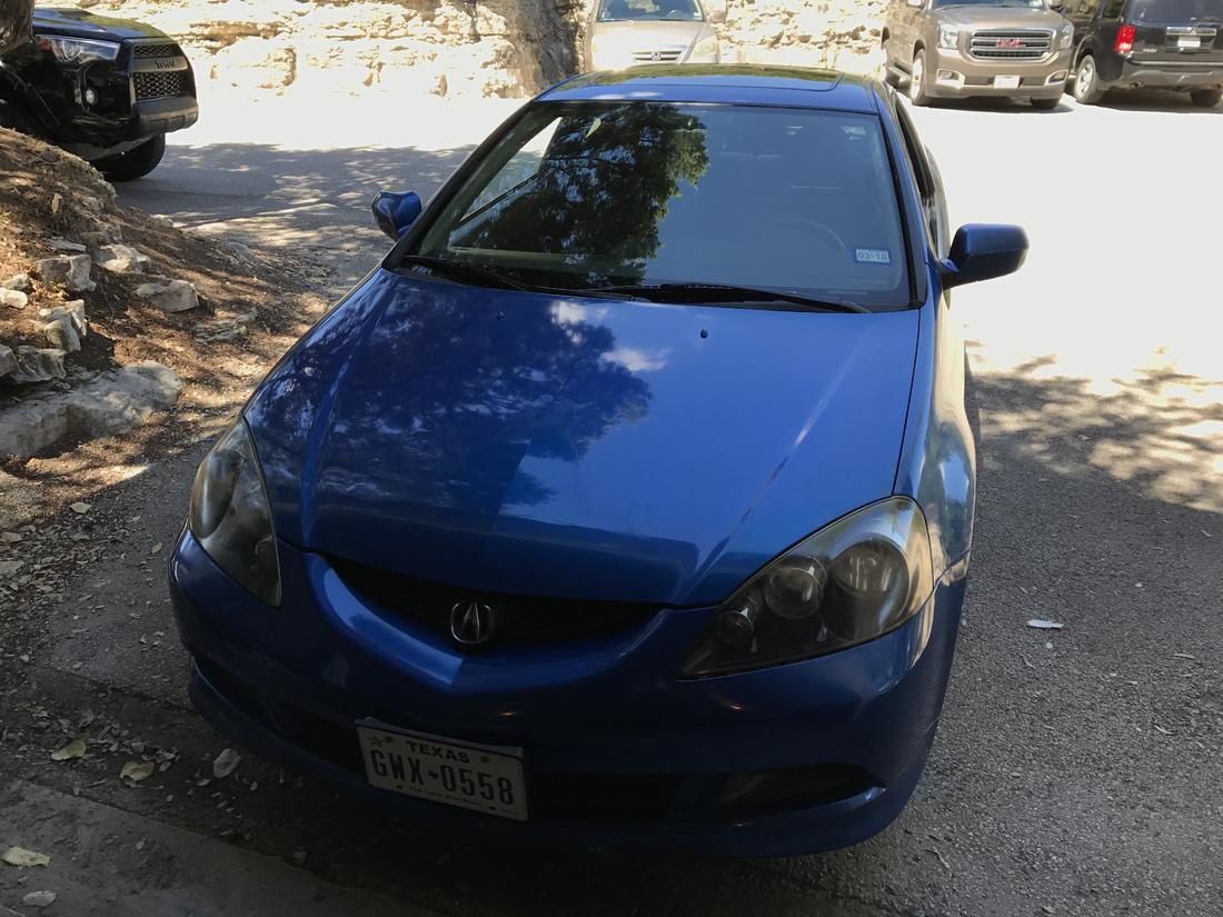

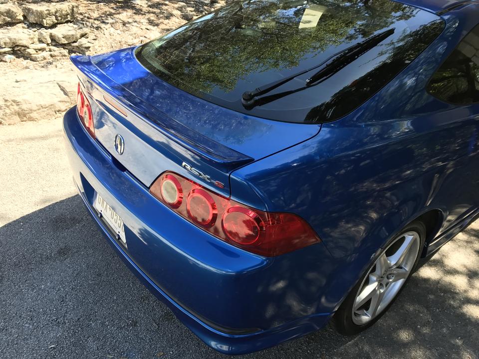

Got bored and did the front bumper too since it had clear coat issues. I know it's not a Toyota but at least you can see my 4runner and fj in the background lol.

That's basically it. Just a little bit of wet sanding. Don't go crazy or you will burn through the paint. I would definitely not recommend on newer vehicles. Only on old beaters.

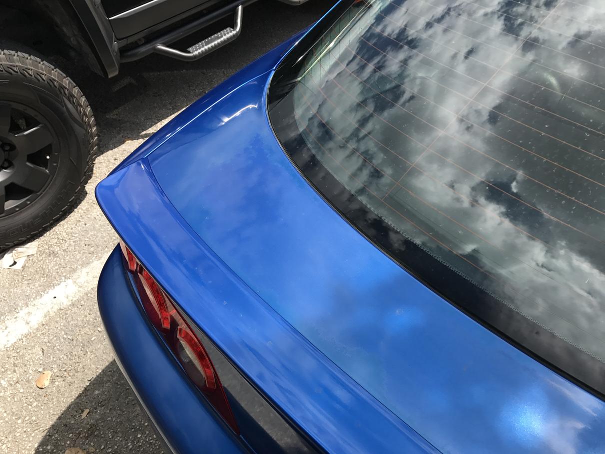

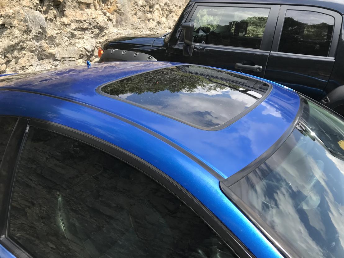

Here are some shots with the sun as requested.
