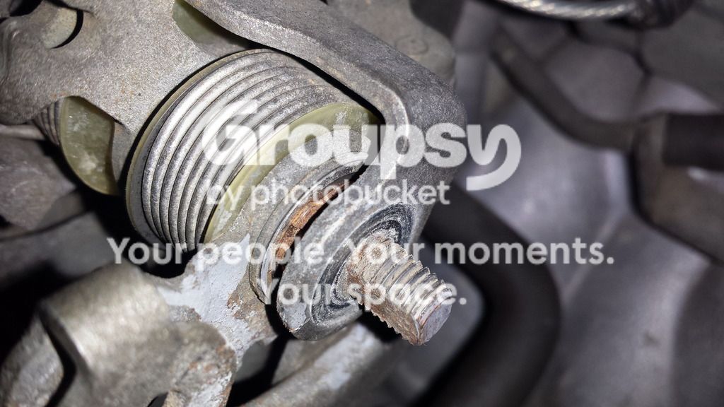

I think this is the thing that will fix my high idle. When my idle settles down to 1100-1500, I can pull the front of the throttle body linkage forward and the idle will settle down to about 600 rpms. I took the bolt off of the "action" for the butterfly valve; after that, I cannot get anything to slide off of the pivot for the butterfly valve. Should this just require more pulling, or something else?
Thanks for posting this Swede!
It's been a while now but if I remember correctly it took a bit of force to get it to release and slide off, but it did.
Thanks for responding so quickly! There is a snap-ring on the throttle body rod, just inside of the assembly for the throttle cable. I was wondering if that is preventing removal of things. I'll take another look and see what I can do with a little more force.
I still cannot get all the stuff off of the pivot screw for the throttle body; nothing will move off. There is a snap-ring near the outside, shown as the rusted thing in my picture. I think I have gotten it released, but things still won't budge. Has anyone else had any trouble with this procedure? Has anyone else gotten it off really easily?
