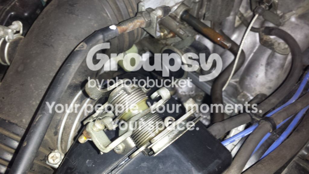

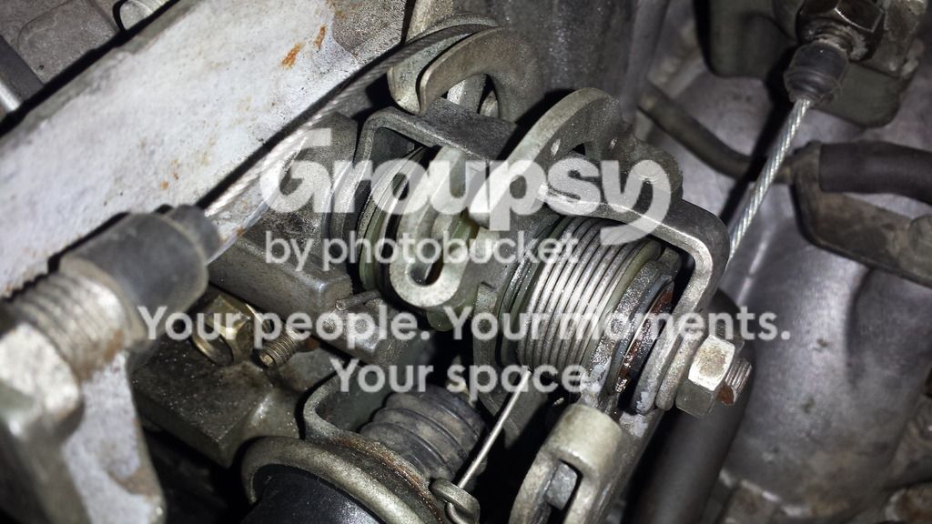

It's been almost 6 years since I posted this thread so my recollection of how hard it was to remove the linkage has faded a long time ago. That being said, I don't recall ever having to remove any retaining rings in there. That clip may just be to locate that part of the linkage to the sleeve that slides over the main rod. Your rod looks quite corroded though so I'd soak it in WD-40 or equivalent penetrating fluid overnight and then give it a try.
Thanks; I appreciate you responding. I soaked it all in PB Blaster overnight. There is that little snap-ring towards the outside of the action and there is another snap-ring close to the throttle body. The one near the throttle body seems pretty difficult/impossible to access. I've pulled on the action quite a bit and I can't get anything to move even slightly. Is everything arranged on a sleeve, placed over the rod? I'll have to look at it again. Maybe I need to spray penetrating oil into that sleeve?
*Edit: I went back and looked. There doesn't seem to be a sleeve that everything is arranged on.

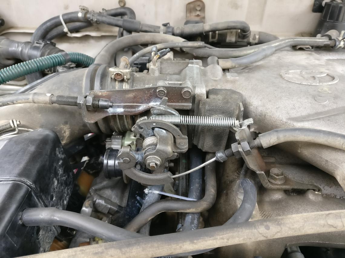

I'm assuming you have an auto tranny because the linkage looks a bit different than mine. It looks like you have two coil springs in that linkage where mine only has one being a 5-speed. Maybe this is why you're having such trouble.
The whole assy on mine came off the rod as a unit. Didn't touch any snap rings. I think the flats on the end of the rod have a slight taper where it goes into the spring "carrier". Makes it a very tight fit. I had to pry with a screw driver and tap the end of the rod with a hammer to get it to pop loose. Even after gently tightening it back together it took the pry and tap routine to get apart again.

I got it!! I didn't expect it to come off all as one piece. I covered it in penetrating oil and then went around it, tapping it with a hammer. After some time, I took a small pry bar to it and it popped off! Thank you all so much.

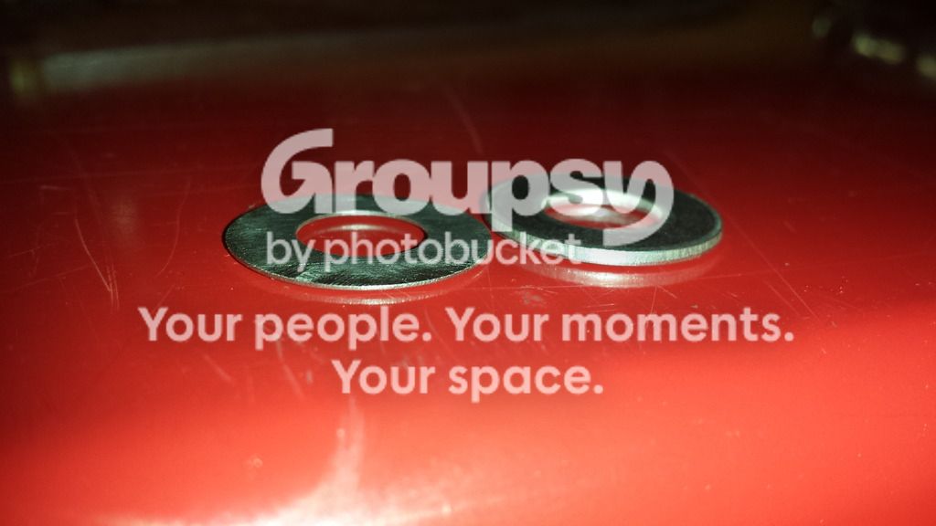

I thinned out a 3/8" washer by holding it in a vise and filing it down. I spun it to get the other side and then I sanded it smooth. I started it up and it seems to idle lower when cold, 1000-1100 RPMs; that seems like an improvement. I can't test drive it now because I have the rear suspension apart.
Here is the washer thinned out, compared to the original one, and then everything installed:
