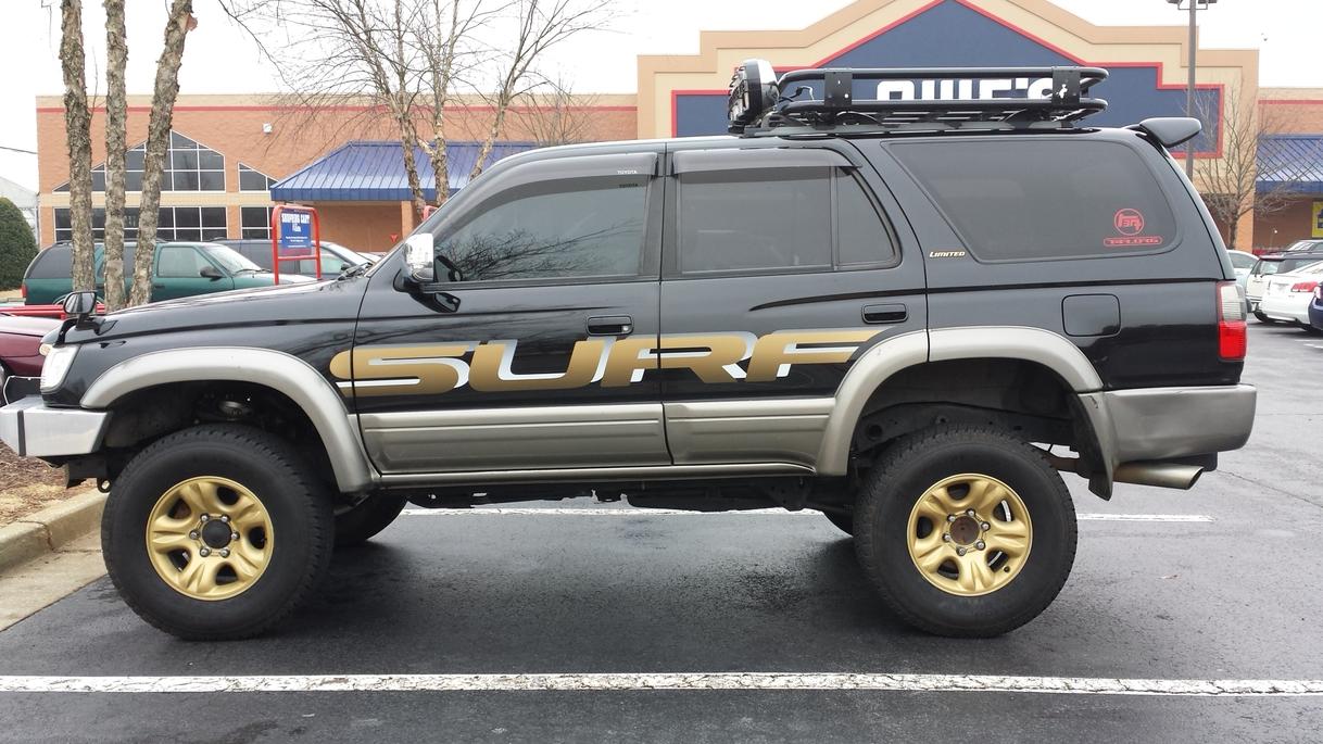

Maybe post a shot from the profile of the vehicle so we can get a better idea. Obviously the flatter the road that it's on, the better.

I've got the toytecs at 3" in the front and in the rear LC 8 wraps. Was a little nervous about rake too but honestly it's not that bad. Liking my current setup, it's finding the time to finish it that's the issue: tires, 1" lift, panhard drop:sad:
The new rear coils will settle a little over the next few months.
Also. most trucks are meant to ride a little higher in the back so when you load it, it doesn't ride nose high.
