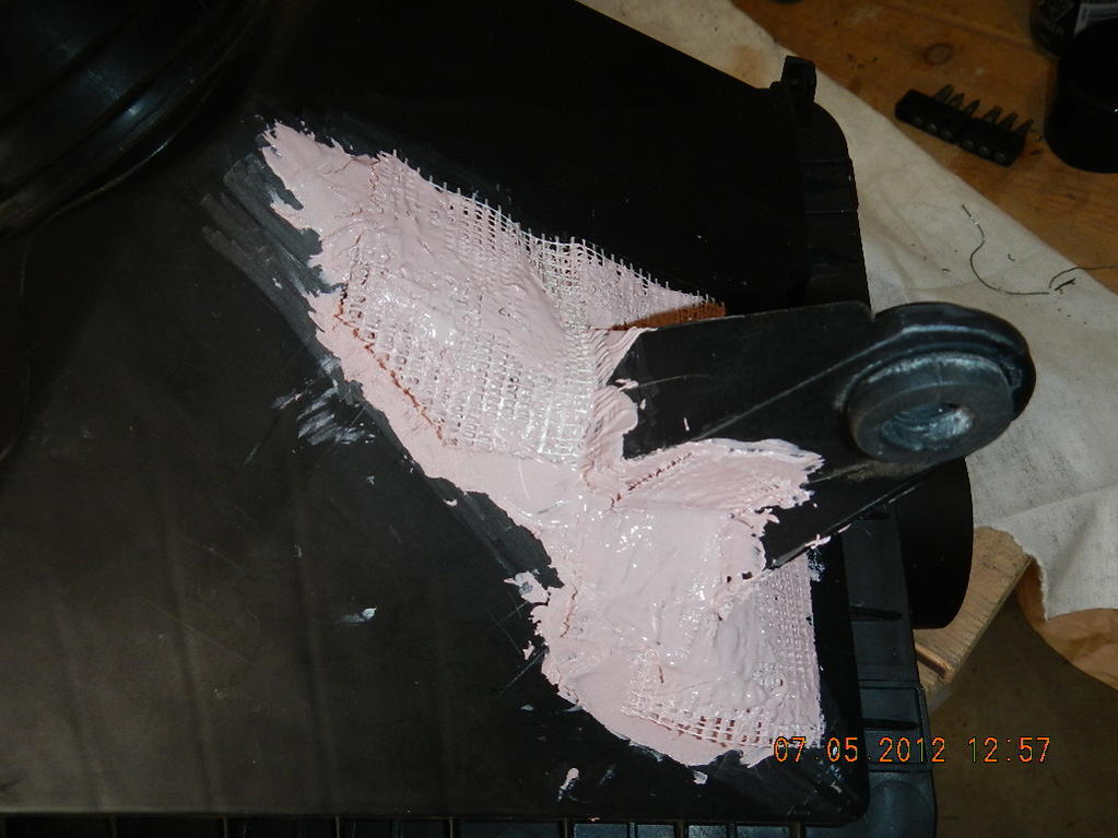

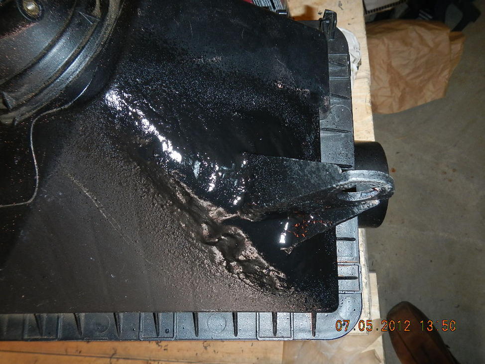

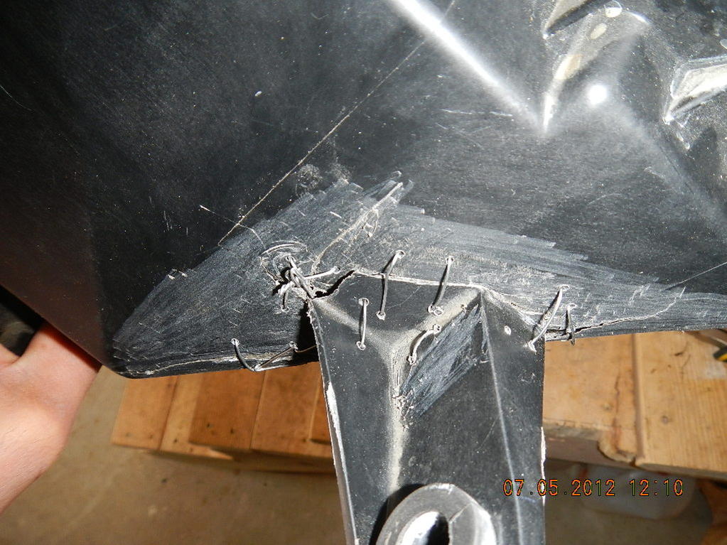

I had a crack in my air box but not at that same spot , I did some plastic repair and then sealed it up with some high build rubber coating , sealed it up no issues after, I'll go junkyard diving this summer so i'll grab one if i see it.:cool:
I used to get a wicked cool high pitch sound when I floored it but now its gone :/:hatsoff:

thanks. i used some super glue for now... probably won't hold long tho. if anyone has an air box laying around let me know. it kind of seems like the MAF sensor and the air box is one unit together... not sure if that's right.
