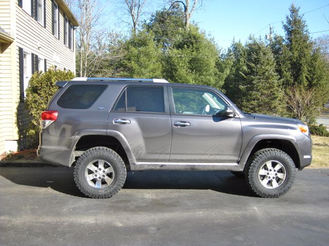

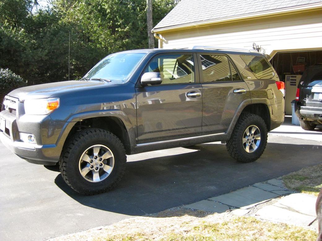

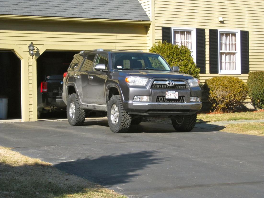

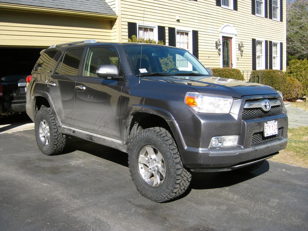

Finally got around to posting these up. Here is the current new stance.

Looks great. I just ordered the 2.5" kit and am looking forward to the same.
Do you have any rubbing issues with the 285's? I know that topic has been beaten up but figured I'd ask.
Thanks ArcticEd, appreciate it. As far as any rubbing issue, there is some when in reverse at full lock. Still, it is pretty minimal.
I chose to go with the 2.0 because I will not be adding any excessive weight (bumpers/winch).
I am really enjoying this set up. It has virtually eliminated any body roll and nose dive along with any wandering issues at highway speeds. It is a very stable ride.
You will not be disappointed with OW.

Nice. I like the stance. Are you running spacers? And I'm surprised you could get 285's on the stock rims. I thought they wouldn't fit on a 7" rim?

Davemon- Thank you. As for spacers, I am not running any. I've talked with others about them and have heard more negative responses about using them. They cause a lot of shake I'm told. As for the 285 Duratracs, they fit fine on the stock wheel size. I know it wouldn't hurt purchasing a set of wider wheels for them. I do have some slight rub only in reverse at full lock.
CBIELAT- Those are some great looking tires on your rig. It looks nice. Have you noticed any drop in MPGs as a result of those tires? if yes, how much?
ChetJ- Thank you. Before I had the lift and tires installed, the computer was averaging 20-21 mpg's. Now the computer is reading 19.8 mpg's. It's not too bad but I did however notice the gas gauge does drop faster than before. I am also not a fast driver.

So I'm assuming that the aftermarket UCA's were necessary then, to prevent the wider tire from rubbing the stock UCA's?
Davemon- You can use the stock UCA's but aftermarket UCA's will help with the alignment a lot better from what I had researched.
So, did the tire shop give you any hassle about the 285s on a 7" rim? I saw Tirerack has the minimum rim width as 7.5 on most of their 285 tires. Wondering also about safety, and the likelihood of popping a bead when offroading with a narrower rim. Any insights you, or anyone else, may have would be welcome. I'd love to save some coin on rims this summer when I upgrade, but only if it's not a safety issue.
