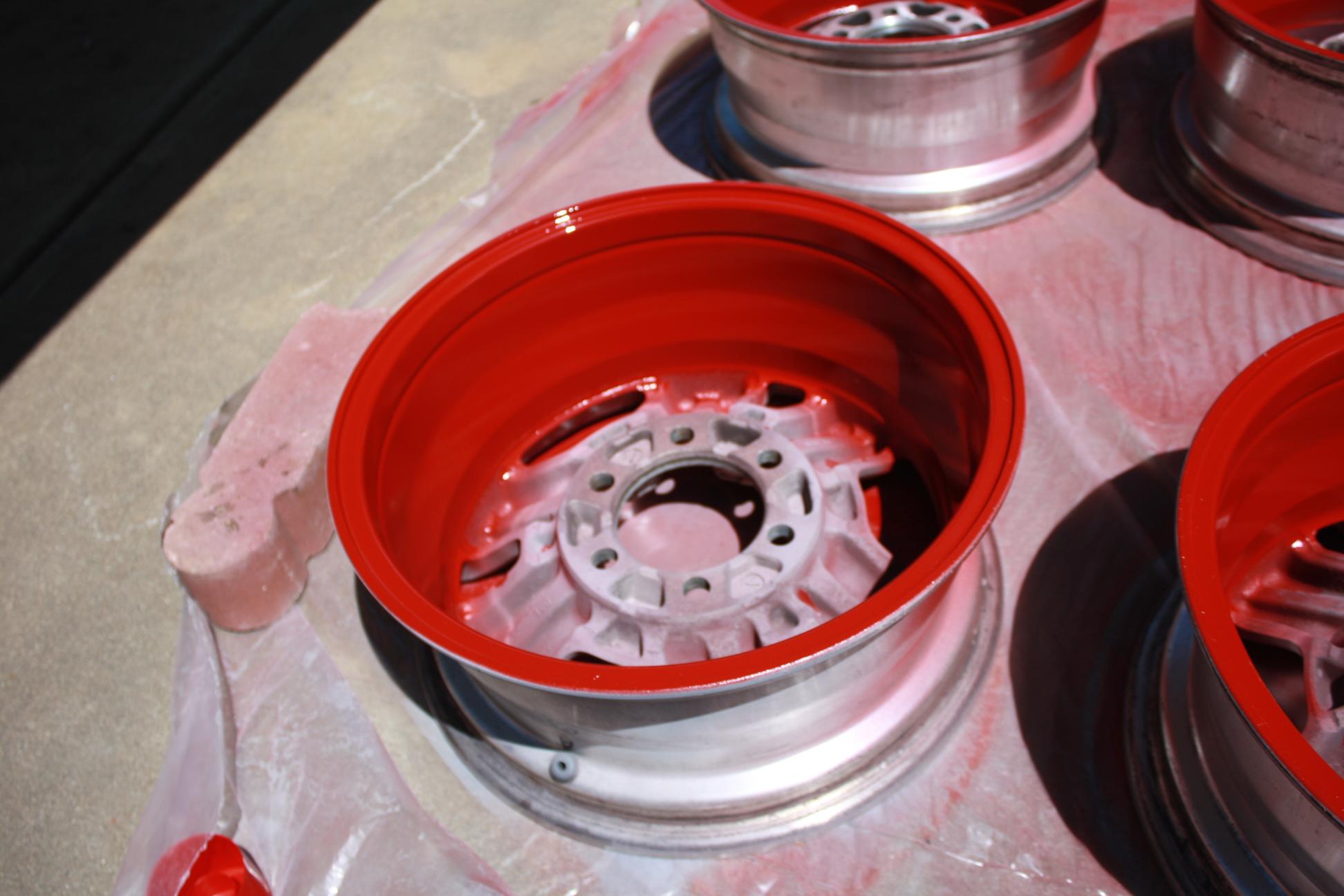

So, I decided on a red & black theme, as that is what I have been going with on my rig lately (Black SR5 with red accessories, at least). I decided to paint the inside of the wheels red, as you can see them sometimes.

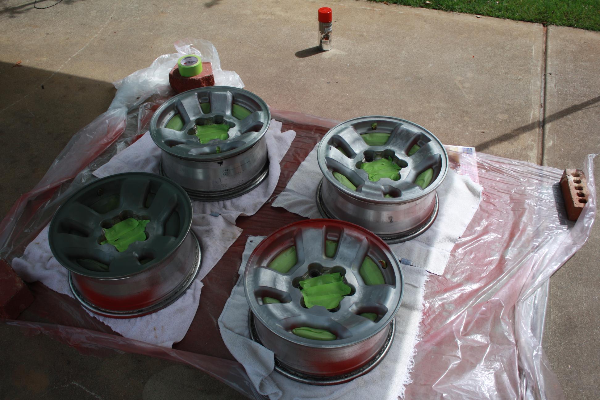

I started to paint the outside of the wheels red...

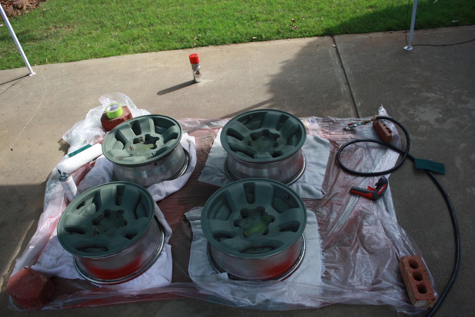

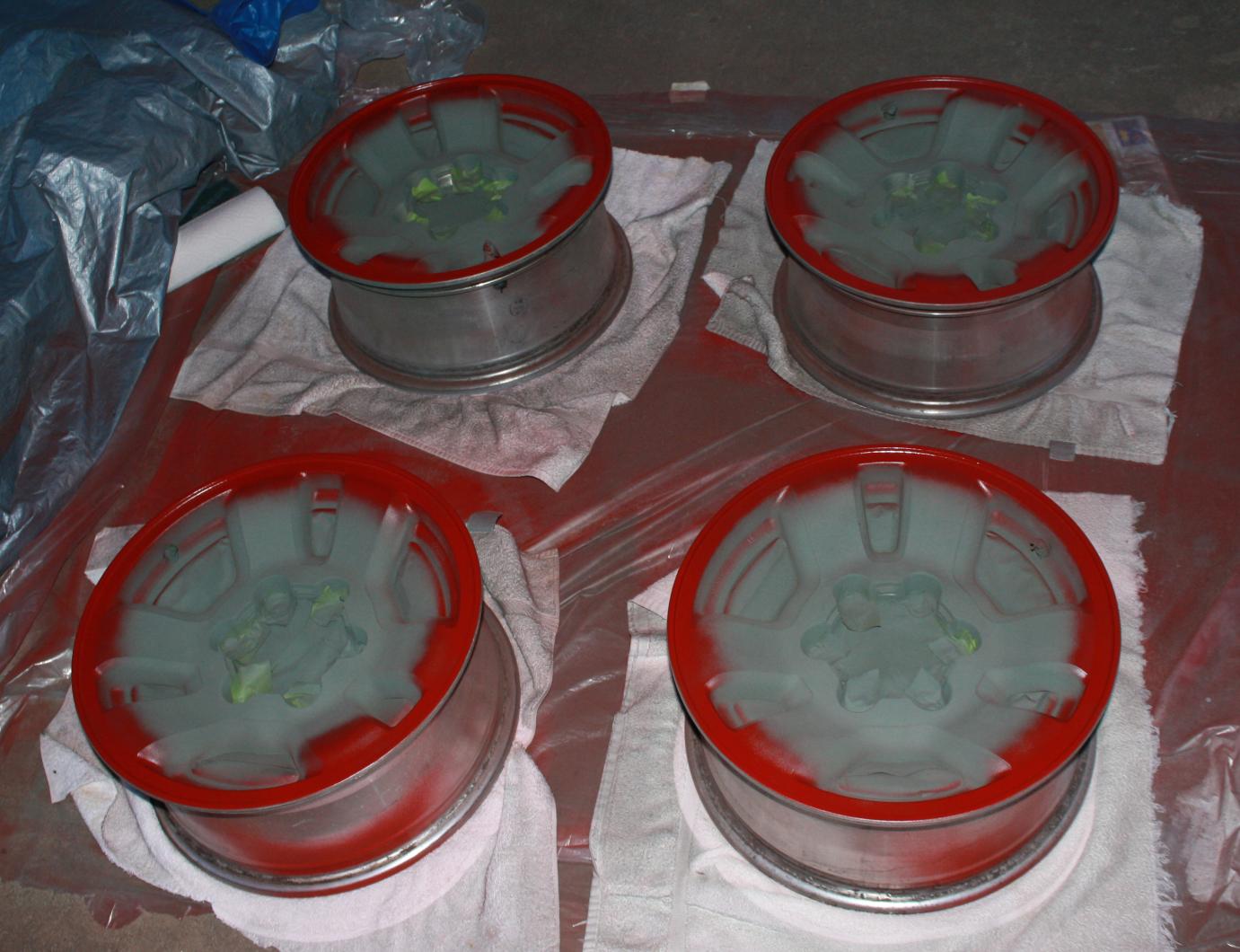

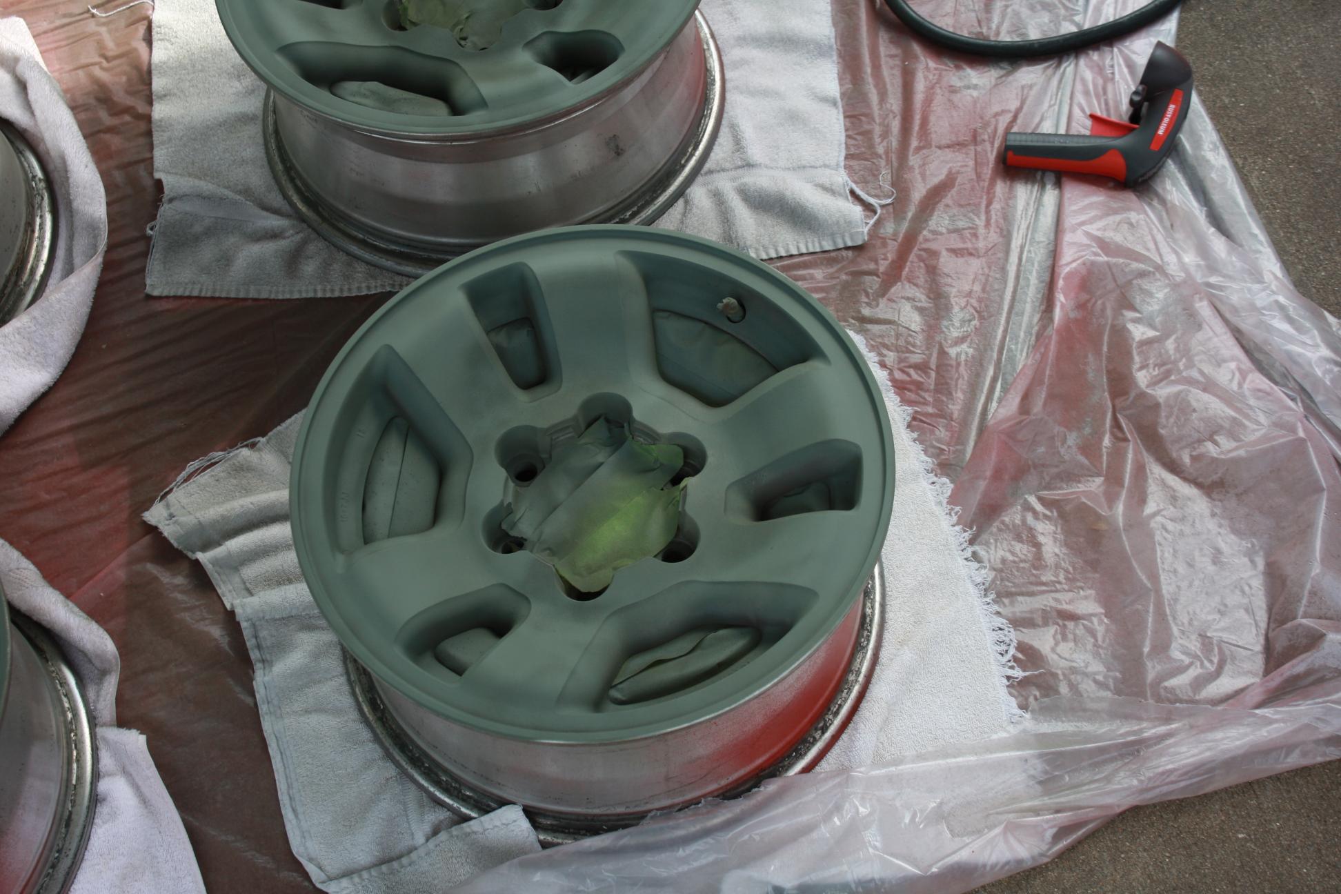

but, then I remembered I needed to prime first...so...I did that.

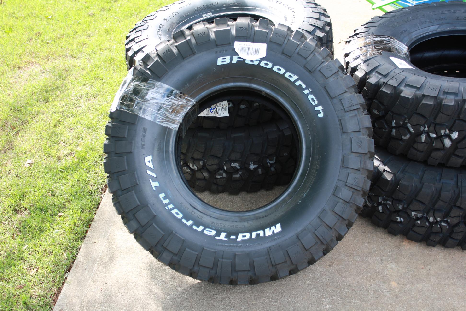

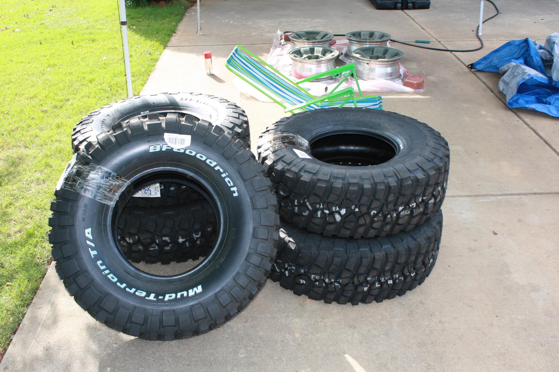

Ooooh...and look what the UPS man brought me!
And, then they sat in my garage for a while, as I finished the wheels.

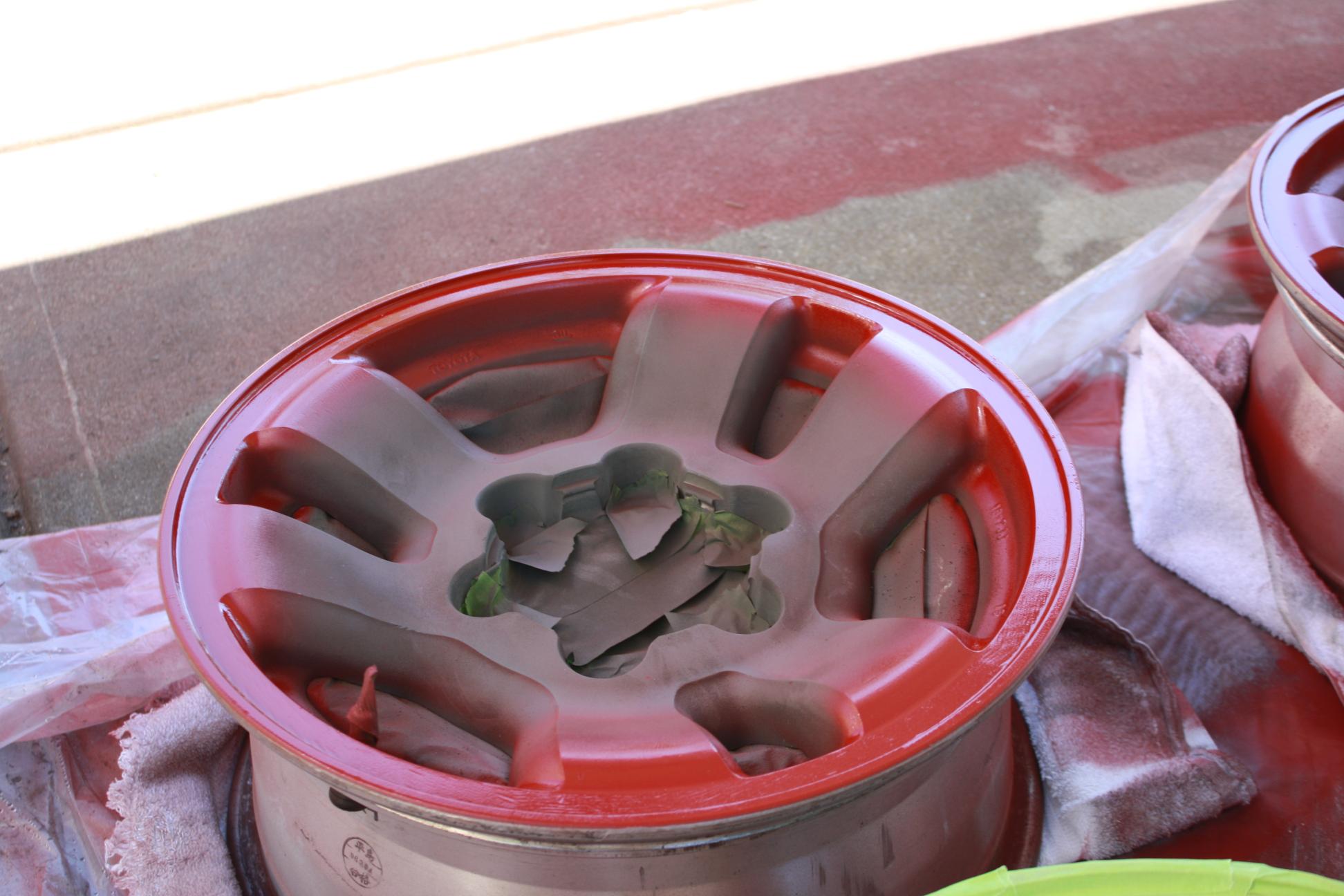

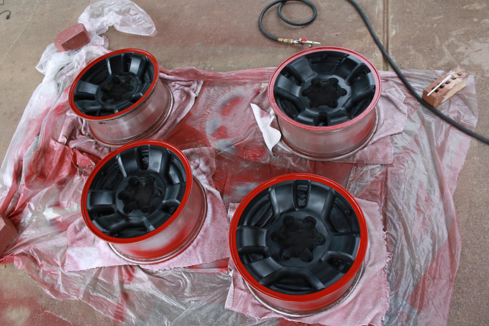

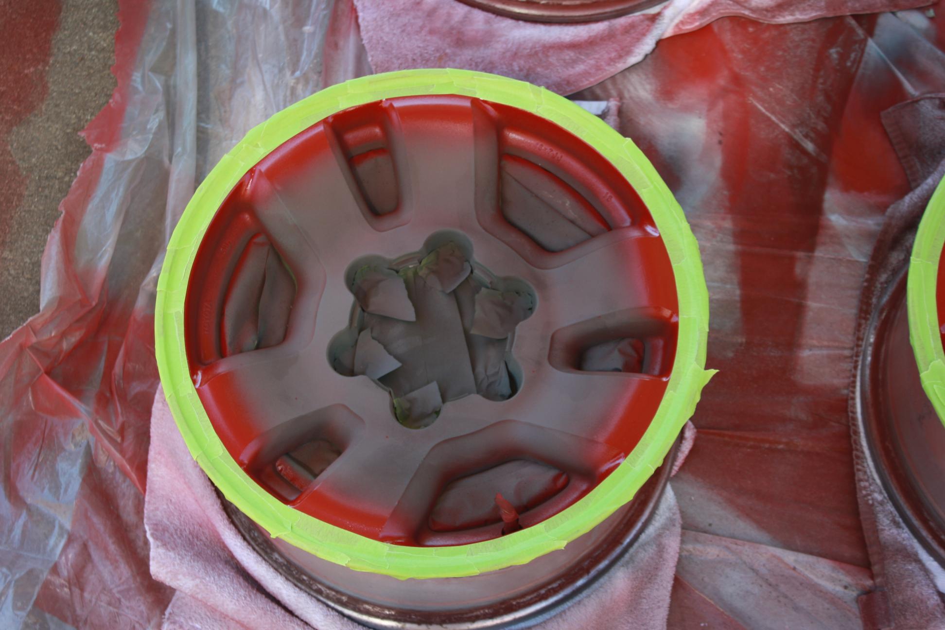

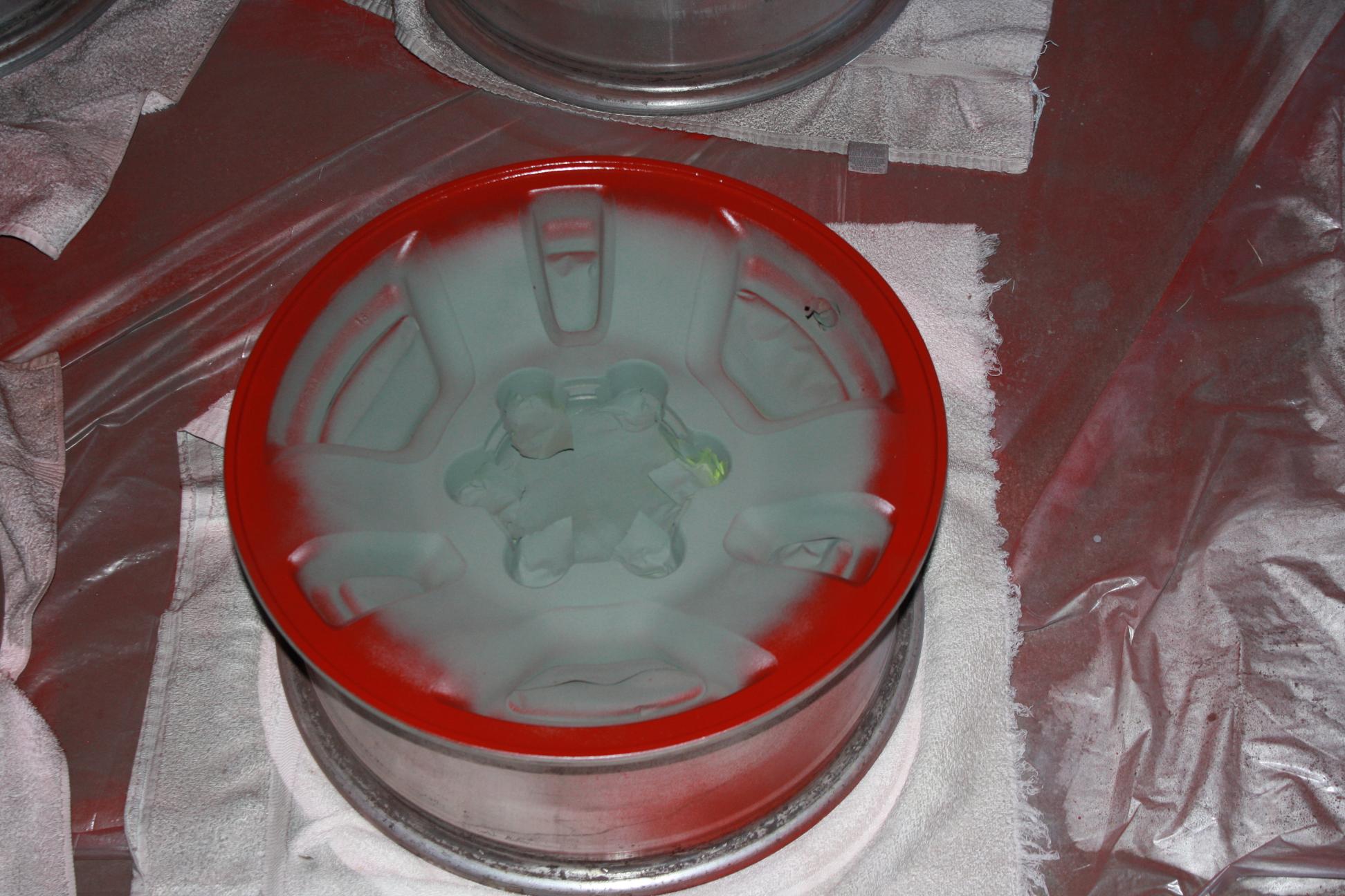

OK, now that they were primed, I put the red on the outer rims of the wheels. A LOT of coats...I lost count.
Then, I meticulously taped off that outer rim. I tried to keep the radius correct in the spots where I didn't have an edge to work with.

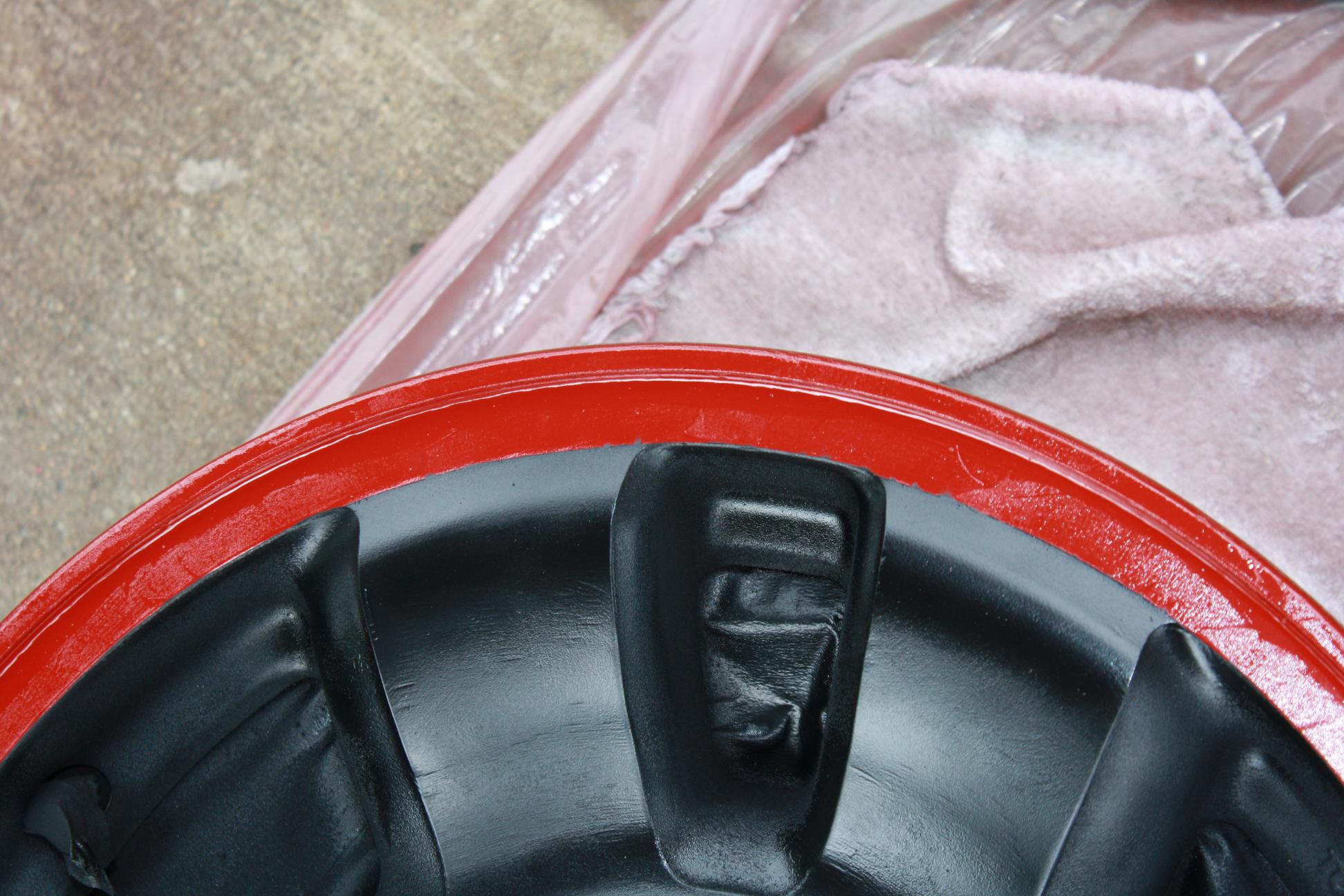

OK, where was I? Oh yeah...

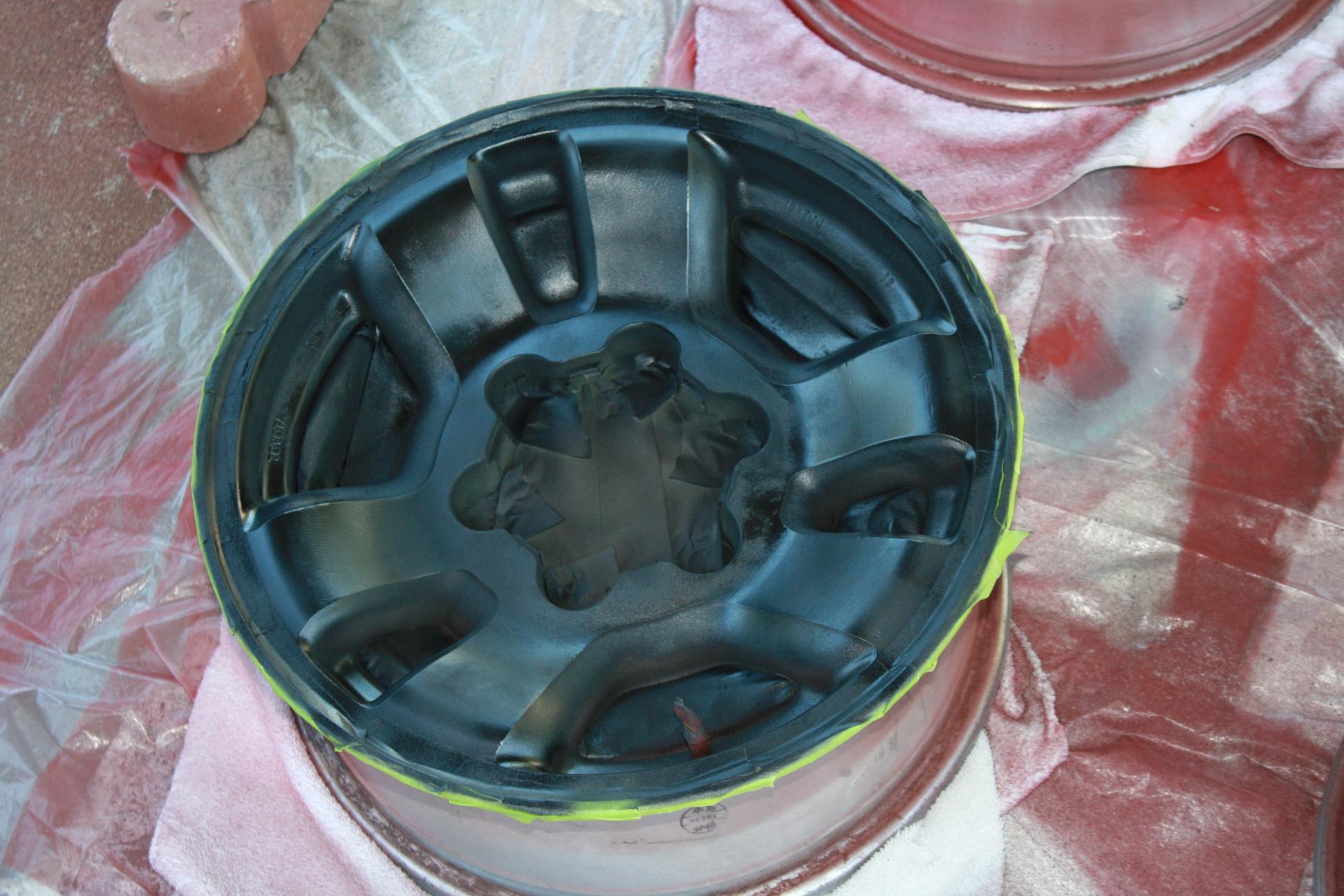

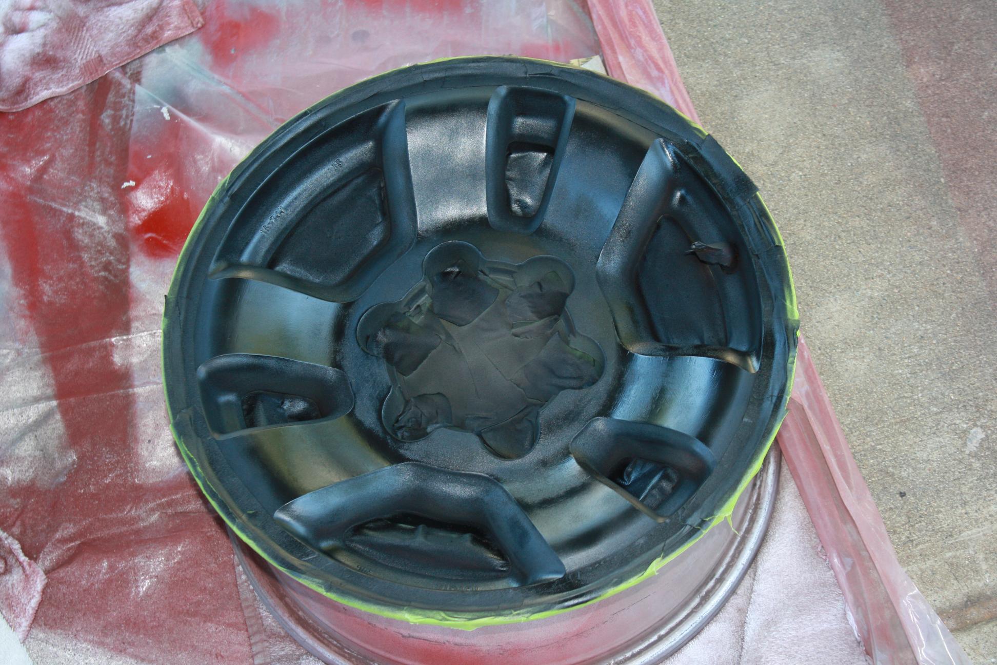

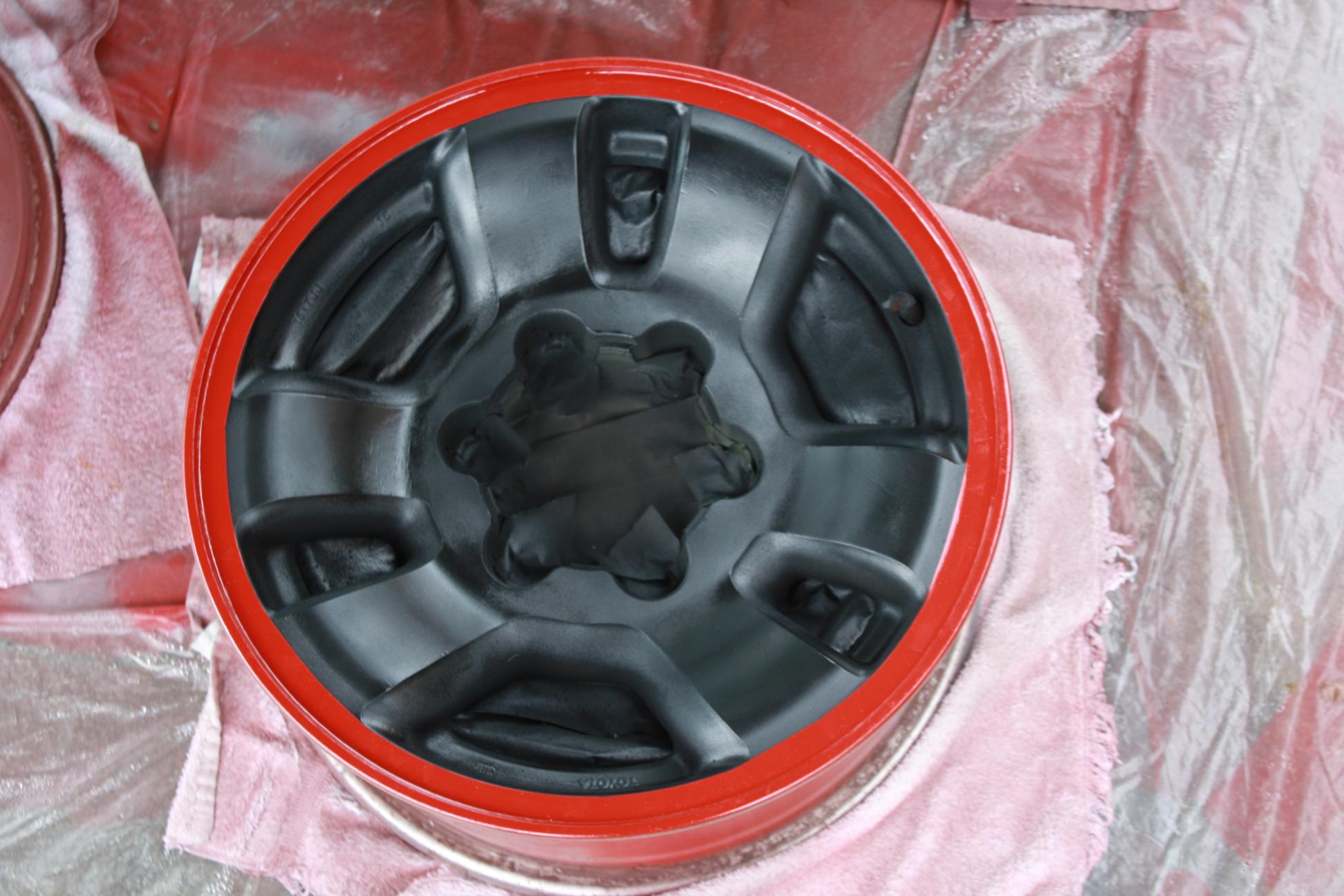

The black!!
And, tape removed! Turned out pretty good. I had a little black bleed-through into the red in a few spots, but not too badly. I really didn't let the red cure long enough, and you can see the tape marks on the red, but after I cleared them, you could not see it at all.

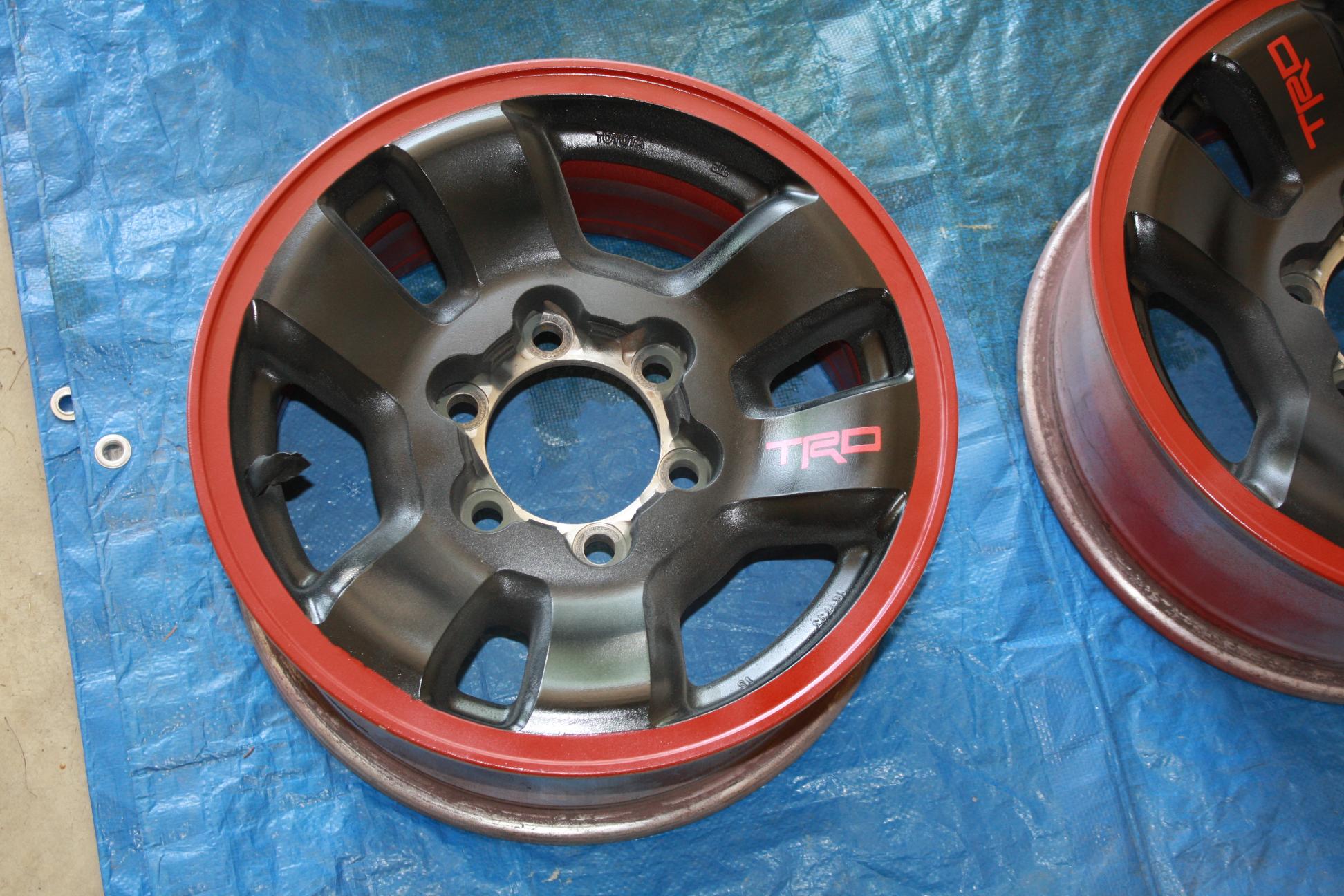

And, with the TRD logos applied! I got these off of Amazon from a seller named tomkoz. I didn't realize at the time they were coming from SWEDEN!... but they got here in less than a week, so I really couldn't complain. They seem to be high quality.

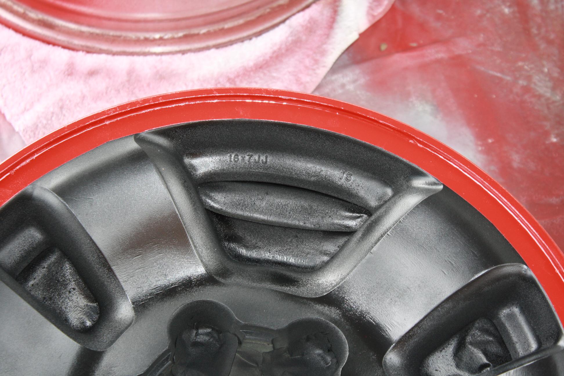

OK, confession time....

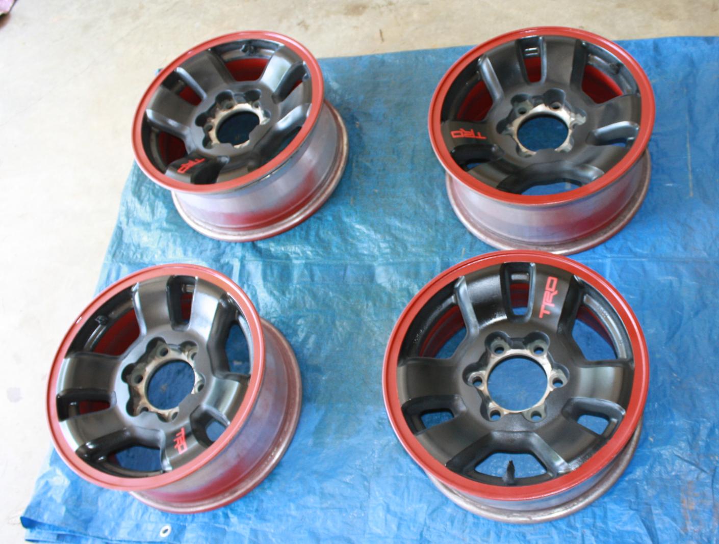

AFTER I put on these logos, I realized that inside the curved parts of the wheels, the primer had gotten a texture to it, and I didn't sand it down. So, the paint didn't stick in those "textured" spots. So, I ended up taping off the red (again!), although this time I just fudged into the black some. I also covered the TRD logos, although I didn't do this ideally, as you (well, me) can see the outline of the tape around the logo if you look closely.
I was happy, though. For about $50-$60 worth of paint and supplies, I think it was worth it.

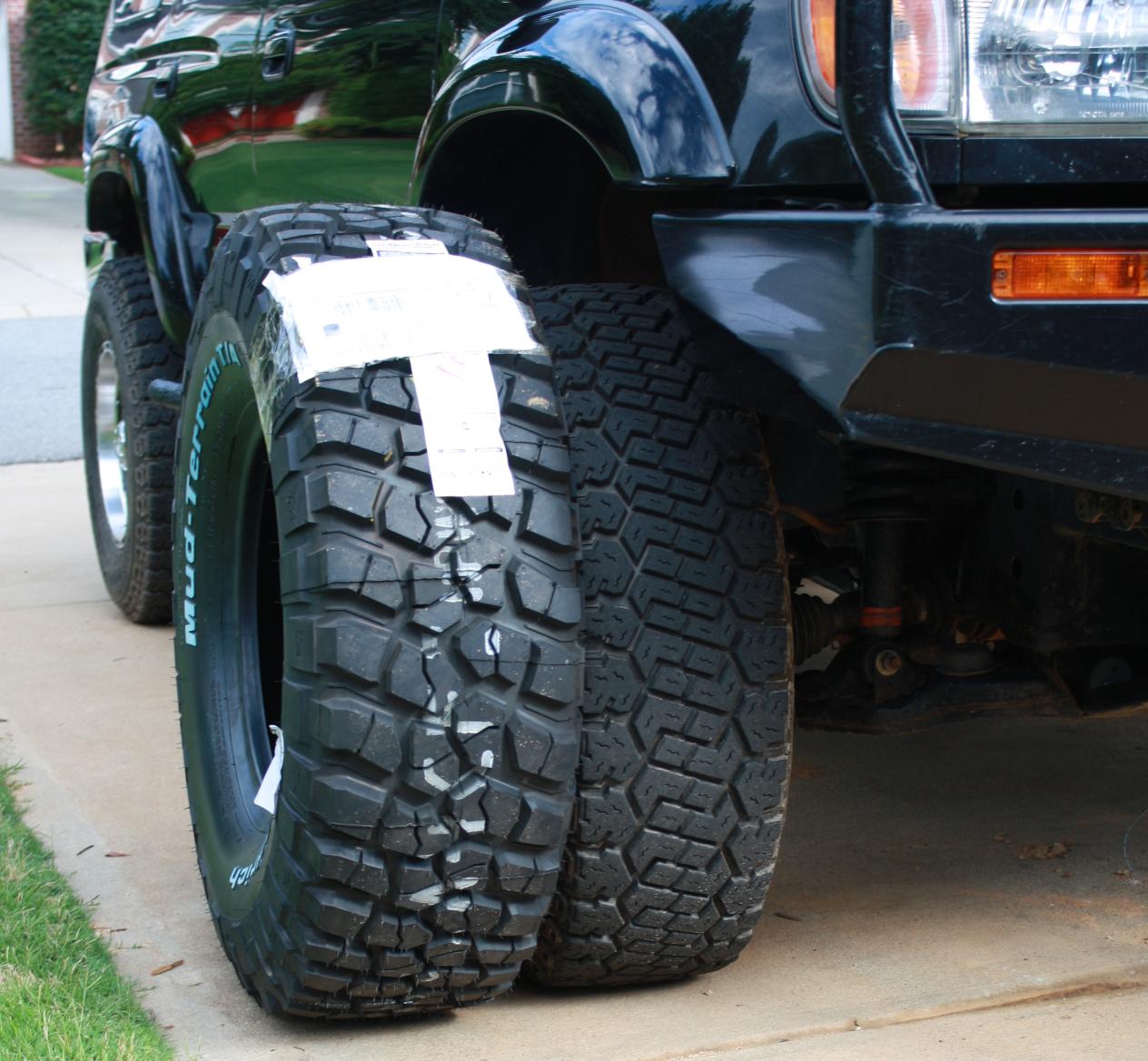

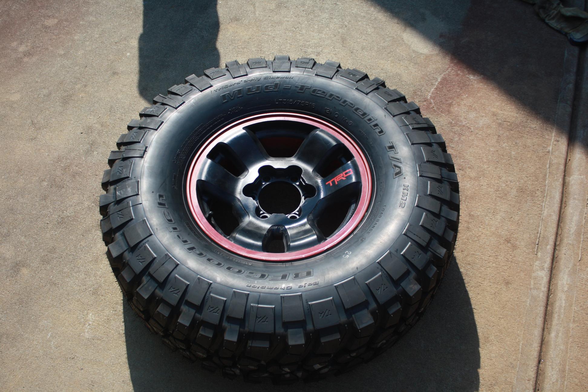

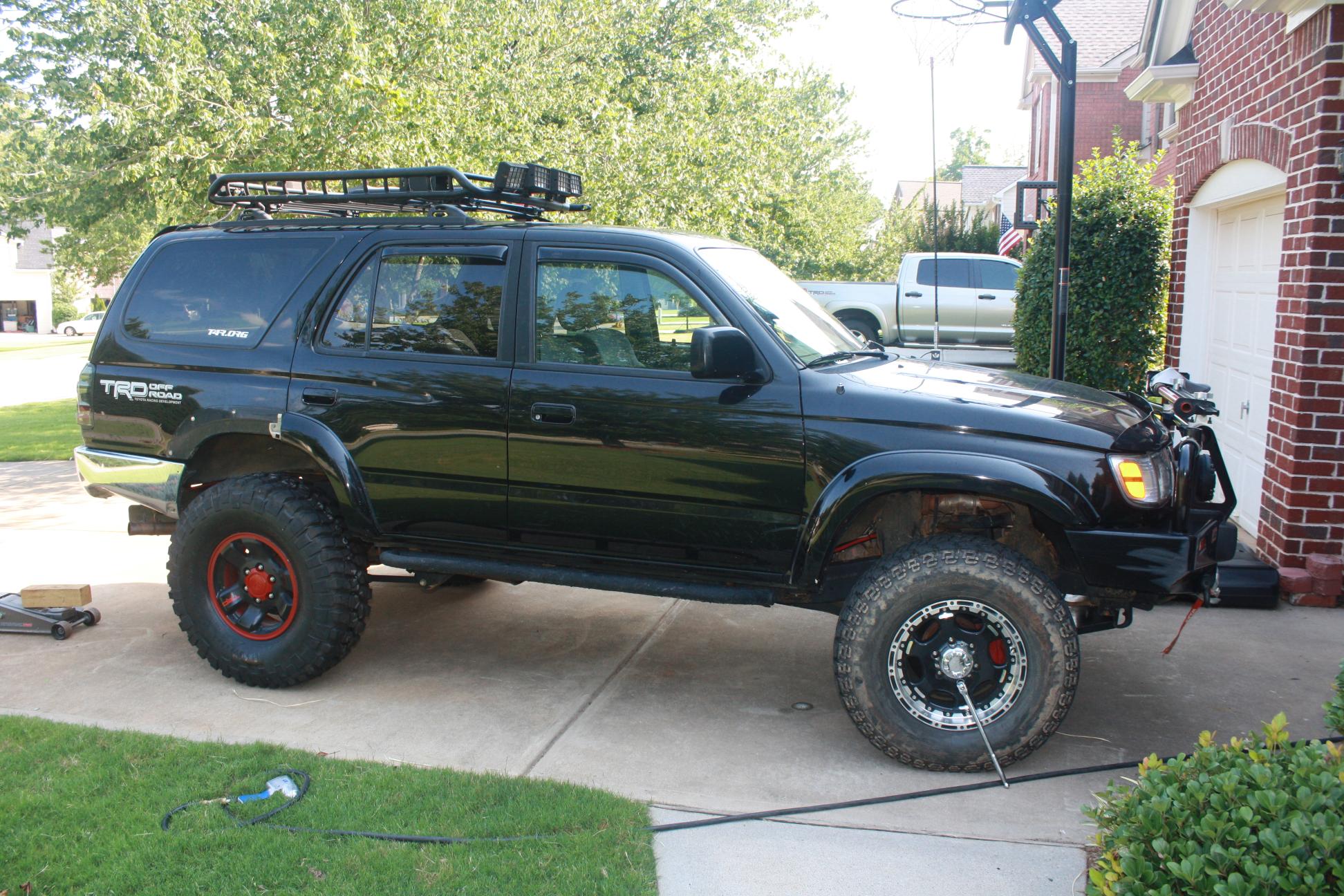

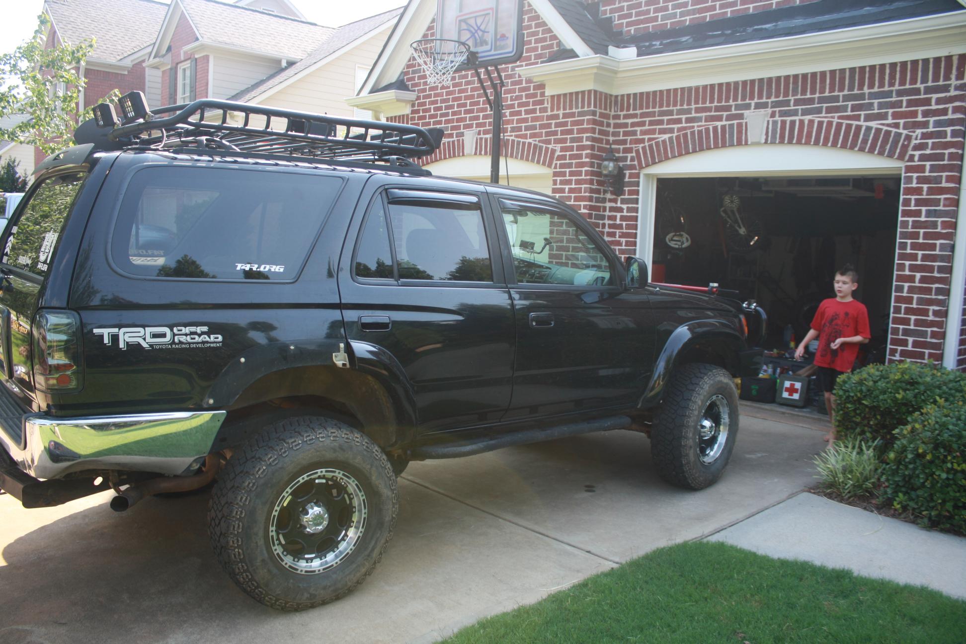

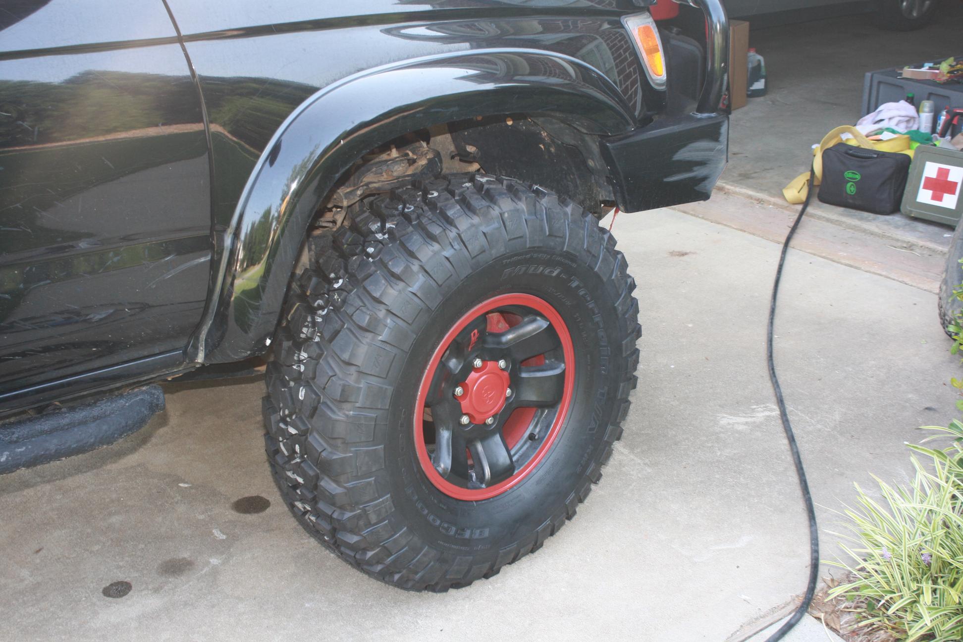

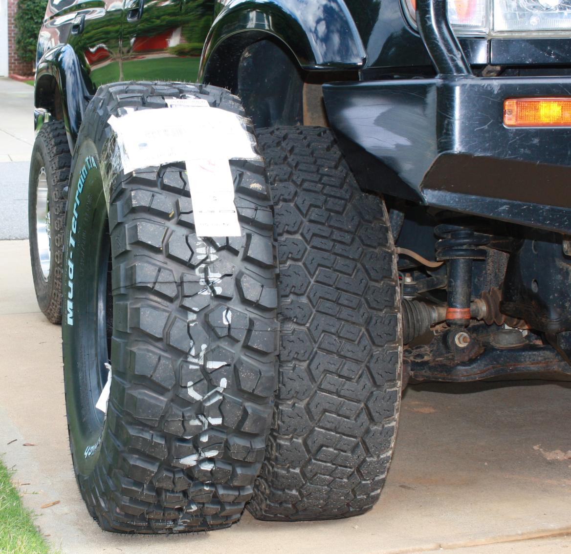

And, I then found a tire shop that could mount the tires without touching the front of the wheels, as I am worried about how much they can withstand. And, I got them on the truck yesterday! Then, spent a few hours (it was hot...I took a lot of breaks) grinding and cutting to get them clearanced. Probably still need some work when the front is flexed, but can turn to full lock without touching on flat ground. Yay! We'll see how long they hold up. I already took a nick out of one taking the fronts on and off while clearancing. Oh, and I f-ed up a spacer lug not yesterday, too...that was fun. I will try and get a replacement lug next week. I always manage to break or mess SOMETHING up while working on my truck.
One shoe off and one shoe on...or something...
Passenger side with the old wheels & tires (Dk Cepek FCIIs on Helo 842s)
Passenger rear
Oh, and I knocked off the fender flair taking one of the tires off of the roof at the tire shop. Yay me! *bash*

You obviously have no concerns with putting a 12.5" wide tire on a 7" wheel eh?
Can't hardly wait til the 5th gen 7" wheel police see this :lmao:
Looks good! I like the black/red two tone :thumb3:
I had "some" concerns, but I've seen many 8" wheels with the 12.5" tire, and I talked to a TTORA buddy who did 7" wheels and hasn't had an issue. I will keep you posted!
I like the look of the paint job--very creative design. For the record, a 7" rim is well below the minimum width recommended by BFG, and it will distort your tread pattern and wear unevenly. The truck looks great with the painted rims and tires--some red on the various accessories (roof rack, armor) would really tie everything together (just small amounts, like striping). Just an idea...
Yes, I have been debating on painting the entire roof rack red. I already have the red axe & shovel, but the paint has faded from the sun, and looks kinda pink now. I might paint more of my high lift red as well.
I will keep an eye on the wear on the treads and keep you posted! Hoping for the best!
Good job on getting creative with the paint & meticulous with the taping...it turned out well! And about the odd wear with the 12.50 on a 7" wheel...if you see some wear you don't like in a couple thousand miles, you can sell your old wheels & tires and buy some wider wheels to correct the uneven wear.
