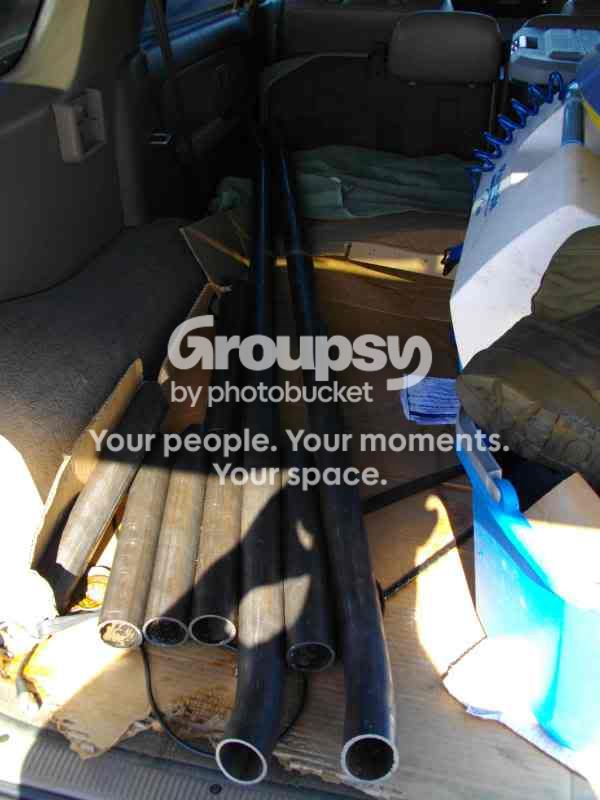

looky what I picked up today:
IMGP0029.jpg~original
gonna weld them on this weekend!
I had a offroad shop cut and bend the pipes for me since I don't have any of that gear and I want them to look decent.
yeah I like personally doing and knowing what all goes on my 4runner, gives me a lot more satisfaction. I don't even know how to weld :cool: My buddy does though and he's gonna show me how.

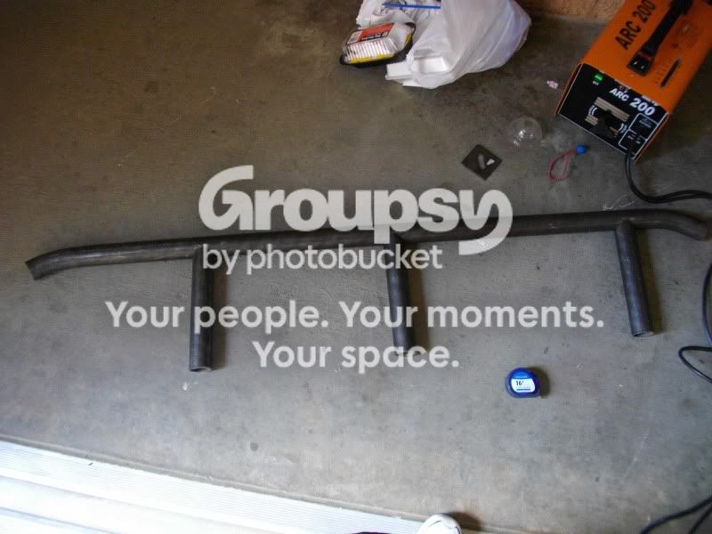

measured out where each support arm would go:
IMGP0036.jpg~original

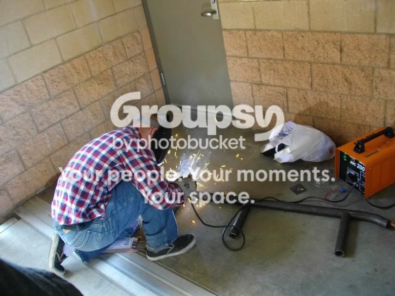

welded those on:
IMGP0037.jpg~original

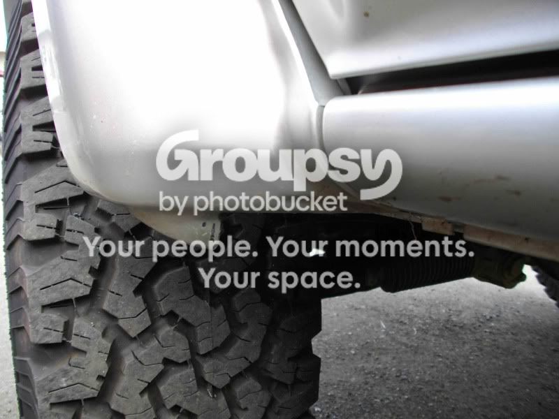

also dremeled out part of each front fender flare so they will look nice where they curve inward:
IMGP0038.jpg~original

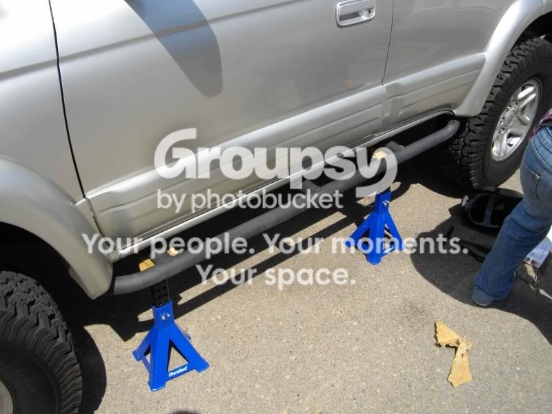

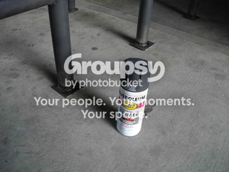

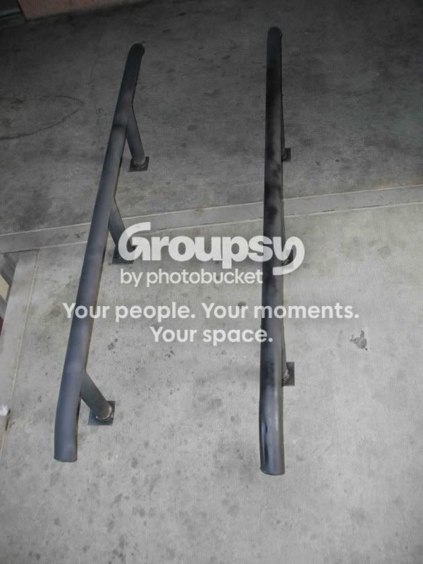

finished up the passenger side slider today, am now painting them flat black, its a primer but I'm not sure if I'll put another color one top of that yet. They are going on tomorrow!
IMGP0040.jpg~original
IMGP0041.jpg~original

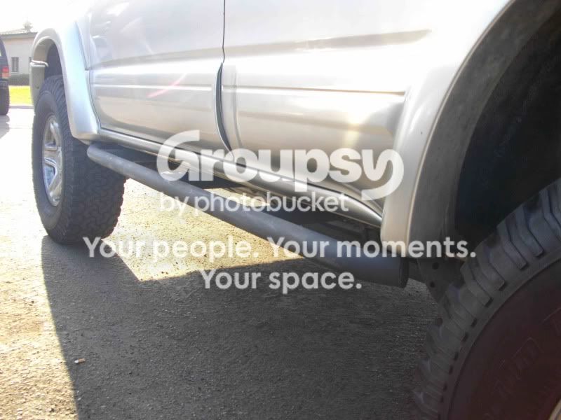

they're on

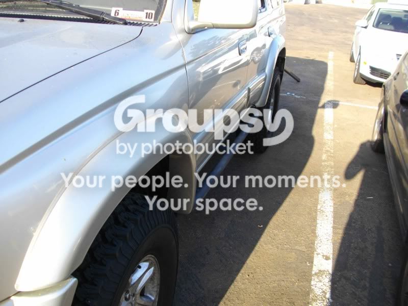

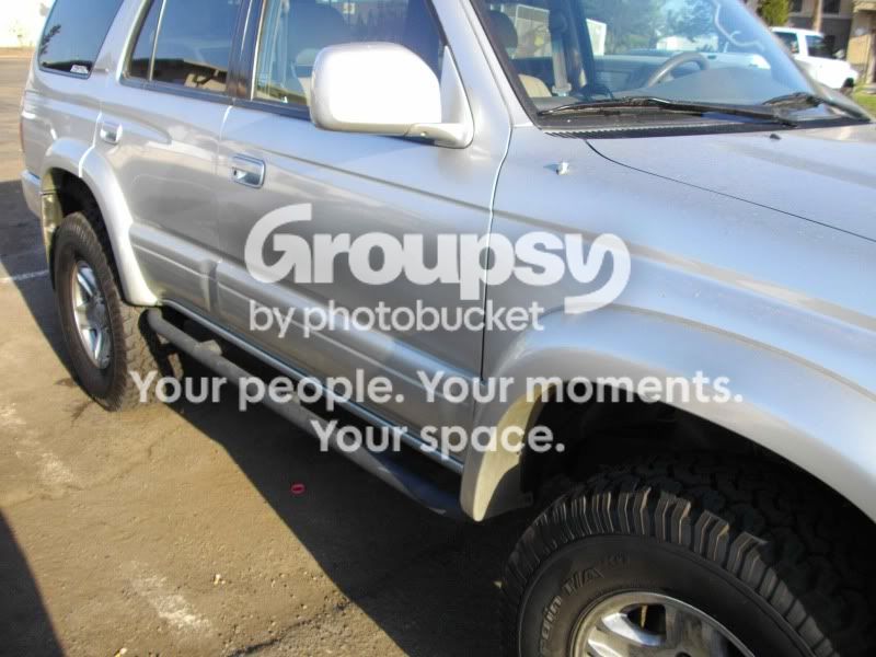

found the time to weld them on today, I think they turned out pretty nice, and they sure as hell ain't ever gonna come off haha...:D
IMGP0042.jpg~original
IMGP0043.jpg~original
IMGP0044.jpg~original
IMGP0045.jpg~original
overall this was a great project, got me into welding and home fabrication, really cool stuff.

racedirt1 said:
I would have your mounting plates larger and used some gusset's. It looks good though.
you mean put gussets on each support bar where they meet the main bar? I didn't really see the need since the majority of the stress will be vertical from rocks pushing up or people standing on them and pushing down.
and those mounting plates are about as big as I could go, they take up most of the side on the chassis frame.
These are the pic's I am talking about. Larger mounting plates with gussets.
