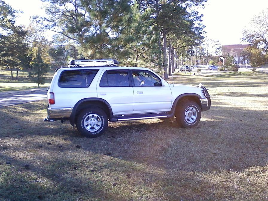

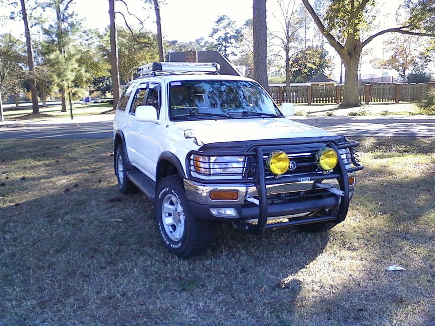

Finally got the grill guard and 8 inch fog lights on. Had a busy day with my car.
Thanks.
Right hand driving Surf has the fender mirror on the left fender. The fender mirror is used to see the edge of the front over fender. It really helps at parking in a narrow parking space.
Nice looking bumper, wish mine had the cutouts for fog lights!
One question, why choose yellow driving lights over clear? Also what do you think of those units, weren't those the ones you bought on ebay?
The front lower fog lights came from Suzuki Verona. I made the cuts in the valence. Make a template and cut the valence (use a jig saw), simple as that. I then used L- shape aluminum to mount the lights.
The main driving lamps is bright enough for me. The fog (yellow) lamps are for fog conditions. Yes, they are the ones I bought recently on ebay.
