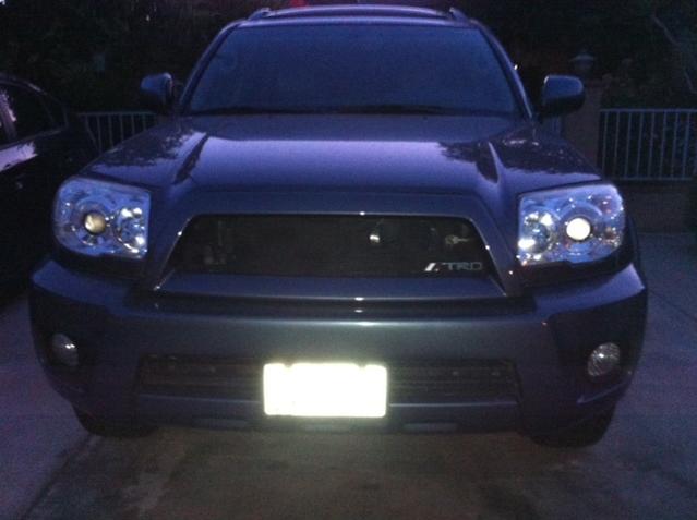

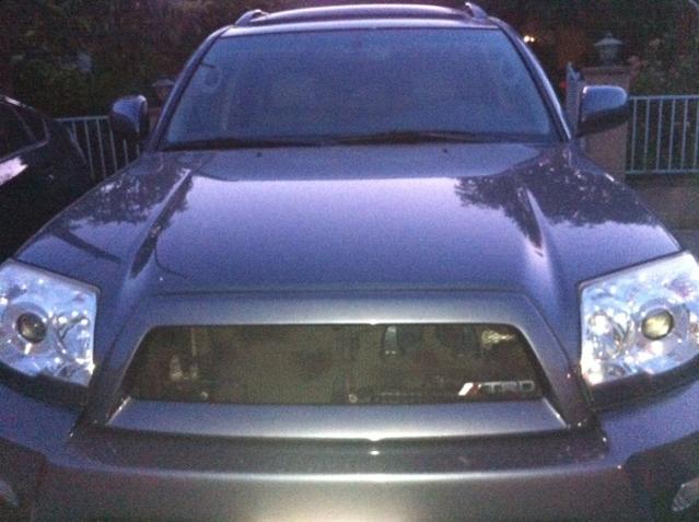

This is exactly what I did to mine, but I have to keep the front plate in CA---it's hard to see the mesh at the bottom but it's looks really good---I just need the sport hood with scoop and to do the headlight blackout and it will be perfect then!
My truck is the same color as yours, so this should show you what it will look like if you color code the grille to the truck.
