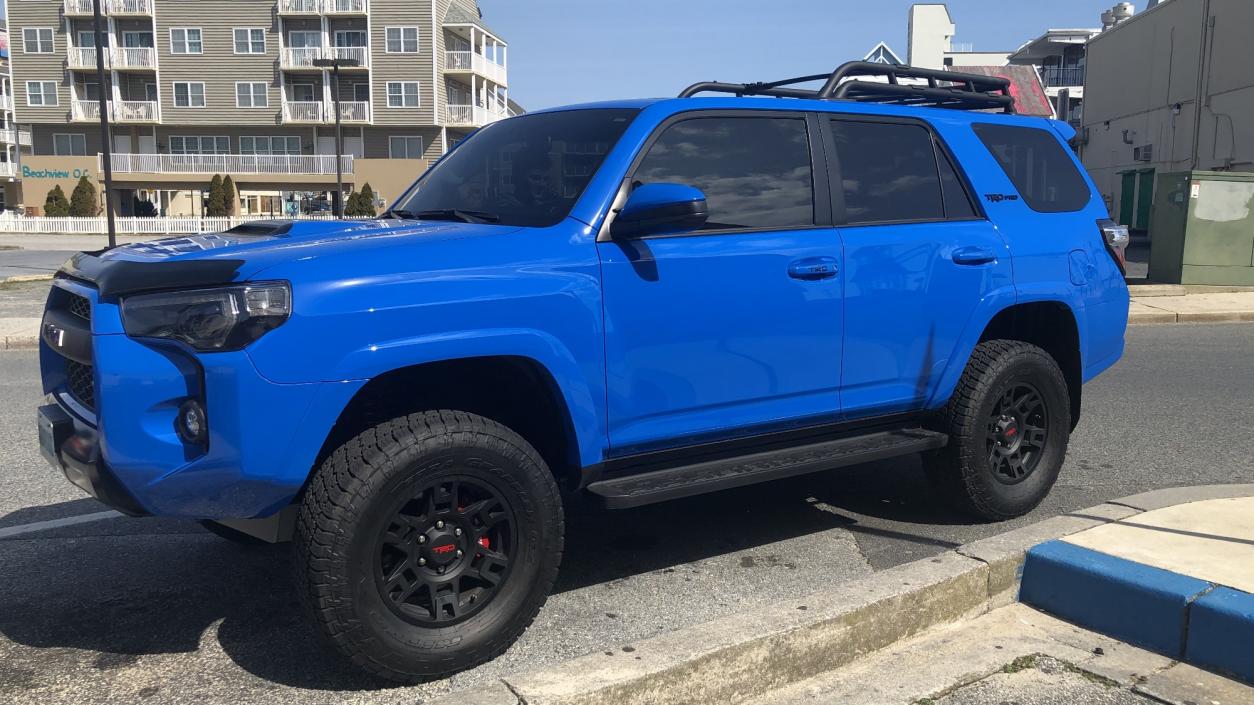

My TRD Pro Lift
Ride quality with my 3/2 set up is great, so far. The off-road shop who installed the kit is confident the set up with the stock suspension is fine for my intentions. Will not be rock crawling, but normal road use and light off road will not over stress the components. I did replace the UCAs. Time will tell and I did do some research prior to making the 3/2 decision. I respect everyone’s opinion and value their input. If or when I start having any issues, I will be sure to post those issues so others can learn from my experience. As of now, I am enjoying the ride and look.

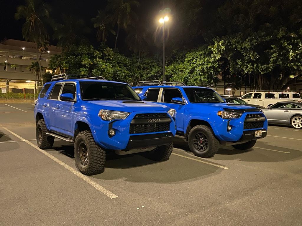

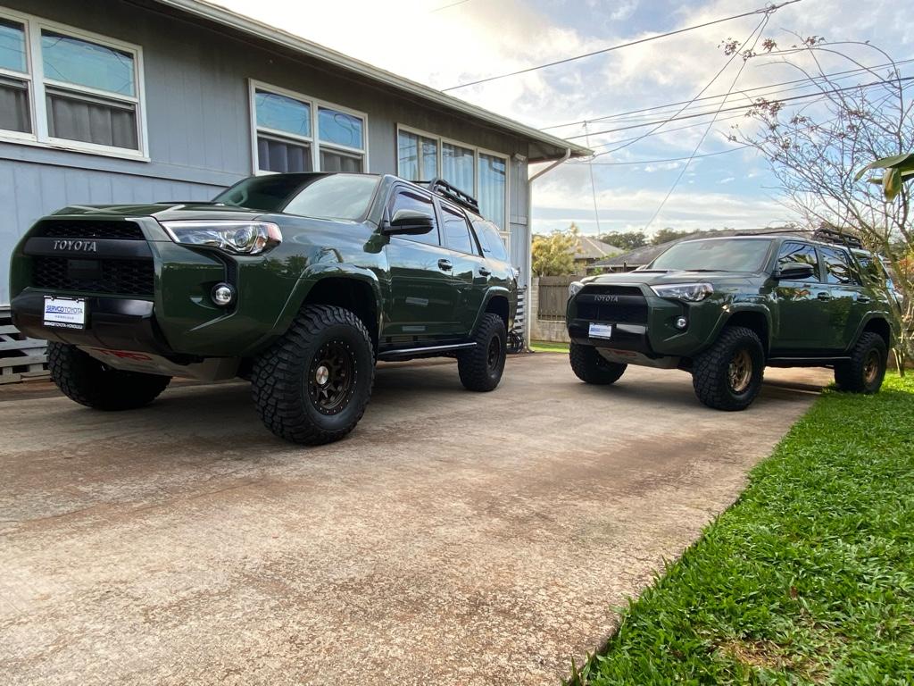

Also wanted to add that I’ve traded in my 19 in Voodoo Blue for a 20 in Army Green.
I ordered a 2/1.5 kit directly from David [MENTION=7943]Cornfed[/MENTION] and saved a bunch off of other websites.
The 20 with the revalved shocks ended up being a little stiffer, but it’s still livable.
Am I see double AG's in 1 driveway! WOW. I better lay off the Corona's!:bluejump:

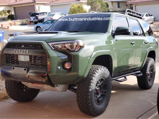

This forum keeps reducing the size of my photos but here’s a 2.5/2 on army green! Again, I probably have photos on every color 4Runner made so just text me if you’d like to see more.

I'm sure Jason Burtman knows that the 2019's and 2020's sit up an inch higher. Even with them sitting up higher, he says you can still add 2.5" to a 2019 to 2020 without changing the UCA's and still get it aligned to correct specs. In the future I will be adding UCA's, but want to save the $600 for now.
