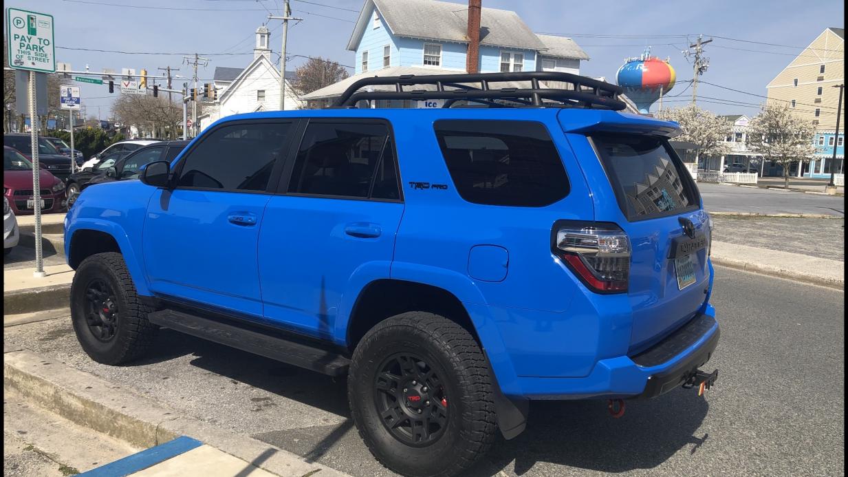

I wanted to pass along a BIG thank you to the forum members. I have been monitoring the site soaking up all the knowledge and experience concerning the 4Runner. I have a 2019 Voodoo Blue TRD PRO and have been struggling on what to do regarding lifting it. I did not want to burn $5700, quote I got from a 4wheel shop here locally, to add a ICON Stage 5 suspension to get my desired look. Not off roading this 4Runner right now. I have 2007 Voodoo FJ for that.
I have been following the threads about Burtman Industries for awhile and due to everyone’s overwhelming positive experience and happiness with the outcome, I pulled the trigger and purchased 3/2, UCA, DIFF drop, and Sprint Boost set up. I was AMAZED by Jason’s availability to talk with me. I texted him on a Sunday night at 2200 hours! He responded almost immediately and asked if he could call me! What the hell? What vendor does that? It’s Sunday night! We talked for about 20 mins. I have continued to text him all week, boarder line harassment on my part, and he continues to work with me and answer all my questions.
The plan is to drive up to PA, I live in Maryland, and have a shop he works with to install the lift. Can not wait! More to come.

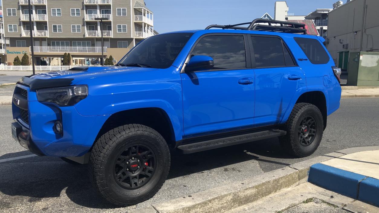

Hey, just wanted to pass along some feedback concerning Burtman Industries and Jason. Awesome experience! Jason talked me through some ideas and helped me pick the best set up. I am extremely pleased how my 4Runner turned out. I went with a 3/2 lift, SPC UCA, diff drop, 285s, and Sprint Boost. Wow, it looks awesome.

Also wanted to add that I’ve traded in my 19 in Voodoo Blue for a 20 in Army Green.
I ordered a 2/1.5 kit directly from David [MENTION=7943]Cornfed[/MENTION] and saved a bunch off of other websites.
The 20 with the revalved shocks ended up being a little stiffer, but it’s still livable.

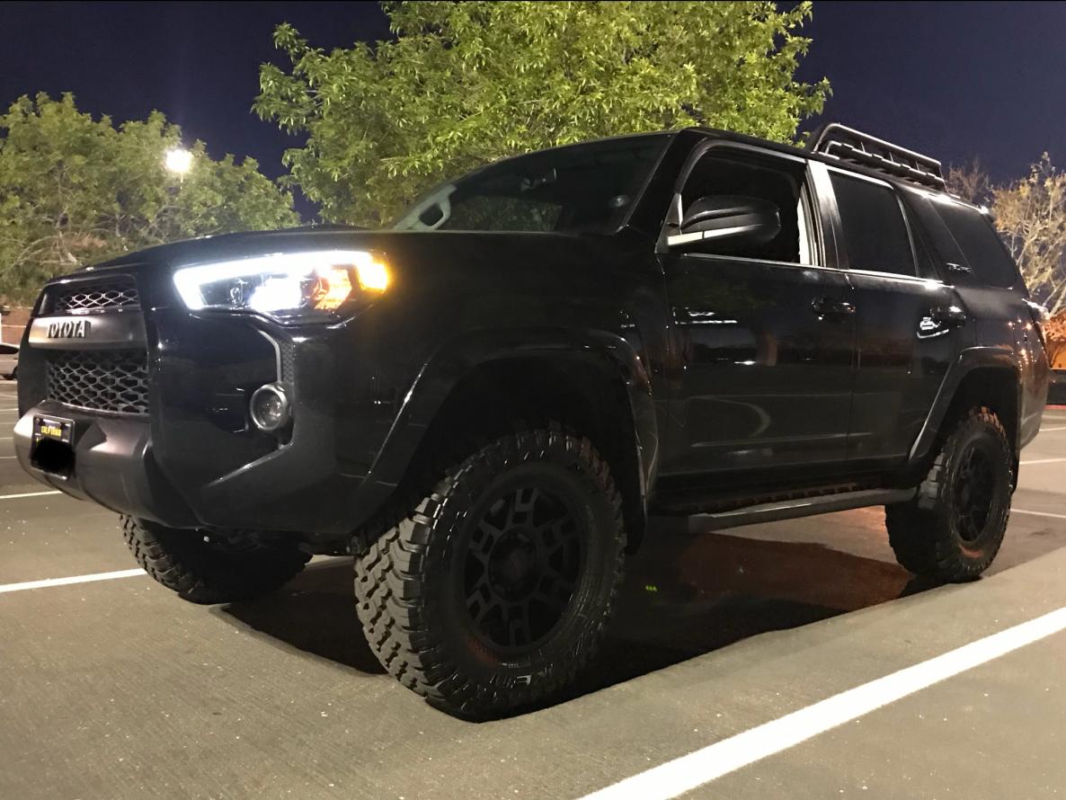

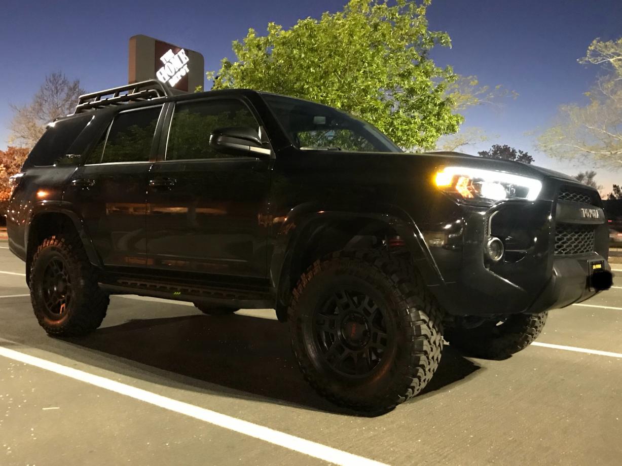

Went with the 2/1.5 Cornfed Spacer kit on my 2015 TRD PRO suspension. Couldn’t be more pleased with the look and ride quality.
