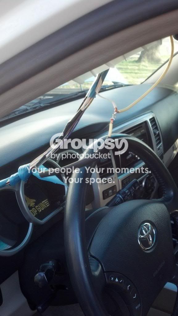

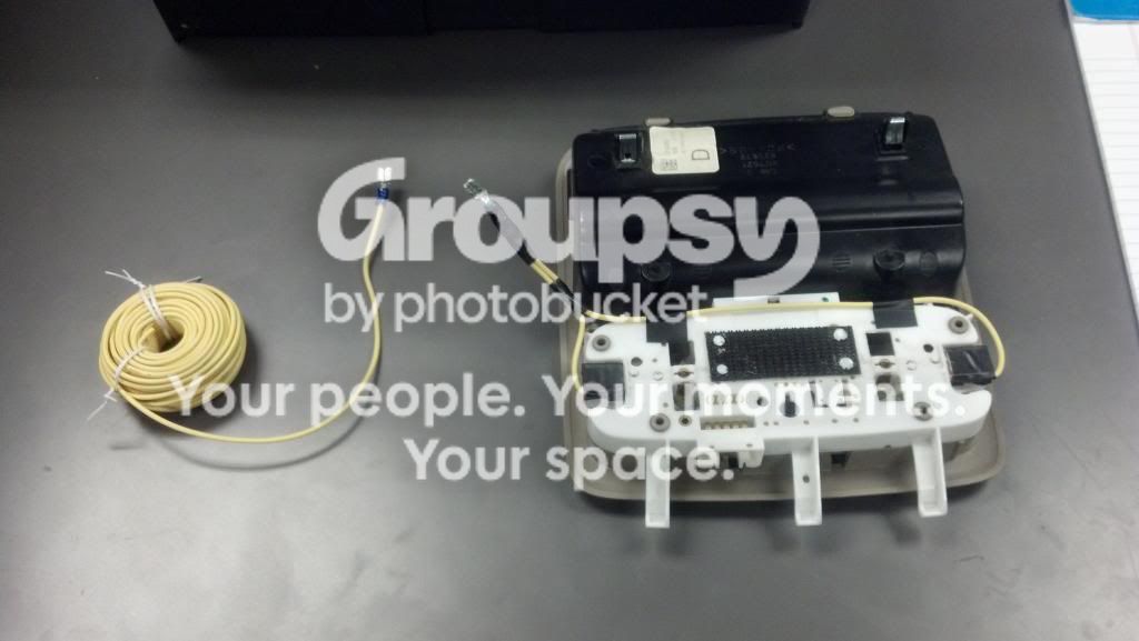

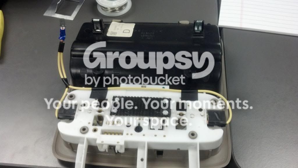

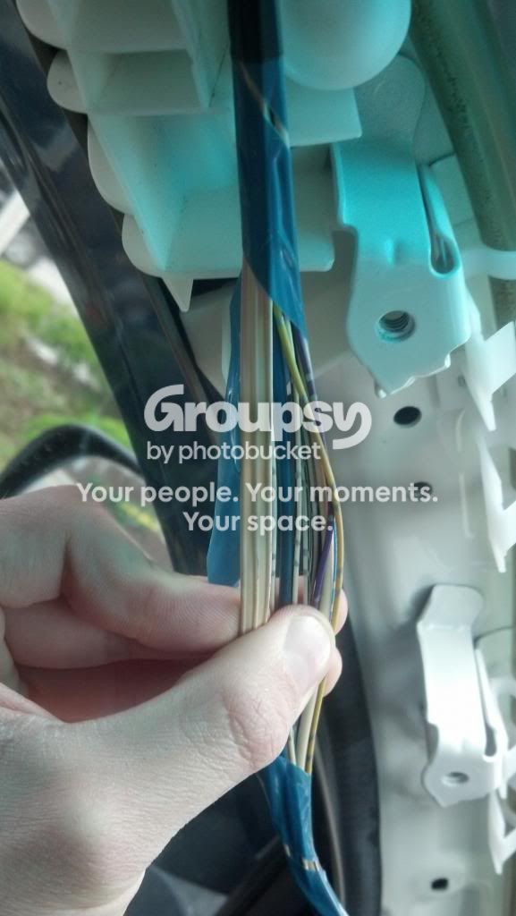

Here's some other pics which cover how to do this by tapping into the A pillar, the second method J.A. lists. I didn't want to mess with pulling the dash. Additionally I do not have lights on my running board to tap into, but I do have a sunroof so it was quite simple.
Switches are wired with 18 awg wire into the open socket.

Male and Female ends for easy removal.
IMG_20140408_135957_357_zpsdf6e305b.jpg~original

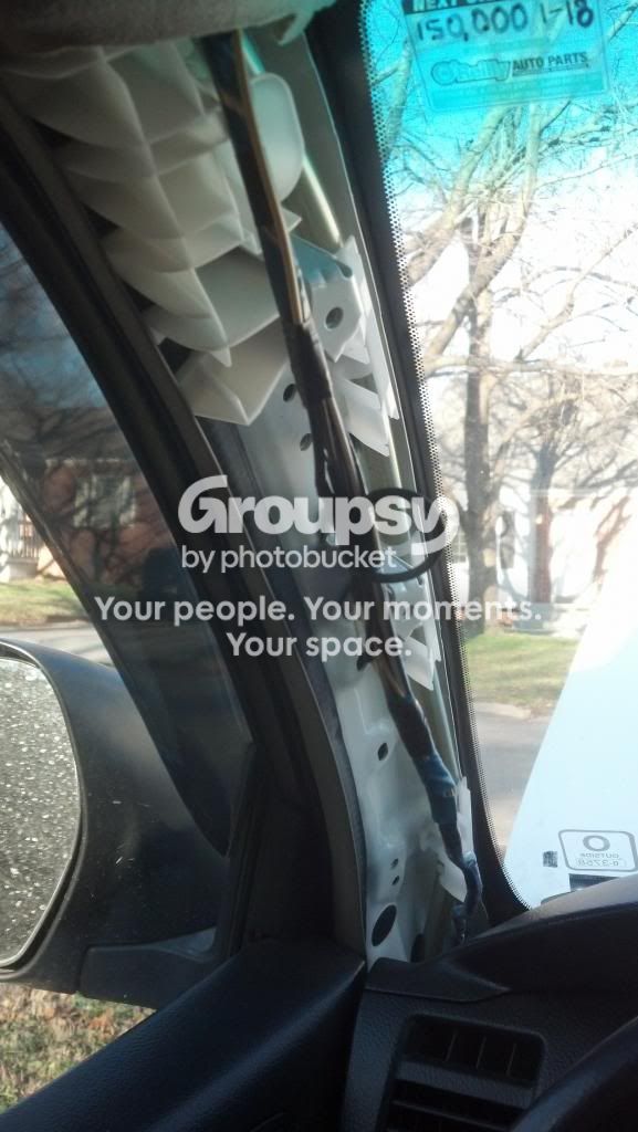

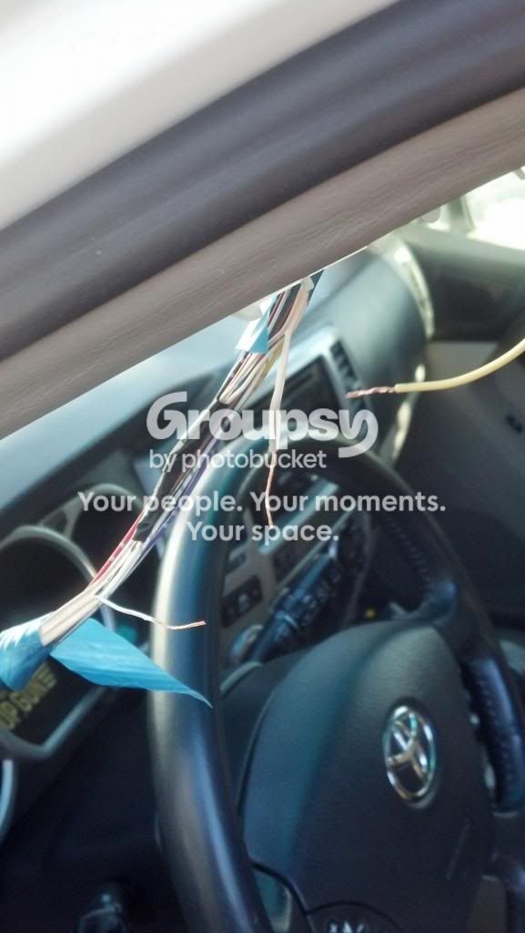

White ribbon in the left side A-pillar. The Middle wire is the one to tap.
IMG_20140408_140726_346_zps784d8602.jpg~original
I snipped the wire then used an extension of 18 awg so it could connect with the wire from the map light.
IMG_20140408_180308_638_zpsfe003781.jpg~original
Next I soldered the wires and then heat shrunk them.

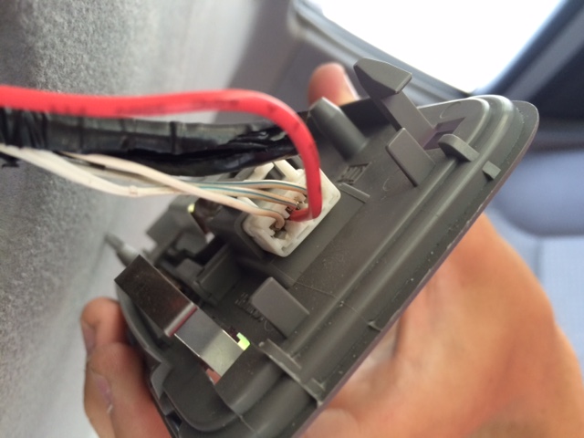

I used this to help me out today and it made things much easier! I did not want to take much of my car apart as it was raining out so instead of doing the a pillar or tapping into the ecu I used the dome light just behind the front seats. I thought it would be difficult to snake the wire through and around the sunroof, but it took less than 5 minutes. I used a multi meter to find that the middle wire to this dome light went hot when the doors were open. The connector at the dome light is easily tapped into without requiring any extra hardware. It is a gate style so you can simply flip it open, add your accessory wire and close it and you have power! I've included a picture below to help visualize this. Also, all you really need for this is about 4 feet of 18 gauge wire, one bullet style connector, and some electrical tape.Thanks so much J.A.!!

Old thread I know, but I'm posting this for future lurkers like myself. On the later 4th gens (06-09 I'd assume) the center dome light got changed and the wires going to it is the same ILE ribbon wire in the A-pillar - all white with 3 blue stripes.
Given they were both ribbon wires, I tapped into the A-pillar one to save myself the trouble of snaking the wire around the sunroof. Just use a razor to isolate the center wire then use a scotchlok to put it with your new 18awg wire.
