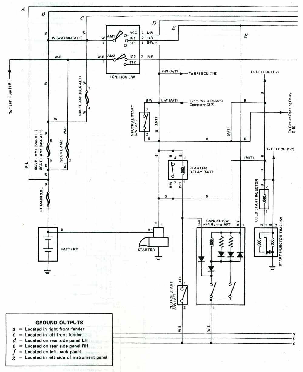

Thank you guys. I took it to the alarm shop today and they said it is not the alarm that is causing it. Does anybody have a factory service manual who could scan a diagram of the starter solenoid line? I know there is a starter relay under the hood, is there a fuse somewhere?
She starts good everytime using the Macguyver method of touching a wire between the battery and starter soleniod line under the hood. She seems to be running good now, I just can't start the car from inside. There must be a blown fuse or pinched wire somewhere inbetween the ignition and solenid line under the hood.
This is from a 1984-95 4Runner service manual. Hope it helps...

Thanks everyone for the help. I replaced the ignition switch and no improvement. She still wouldn't start. There must be a crimped or corroded wire somewhere behind the dash or something. I ended up running a wire from the solenoid line under to hood to the solenoid line in the harness by the ignition. She starts up from the ignition everytime. Only thing is that my neuteral safety switch is bypassed, so it will actually start in any gear now. I just got to be extra sure she is in park everytime and I have my foot on the brake everytime I start her.
