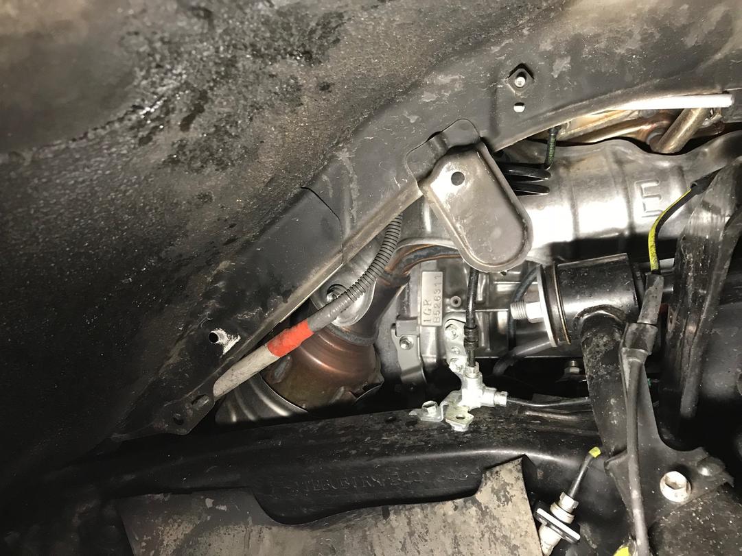

Here are a few more pictures, you can see where the paint has actually been worn off by the flaps rubbing and the sound was easily reproduced.
Spots where the flap rubbed through.

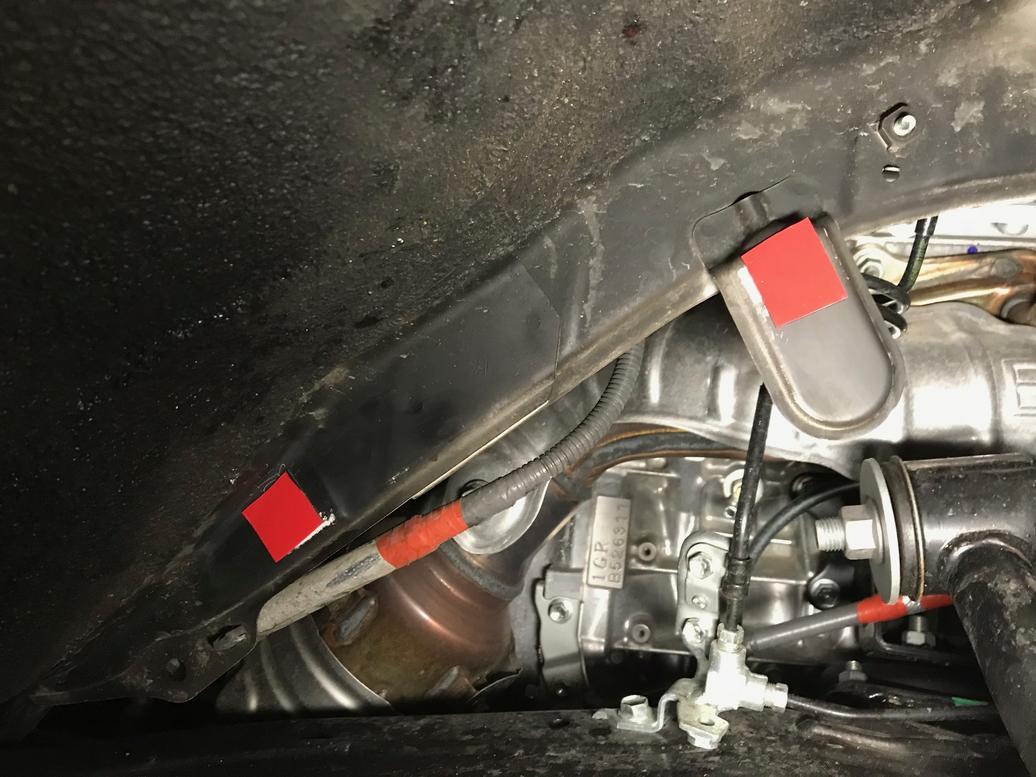

Two sided tape, removed the red and poked a hole through.

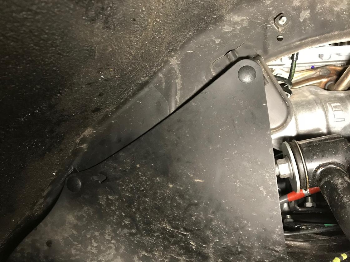

All done, I did both sides for good measure.
