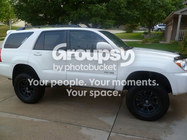

Had the alignment done, put it's center caps on and washed it!
(not the best pic, but you get the idea)
