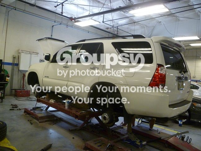

Lift is done! Took 2.5 hours to do the lift alone and 30 minutes to do the differential drop.
I had a lot of firsts! First time working on any car (I'm a girl, give me a break!)...first time getting as dirty as I did...and first time I've ever drank a beer! NO, I'm not 21! I'm well over the age to drink, just never cared for beer.
Working in a shop that isn't air conditioned on the weekend and the outside temps are well into the 100's... a beer actually taste pretty darn good.

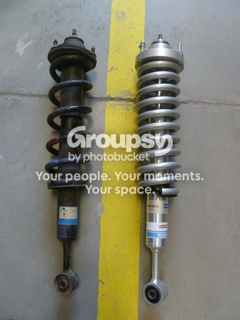

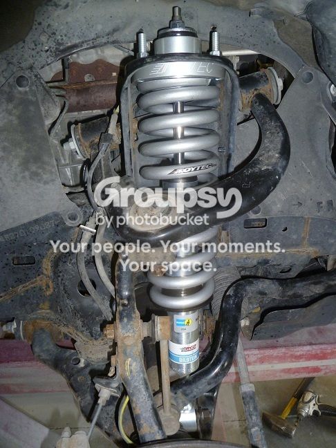

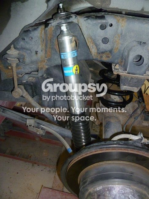

Toytec 3" Lift with coilovers and Bilsten 5100
Toytec3inchliftkitwithBilsteins.jpg~original

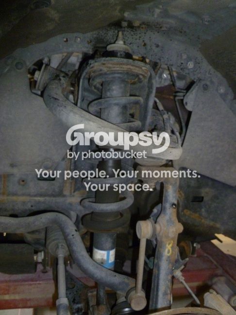

Old front shocks
frontshocksbefore.jpg~original
New/Old Front
frontshocksbeforeb.jpg~original
Shocks with coilovers on
frontshocksafter.jpg~original

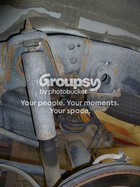

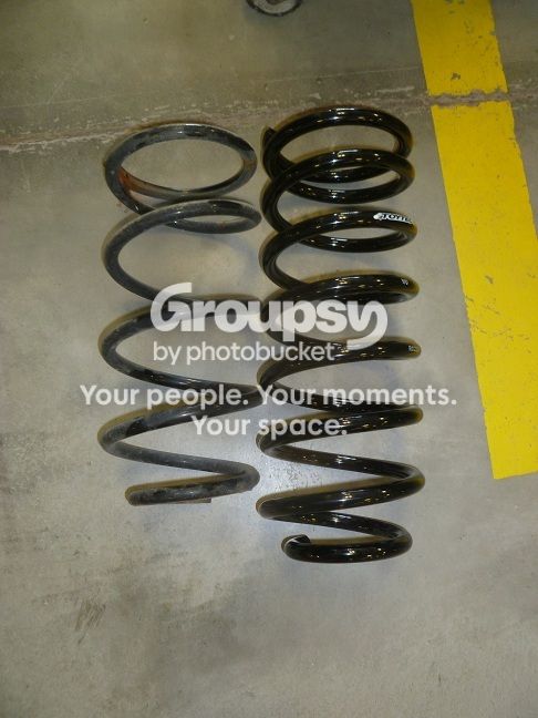

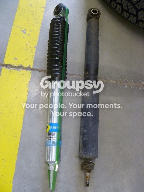

Old rear shocks
rearshocksbefore.jpg~original
New/Old Rear
rearshockc.jpg~original
rearshocksb.jpg~original
Bilsteins and springs on
rearshocksd.jpg~original

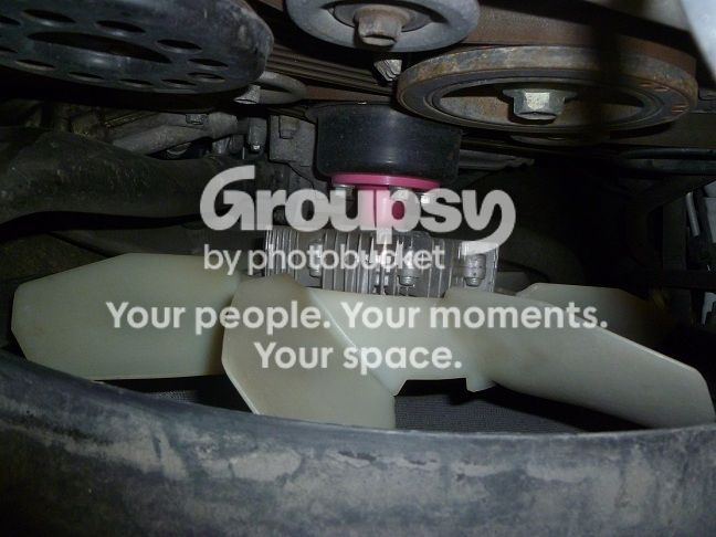

I determined my truck is actually a girl. Her fan clutch is pink :)
fanclutch.jpg~original

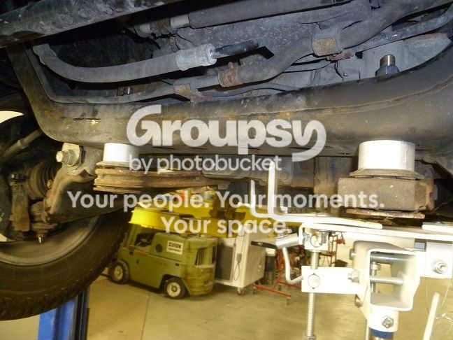

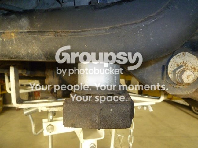

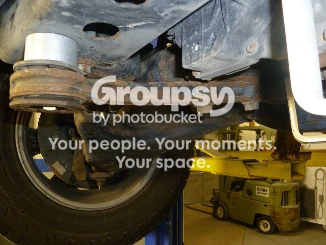

Differential Drop
differentialdrop.jpg~original
differentialdropc.jpg~original
differentialdropb.jpg~original

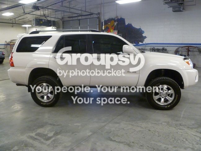

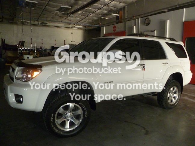

It's a bit nose High. Gained 4" in the front and 3" in the rear.
liftafterb.jpg~original
liftafterc.jpg~original
The rear shock top nut looks like it's over tightened. The bushing should look similar to the one in the stock rear shock pic.
Great job Terri!!! Looks great! You should be very proud of yourself.
That nose should level out for you once you drive and bounce it around a little. If not, then you may want to adjust it.
