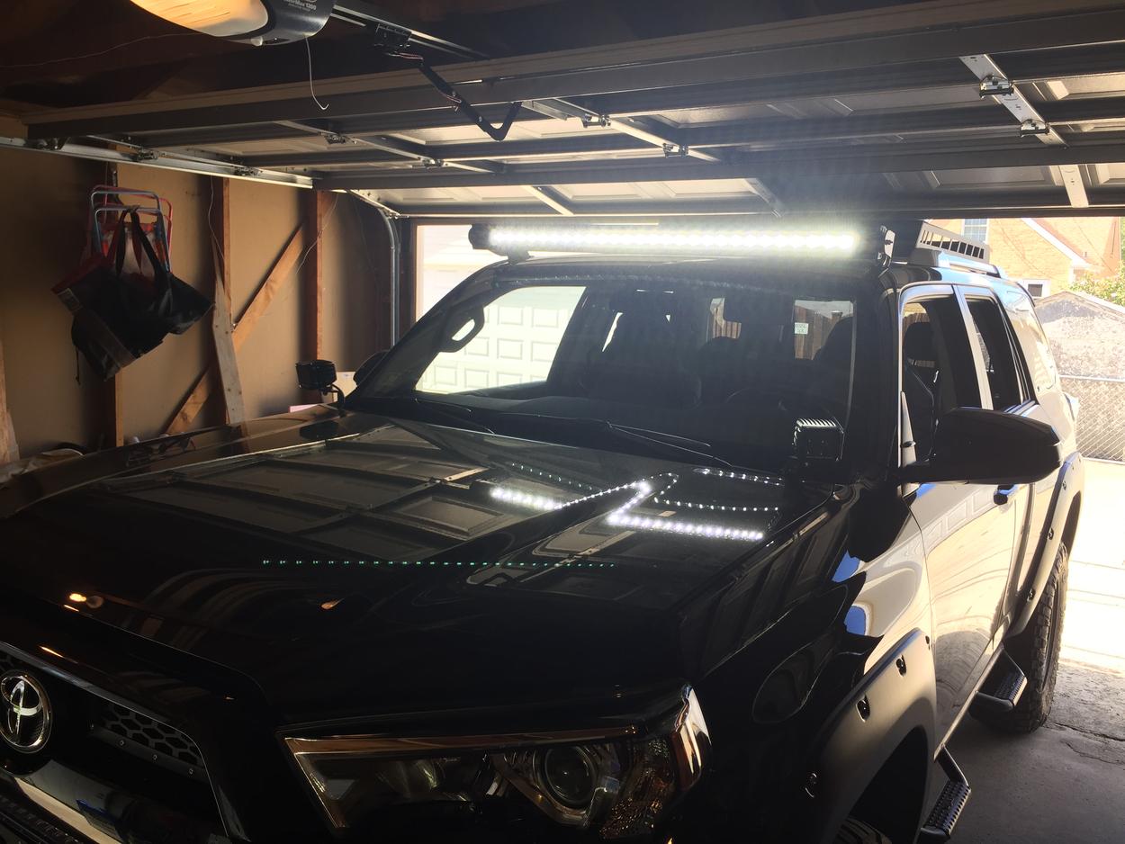

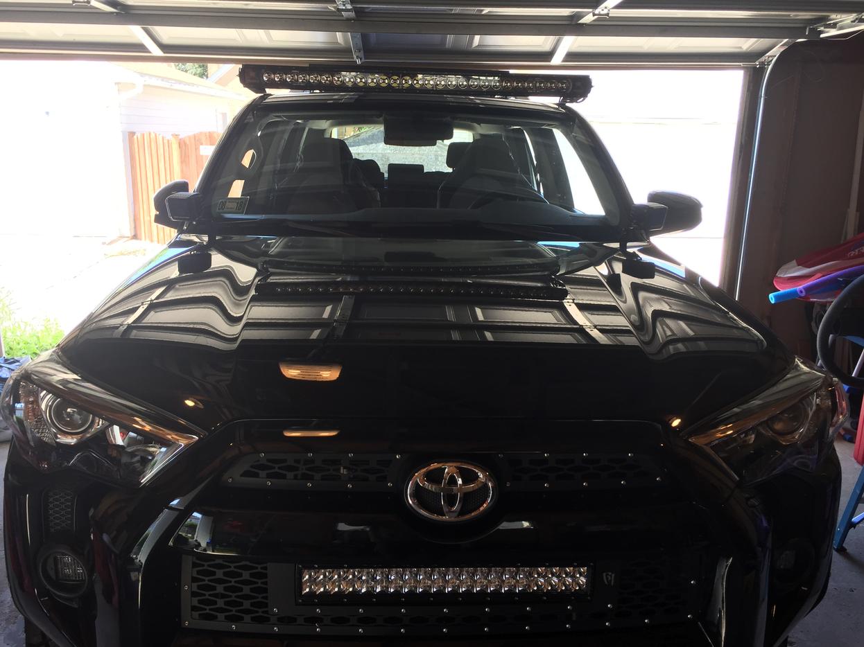

Just installed myself. Not for newbies. Yes you need to drill holes. Sleek look. All or nothing. If you hate the idea of drilling send it out and get the finished product. Just like hotdogs, you don't want to know how their made.these are the Nfab 1050 with Rigid Radiance 50" light bar as per spec. FYI didn't spend 1700 on the light bar, try 337.00 Amazon. Mic drops ��
