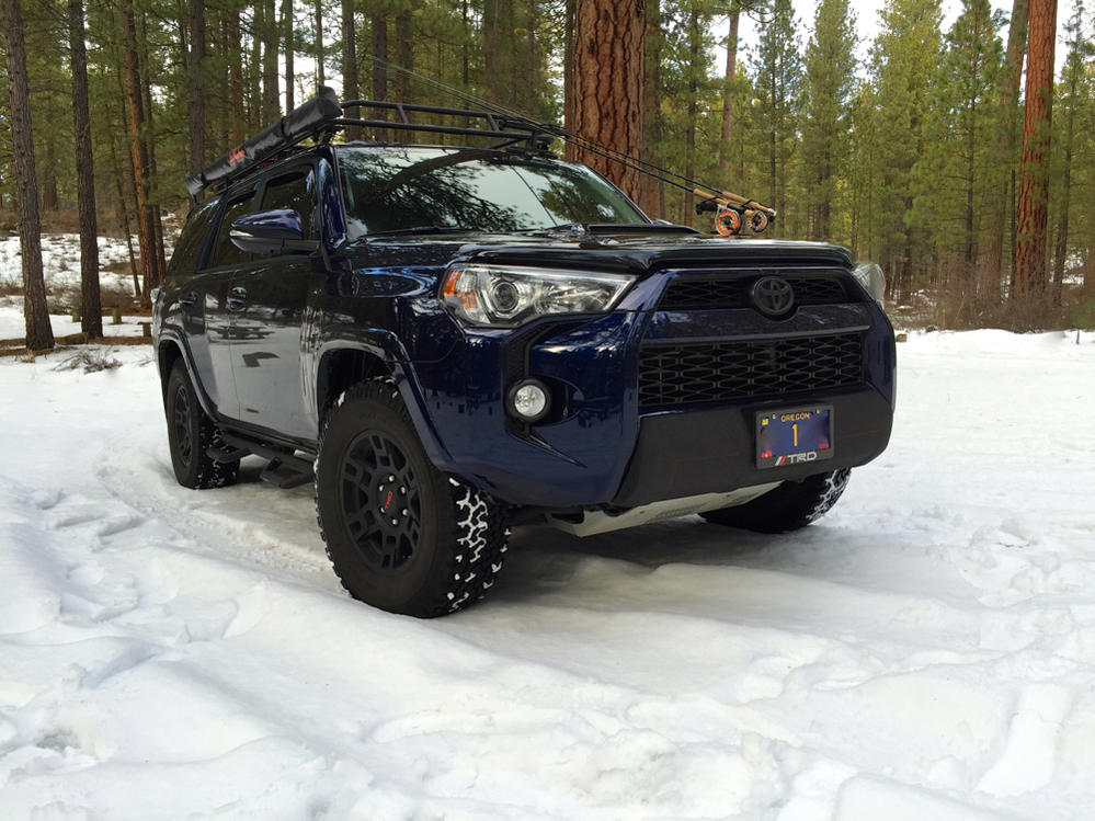

Yes, Line-x'd them before install. Was hoping to protect them from gravel and road grit. One year in and still like new. No rust issues that seem to pop up with untreated units. Power washer keeps them looking good. Just don't treat them with tire shine as they get slick! Wife loves them for getting in the rig, I like them for grabbing stuff off the roof. Nice step up to the rear tire.

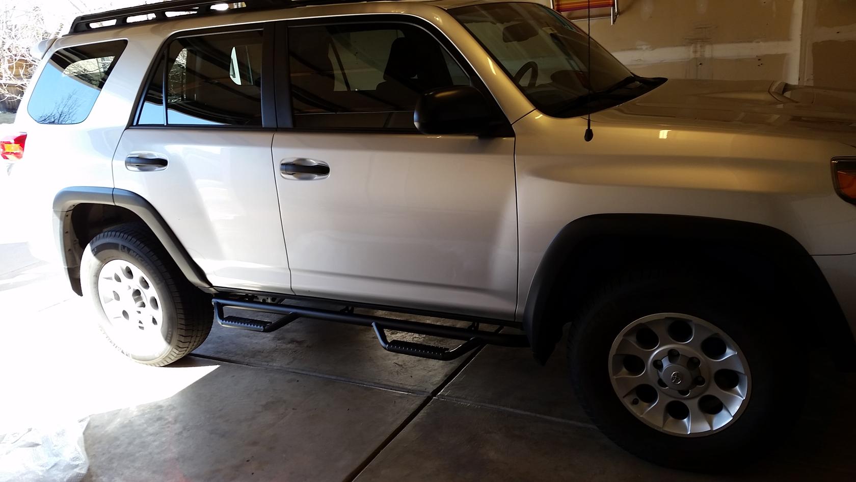

Bought mine off jet.com for $280 using the 15% first time buyers discount. My truck is stock but think the bars give it a slightly aggressive look. The fit is perfect.

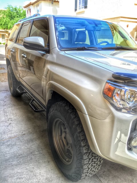

I live in the desert (AZ) so I have no concerns with rust at all. Nothing rusts out here. That being said, I paid $330 for them from runningboardwarehousr.com & installed them in about 20 minutes total time torquing to 20lbs at each of the 5 included bolts for the job. 10/10 happy with them so far.
Easy peezy. Lay on your back and put a bar on your stomach. You'll be able to see where the bolts are in the bottom of the body. BIG HINT. The bent part of the bar goes forward. The instructions will say otherwise, but take my word for it. Start one bolt in the center bracket to hold the bar in place. Then go to one end and start installing them until all are in place hand tight. Then snug them down with the wrench or a ratchet. 30 minutes tops. Faster if you have a helper.
