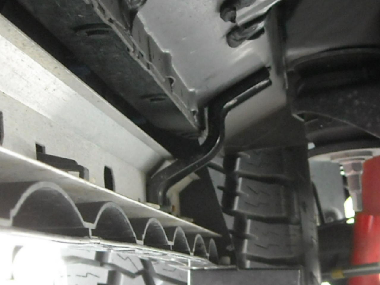

Photos of mod for n-fab step

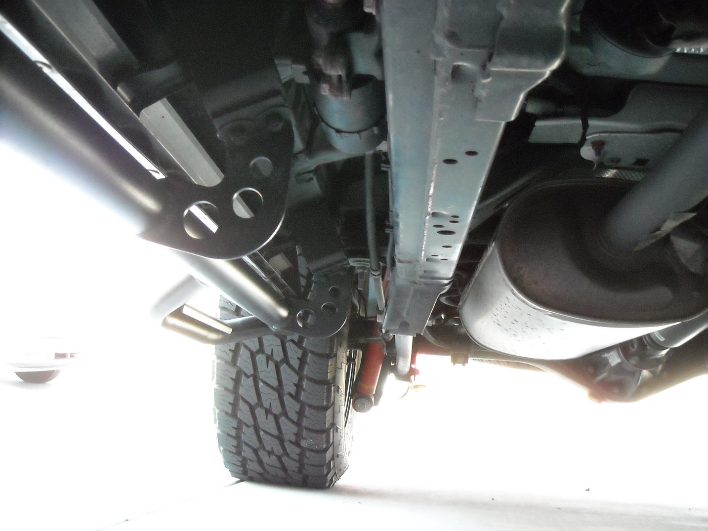

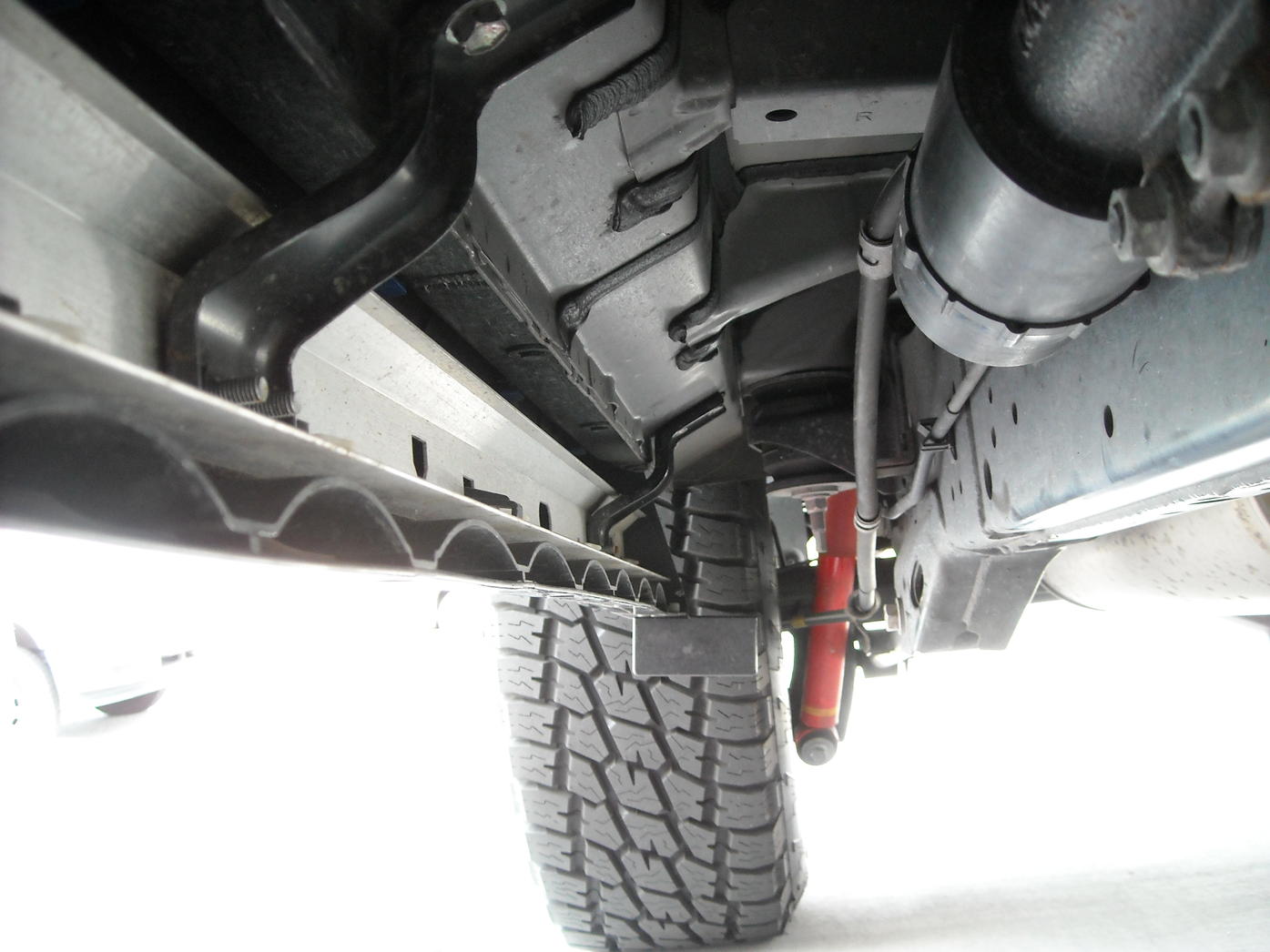

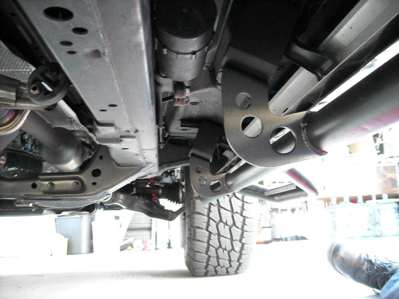

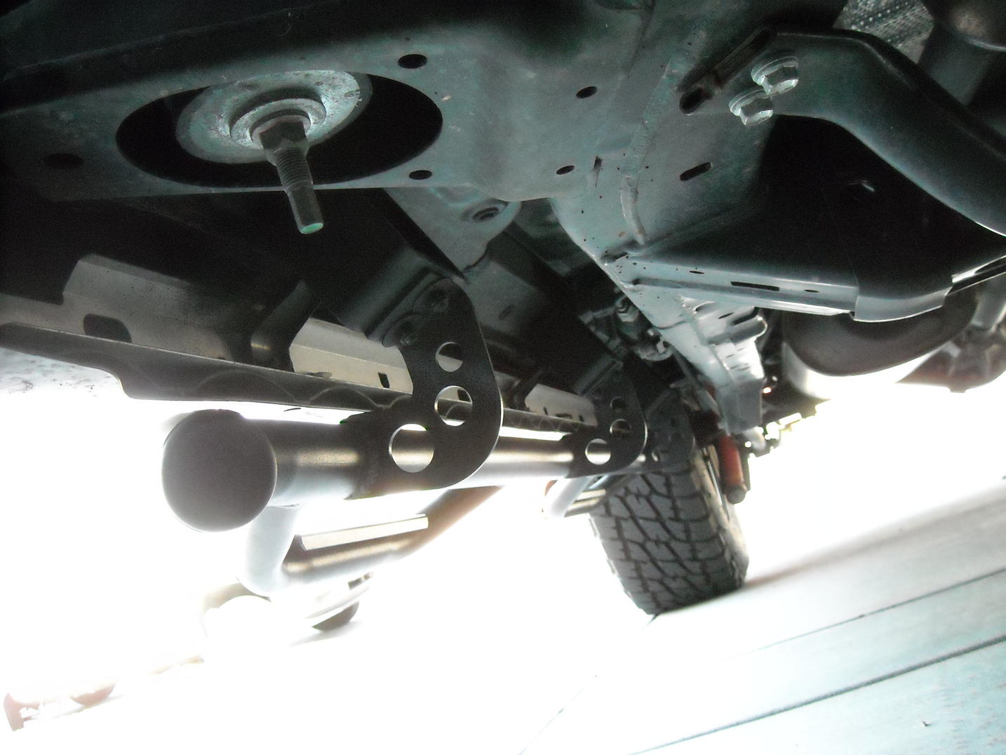

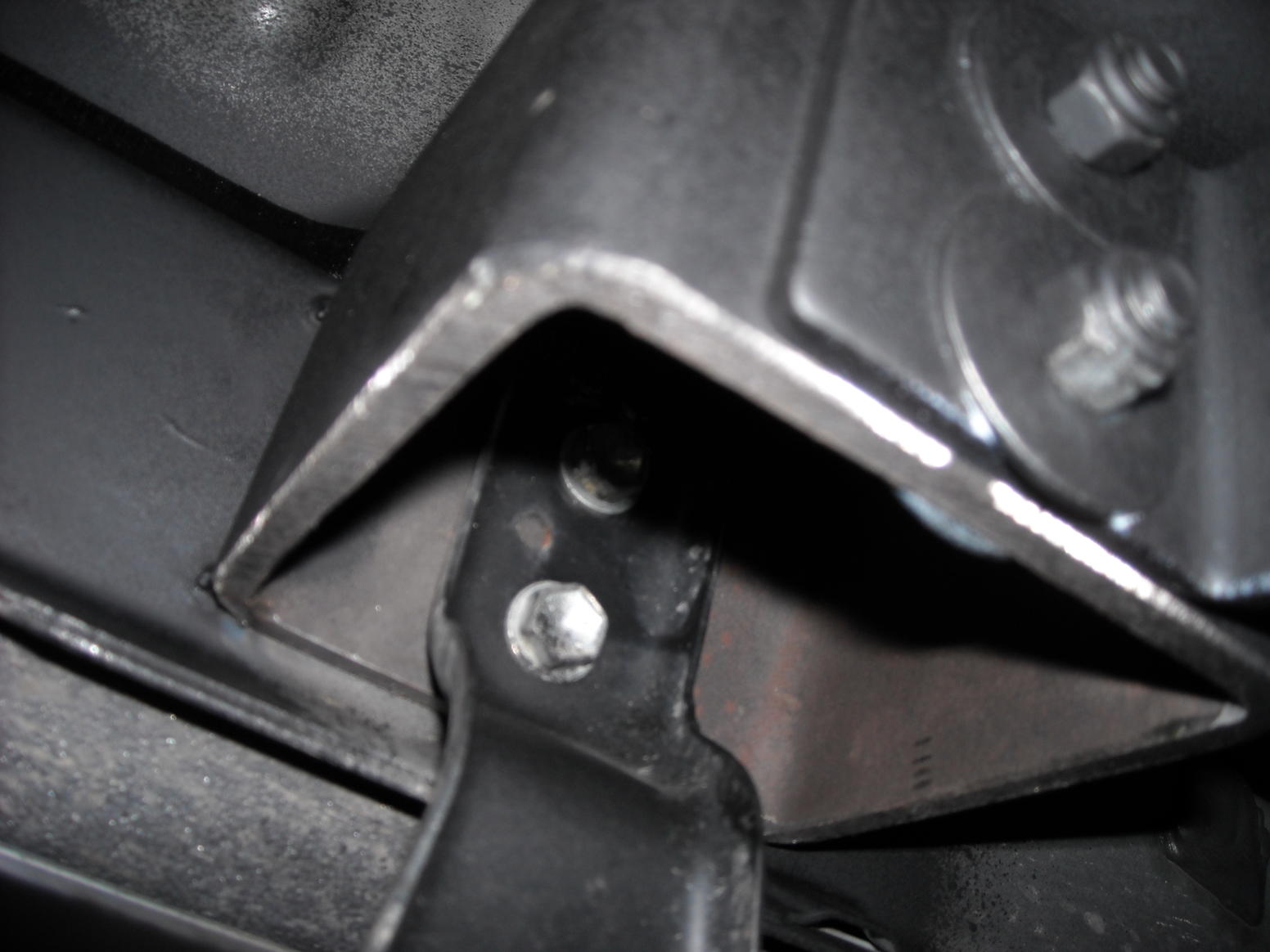

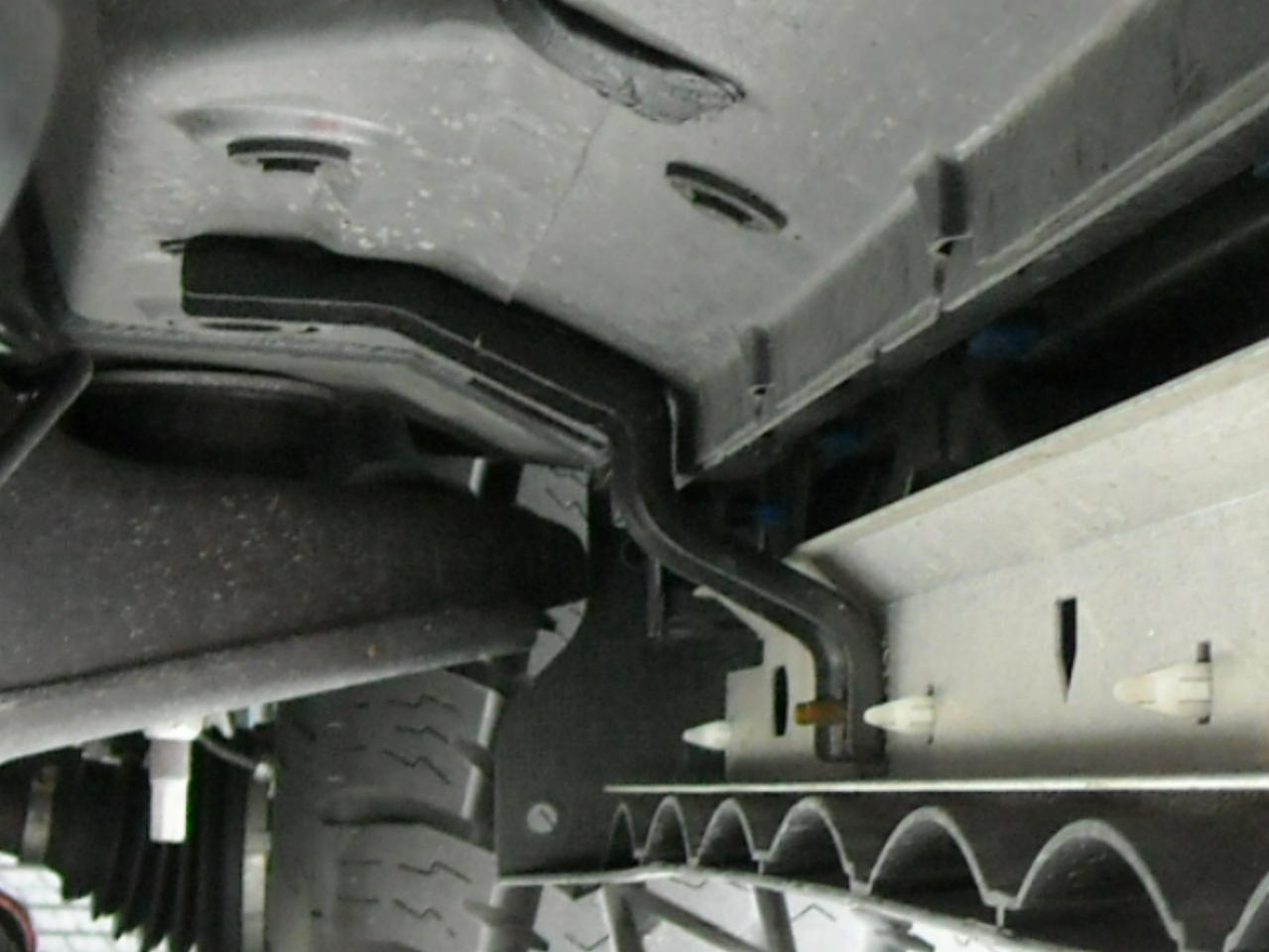

First 3 pics is without square tubing, the rest is with 4"x4"x2" square tubing. I thought of three ways of doing this. This way is the easiest

So is the extra tubing needed to install on SR5/Limited to clear the rocker panels? I just want to make sure I have it straight.
Very nice...sorry Keemonrunnin.....I don't see the square tubing...can you point that out in one of the picts please?
Take a look at pics 4-6. Its the part above where the step is connected to. Then the square tubing is connected to the body. The very last pic is a close up of how it's all put together. Hope this helps you out.
Keemonrunin Nice work!
So all you need extra is that tube spacer, the rest is the included mounting harwarde with the step, correct?
Also, did you drill 4 holes through the spacer to fit the screws, and did you sodder it?
thanks for the extra effort with pics they are very clear and easy to follow the setup.
Yes the square tube spacer is what you need to make this work 4"x4"x2" You can use the existing bolts to mount to the body or buy a little longer/stronger ones. Be sure to use loc tight on all the bolts mounting to the body. Yes you do have to drill 2 holes at top and bottom for the bolts. You would also need to get 12 nuts to mount the steps to the spacer. The hardware supplied doesn't come with the nuts. I got this all done at a buddy of mine who works at a fabricating shop. He did a little tack welding for added support where it meets with the body. May need to go to a fab shop or welding place to get the square tubing. Also be sure to paint all the spacers to prevent rusting before the install. Hope this answers your questions.

used a 4"x4"x2" square tubing as a spacer at each mounting bracket. I'll try to get some photos uploaded.
