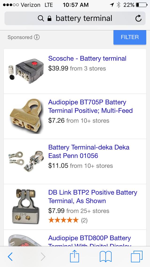

Something that connects to the battery terminals that has extra terminals to allow for auxiliary lighting to be connected to that to keep everything nice and clean and clutter free from the battery? LOL
If that made any sense what so ever, what is it? I've seen it before, or so I think I have.

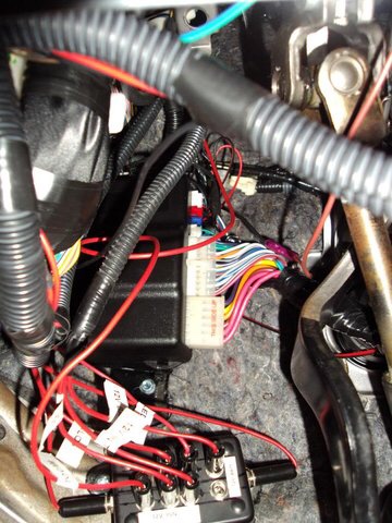

For a clean install this would probably be better
I'm looking for something the I extends from the terminals that I can connect positive and negative leads into with multiple slots, something made for auxiliary and lighting and accessories
I built a distribution block on the fly for my Scion about a decade ago. This time around I'm looking at the Blue Sea fuse blocks. I currently just have battery ring terminals with wing nuts, but I'm not running much to it yet.
This darn app won't let me upload pics currently.
One of these, mounted to the fuse block cover, with a 6 or 4 gauge power and ground wire running to the positive on the battery, and run the ground to the fender right next to the battery, there should already be a wire grounding the battery at this spot, 10mm bolt head.
