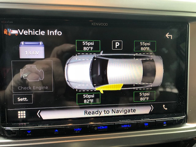

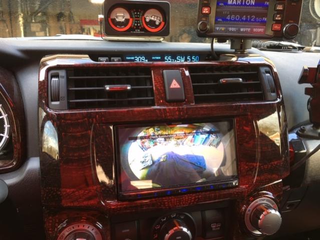

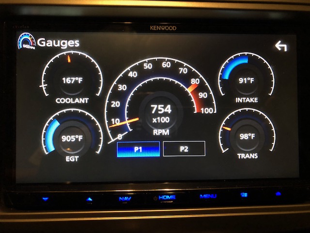

yea the lag and the way the factory NAV worked drove me nuts, I removed it the first month and installed a Kenwood 994s head unit with Garmin NAV built in. 100 times better and it automatically uses the cell signal from my phone to give me real time traffic and alternate routes when Im in the city. And you can load offroad maps to it for when your in the mountains etc...
Also It integrates with the vehicle ECU so I can change all those factory settings that people pay the dealer to change like door lock operationa and windows up and down with remote and 50 other settings. View engine data like transmission temp and the like
Also with the Kenwood dashcam that integrates into it I can view all my dashcam videos instantly on the large screen instead of fumbling with tiny buttons on the dashcam.
It is far superior to factory radio in every way possible

Does the steering wheel controls still work? Definitely looks like a big upgrade from the factory unit.

It only uses my phone data for the realtime traffic automatically otherwise it is fully functional on its own. The kenwood app is free and you only sign into it once and give it permission or not to access traffic when you first install it. otherwise I have never looked at the app since. The built in Garmin GPS functions the same as any normal Garmin GPS .
I have full steering wheel controls still by way of the maestro module wired into back of radio and as a matter of fact I can custom program buttons on the steering wheel too.
The 4 way button on my steering wheel I custom programmed it so even though the left and right arrows still perform their normal functions if I hold the right arrow button down for example for 3 seconds it shows my vehicle gauges and data on the screen.
So not only do you retain steering wheel controls you can actually add functions to them in the software.
And yes with the adapter cable the factory camera is fully functional too
