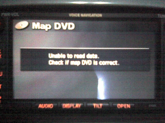

i got mine but it didn't works ... here's the error "Unable to read data. Check if map dvd is correct"

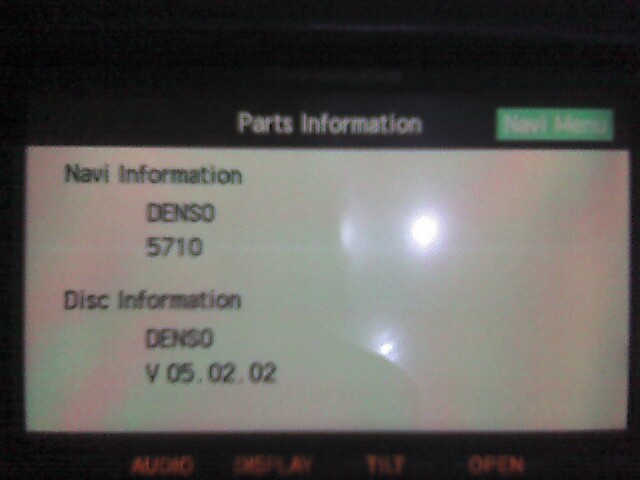

but when i check the version, it's V 05.02.02 ... do i have to do anything before upgrade to the new MAP? or just insert the dvd??

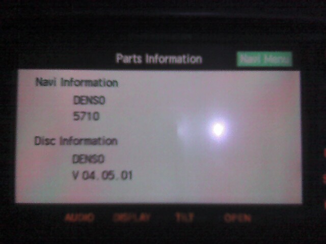

here's the old Navi Map DVD V 04.05.01
