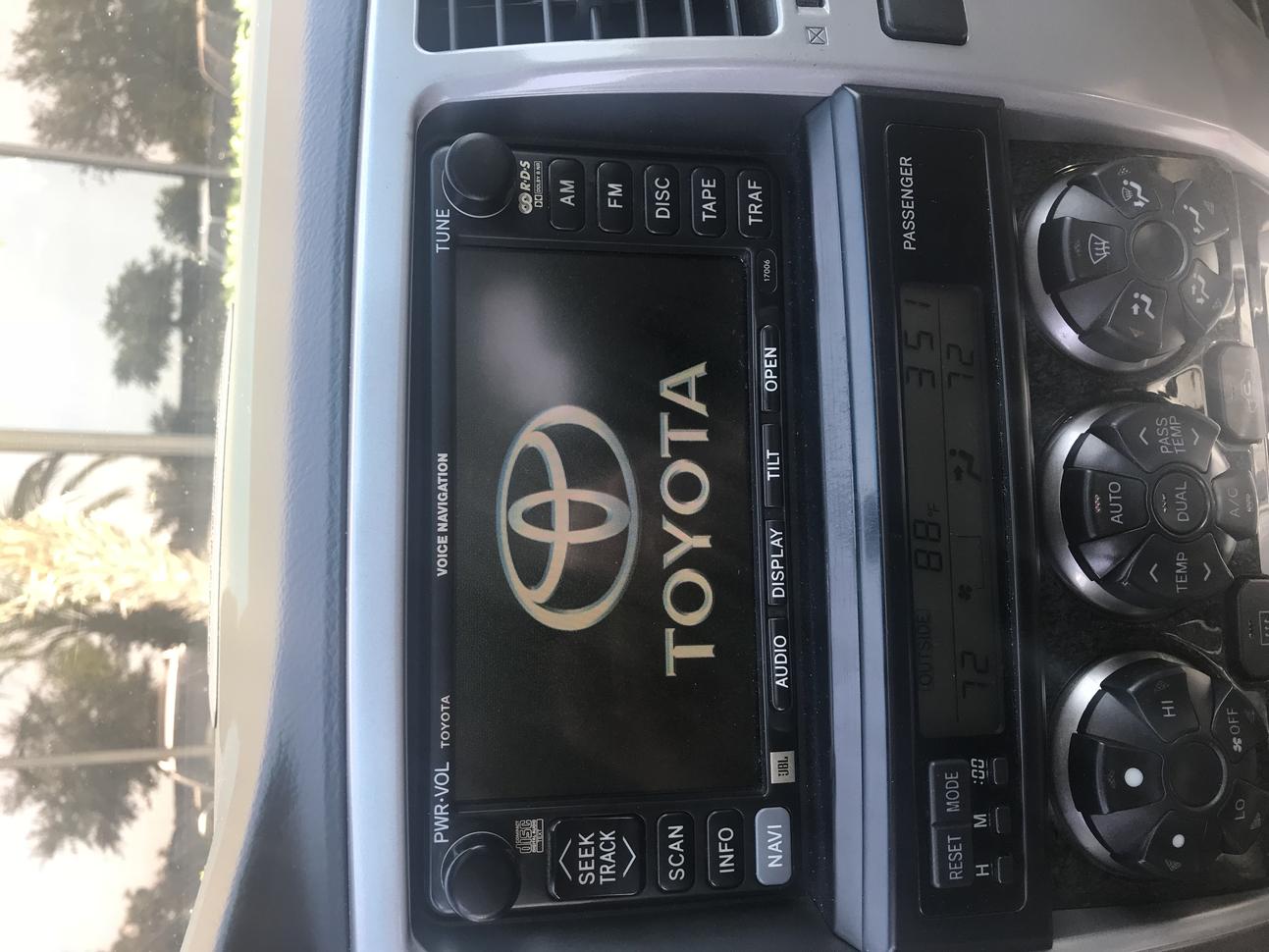

Reviving an old thread. Idk if this relevant, but this the best thread I could find with somewhat pertaining to my problem. My parents for Christmas one year bought me an updated Disc for my 2003 Limited. It came in a simple sleeve and just has Toyota Naviagsripn written on it. Not sure where it came from. After a few months my navigation stopped working all together. A received an error that said something along the lines of “Unable to read data. Check DVD.” I disconnected the battery and nothing. Popped the old DVD in and still nothing. Reset the system again by disconnecting the batter and nothing. Well I took it to the dealership and they said that they have never seen that error before and don’t know what to do but we can diagnose it for $100. I said no and have been sitting with no Navi for about a year. Everything else works fine but I can’t load the map at all. Thinking the unofficial disc might have uploaded a software update that the headunit can’t read or maybe the dvd reader itself is crapping out. Any thoughts or help would be greatly appreciated.
