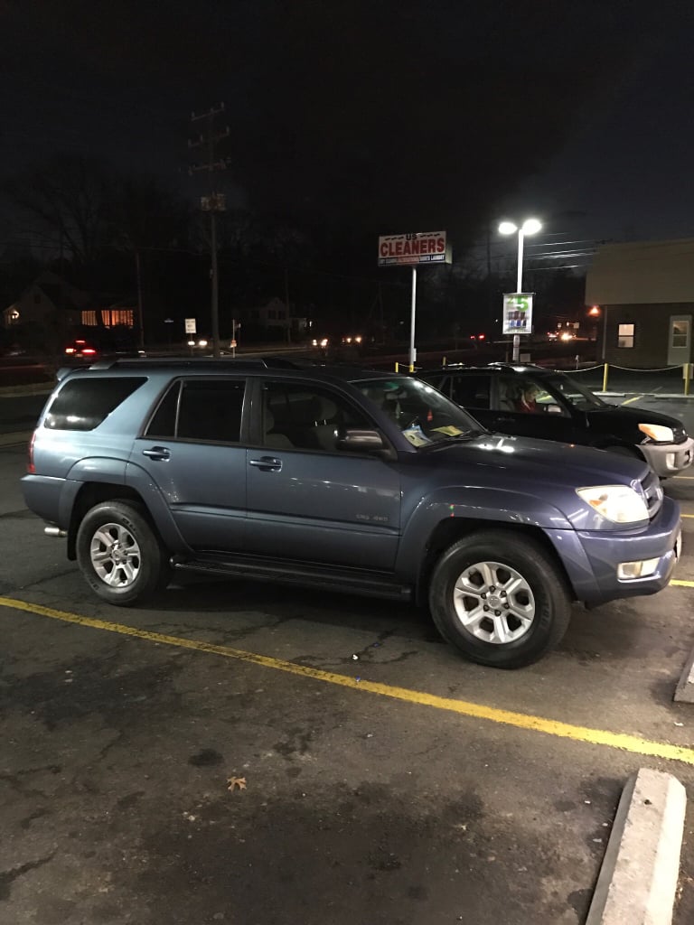

I just put those on my 05! It looks sexy. I have a thread somewhere here.
Mine were "take-offs" so they came the tires. Both brand new and with factory TPMS sensors.
I like the look, the truck feels a little higher too, they are 17's but the tire is bigger

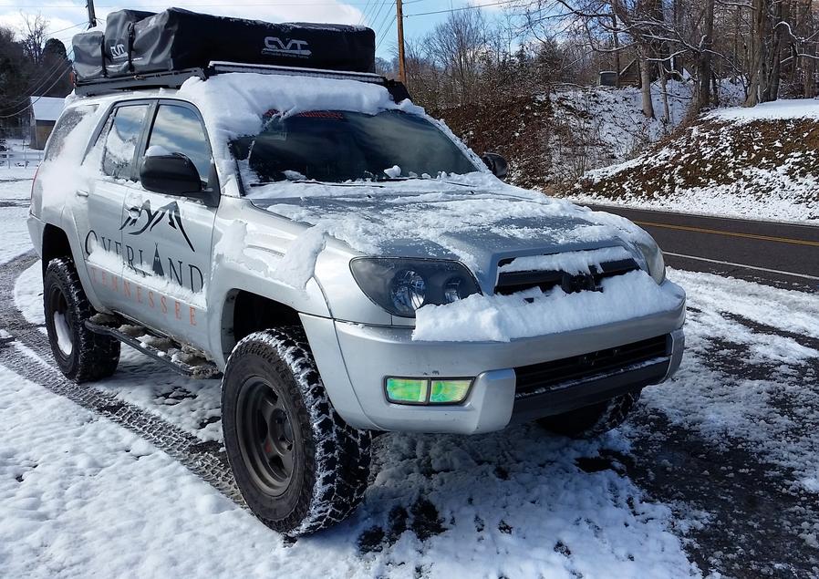

I love my SCS F5s ... They're negative 10 offset. Keep in mind my tires are only 10.2 inches wide ao your tires will stick out even farther. They also make a deeper offset variation if this isn't enough.
