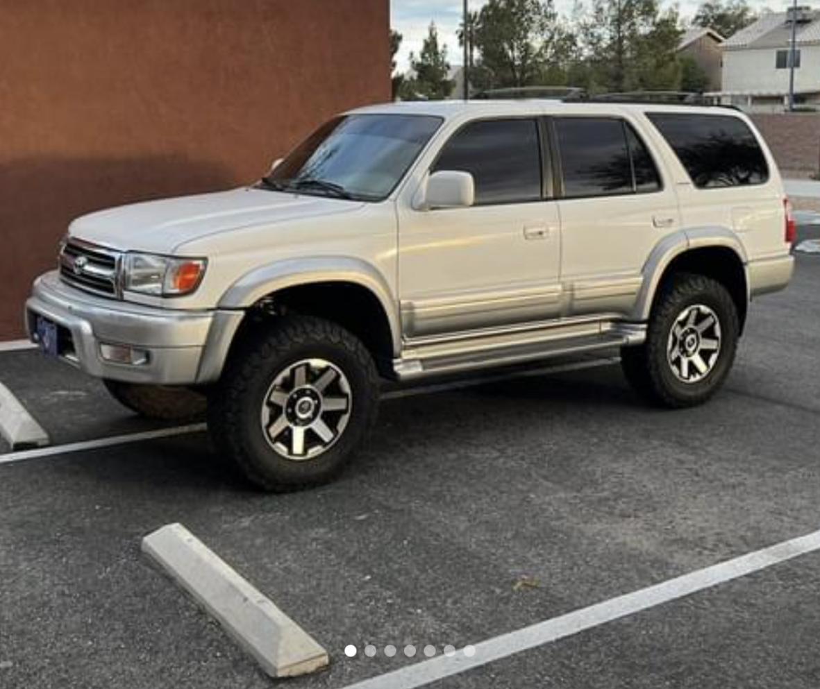

So I've had two 3rd gens and currently have a '99 limited, 2WD-all stock,zero mods so have no exp w/4Runner 4WD's. I'm thinking of buying the indentical 4RNR i have now but a 4WD w/the following mods. Can anyone take a look and tell me if the mods look good, meaning are appropriate for a 3rd gen 4WD and they didn't install upgrades that are for a kia sport! lol
The seller said it does have an oil pan leak but that was the only issue he new of.
Thanks in advance.
Freedom Off Road UCA
Bilstein 5100 front
Toytec rear struts
Toytec rear spring HEAVY DUTY (for towing/firmer ride)
2.5" Susp lift
All below w/in 5k miles:
New Timing Belt/Water Pump/Thermostat/Pulleys
New OEM Gas Cap
New OEM Radiator and Hoses with coolant flush
New OEM Evap Canister and evap hoses
New 1x OEM Ignition Coil Pack
New OEM Spark Plug Wires
New OEM 2x Lower Ball Joint (both sides)
New OEM Clockspring
New OEM Intermediate Steering Shaft
New Fuel pump
New Spark Plugs
New Valve Cover gasket (upper and lower)
New Power steering pump
New Rack and Pinion
New Leather Seat Upholstery for Driver and Passenger Seats
Tundra Big Brake Upgrade (New rotors, Pads, calipers from Tundra)
285/70/17 BFG KO2 load C
Wrapped to 5th Gen TRD Off Road Rims 17s

All the upgrades/maintenance listed is appropriate for a 3rd gen. The maintenance performed (radiator/lower ball joints/timing belt) should have you caught up on major maintenance. The only other thing I would recommend is front and rear diff fluids, transfer case fluid, and transmission fluid (several drain and fills OR transmission flush). I would ask the seller for parts receipts or repair receipts for what is listed.
Stock gear ratio with 33's will be fine since you are in Florida where it's flat and sea level. If you do want to regear keep in mind that front and rear differentials will need to be regeared which is a couple grand without adding any lockers.
bad, excellent! thanks for that very helpful reply. My last (hopefully) question is would you feel more confident in buying the 4RNR w/ the mods @ $7k (3ook miles) or buying another stock 4RNR at $7k 158K miles and doing the mods yourself?
oh and i moved to phoenix soooo, not so flat here, hence me wanting a 4x4!
I like that list of upgrades a lot, sounds like the owner knows what he’s doing. The C load 33s are a big plus too, I have E load 33s and want to switch to C next time I need tires
Quite a different climate and terrain from Florida then! I still wouldn't recommend a regear for 33's unless you are wanting to add a traction device or have additional armor weighing you down or are frequently towing. Just my $0.02 on the subject.
I wouldn't hesitate to buy the one with 300k miles, but I also do all my own mechanical work and have access to a vehicle lift. The lower mileage one is probably due to for most (if not all) of the service maintenance that was done on the 300k mile 4Runner. If you are able to do all the maintenance work on your own then timing belt/lower ball joints/radiator/fluids with OEM or OEM equivalent parts should be achievable for about $1200ish.
The only thing that I personally would avoid is the Limited 4wd trims for 96-00. They use an electric actuator for shifting the 2wd/4wd portion of the transfer case and I always had issues with my Limited going in/out of 4wd. That's a personal preference so take it with a grain of salt. Some people never have an issue, but I live up to my name.
EDIT: Keep in mind that for a bilstein lift like what's on the 300k mile 4Runner it would be roughly $1000 so take that into consideration as well. If I only had enough money for the vehicle itself and a little bit of maintenance money I would go with the 300k mile 4Runner.
Bad, this is so incredibly helpful! You were so thorough in your reply and added additional commentary that I also was wondering ab but forgot to ask!
Ok so I’ll reach out to him again today and ask ab the leak underneath. If it’s rear diff vs oil pan is that a big deal? I’m guessing yes.
Also what do you mean your pref is to avoid limited trims from 96-00? But you’d still buy the one I’m considering even tho it’s a limited?
And based on the mods I listed, what do you think all of those cost him?

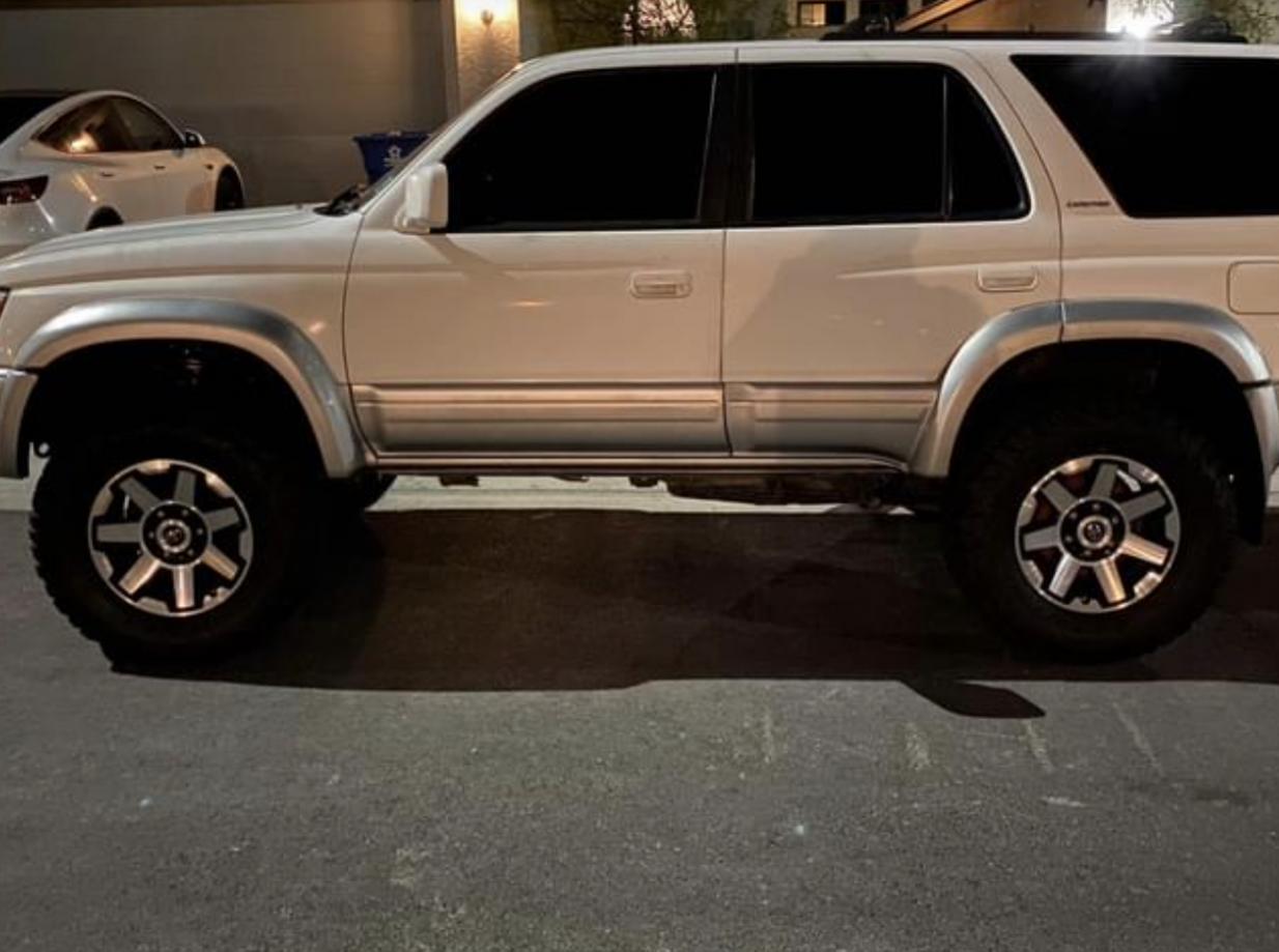

Here’s the .. issue.. the truck is 5 hours away from me so i haven’t seen it in person yet. It looks solid from the pics but you know how that goes. I have a cpl undercarriage vids and the owner shifting from 2wd to 4wd but I can’t get them uploaded..? And of course I wouldn’t buy it site unseen.
