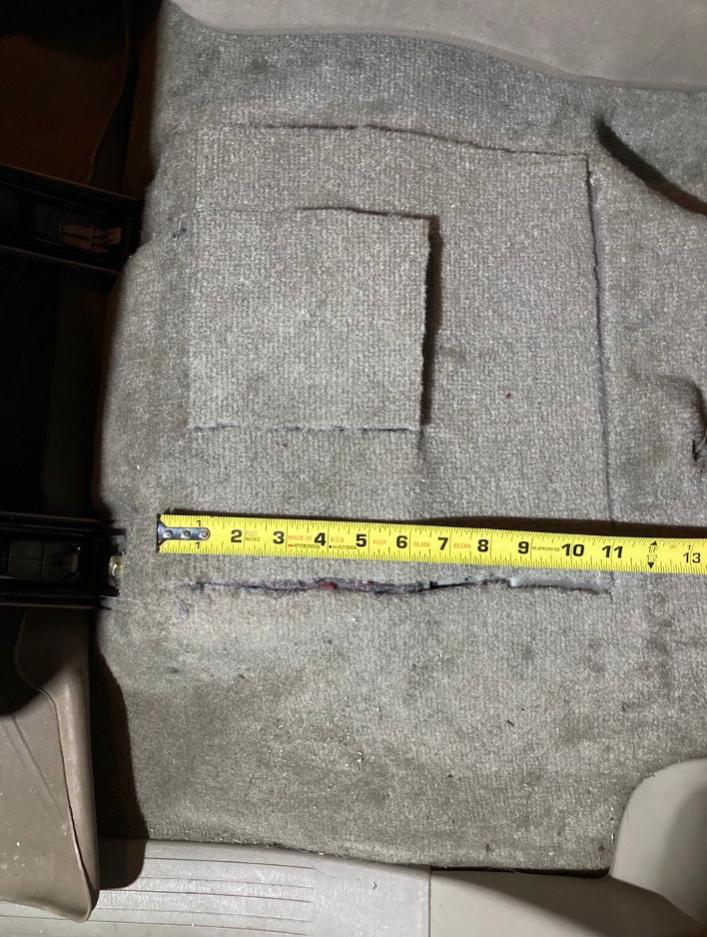

I didn't take pics during, so this what I did (pics after the fact)
1-After lifting back seat first step was cutting de rug. Aprox 12 x 11 inch
(The inner small rug openning was done months ago to check tank connections using OEM hole.)
Instead of what I did, I suggest move de "U" cut 1 inch towards passenger side (more centric with metal cutting) and extend cut 1 inch toward the front to allow more metal cutting than what I did. (Red lines)

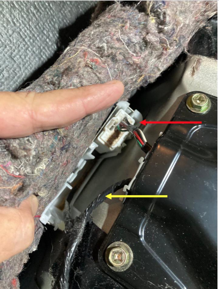

2- Disconnected battery neg.
Removed semicircular OEM cover and disconnected 2 connectors. One under the rug towards the drivers seat (red arrow)and the other cable (yellow arrow) at the pump top. Separate yellow arrow cable from rubber piece and place away from cutting area. Pressing the clip under the curve metal remove rubber piece with cables and place on top of tank to avoid damaging when cutting metal. Don’t disconnect fuel hoses from the tank yet to avoid vapors. There is going to be plenty of sparks. Protect yourself. Cover all the upholstery sorrounding the cutting.

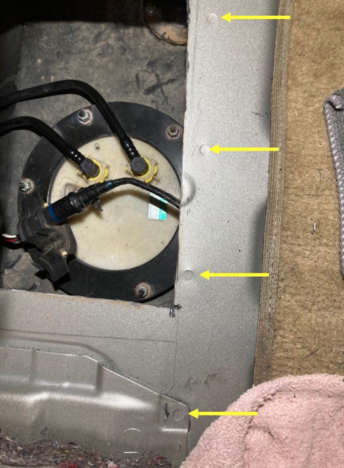

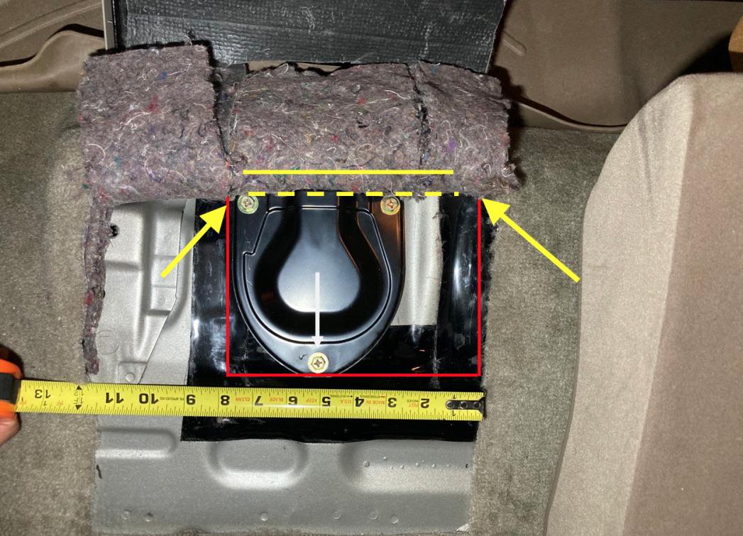

3-There is a limit to how much towards the cargo area you can place the transverse cut. There is a reinforcement under that I would not cut. The soldered points (visible from above, yellow arrows) and putting your hand trough the OEM hole will show you where it is. I made this horizontal cut saving the plastic nut that uses de oem cover (white arrow next pic). Length 8inch.

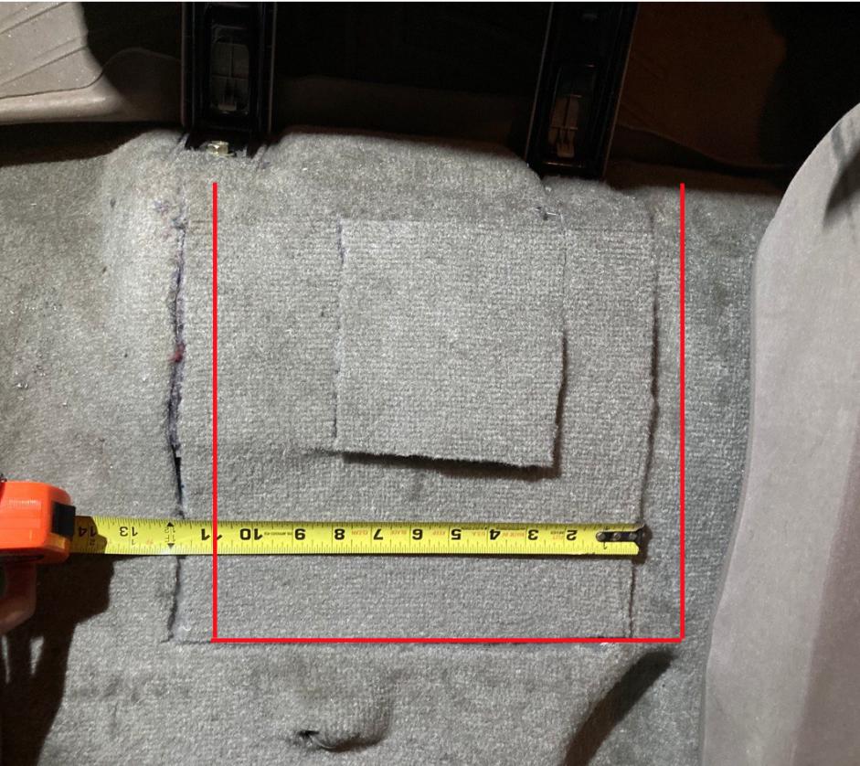

4-Longitudinal cuts described with pic. Red lines are where the actual cuts are.
Now you cand bend the metal towards the front. I didn’t cut enough toward the front seat (yellow arrows) and half way pump removal I needed to bent further de metal flap and it bent poorly and now i cannot make a nice curve again of that bent for a better closure. Prolong cuts so it will not bend in an area involving the rubber piece for the cables ( better bend at solid yellow line) not as I did (dotted line). I think it will bend and close better.
