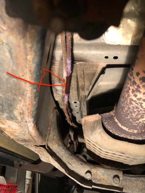

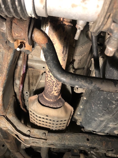

I have red fluid is leaking from a small diameter hose. The leak is near the catalytic converter pic attached.
Is this something that can be easily repaired?

Rear heater core lines. You can bypass them in the engine bay. Loop the hose back together like bypassing a normal heater core. Replacement lines part number 87248-35061. You can drive it but keep an eye on your coolant level.
Yep, the first painted steel version of the rear heater coolant lines. They were changed to stainless steel (aluminum?) in either 00 or 01. I got a set of those at a junkyard for cheap and installed them on my '99. When I took the original lines off mine, I saw that I'd just barely beaten a leak, some of the rust bubbles had only a tissue paper thin layer of metal left.

That's them. Glad you can still get them new as an option. I thought they were discontinued for a while. I grabbed 2 sets of the pick and pull for I think i have one or 2 that still need to be swapped over to stainless.
Some folks make them out of copper nickel lines as well so they never rot out again as well. :-)
Others just disconnect the rear heater like badluck suggested as well.. :-)
