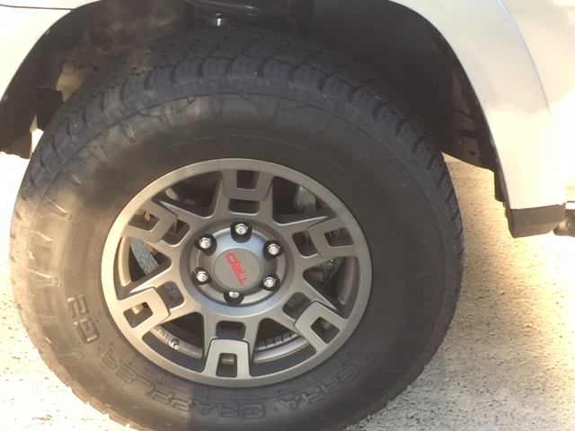

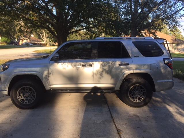

I bought the TRD Pro 17" wheels from Wesley Chapel Toyota in grey and provided them with the part # I found online. I believe this is the part # for the wheels I have...PTR20-35110-GR. They're only 7" wide which wasn't ideal and they did still rub a bit with the stock suspension. I have since switched out the suspension to 6112s and 5100s and done the fender mod and no longer rub with 265 70 17 Nitto Terra Grappler G2s.

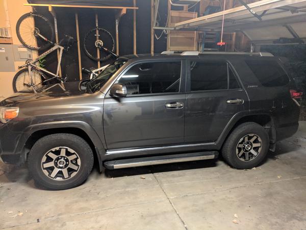

I just did this on my 2012 Limited. I swapped my 20in stock wheels (hey, anyone looking for a nice set up stock 20 in wheels????) for a set of 2017 trail wheels (complete with barely driven on tires). It's stupidly straightforward. I had Costco do the swap because I needed the TPMS sensors moved as well. It is a dramatic improvement over the 20 in wheels. There are a few people selling Trail wheels down in Colorado Springs - I'm sure there are some good deals up in Denver as well.
Obligatory picture, because I can. Running 265 70/17, and yes, the hideous running boards are the next thing I need to to "fix."

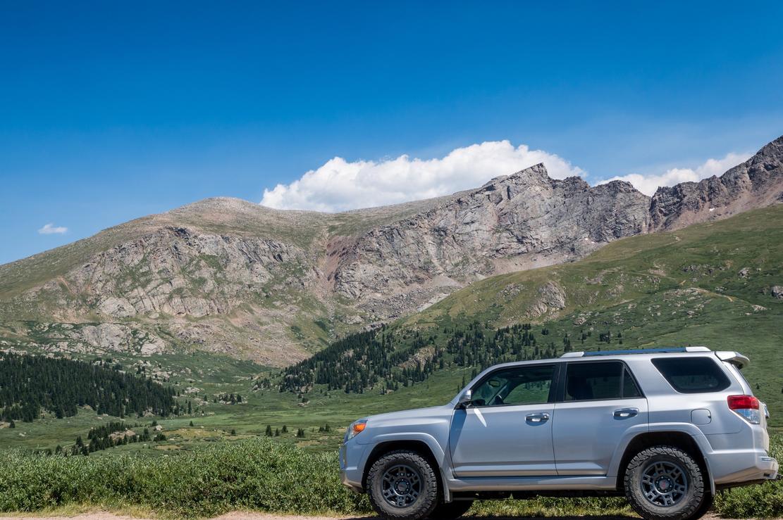

I went with 275 K02s on TRD Pro wheels on my Limited.
