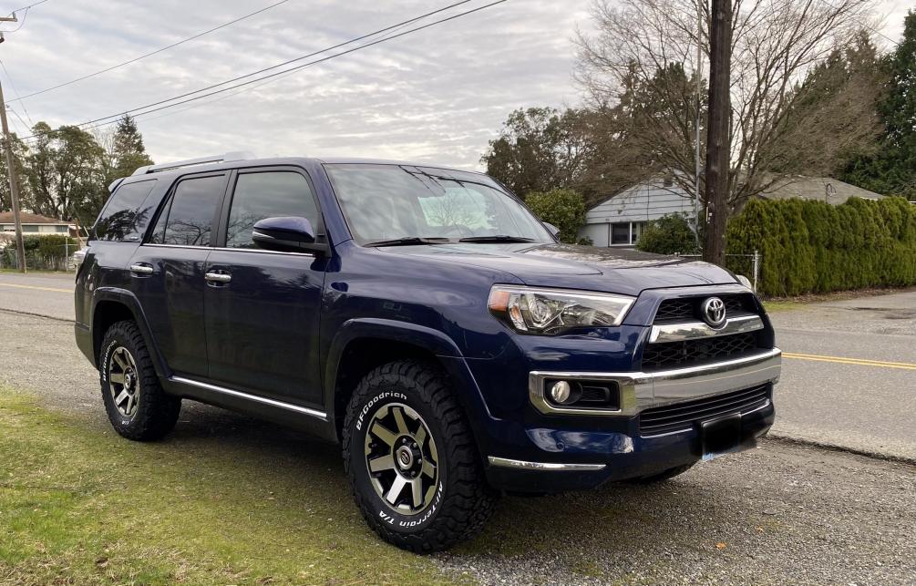

Me? Had to move the front fender liners forward a bit. Unscrewed them on the bottom, pushed them forward and drilled and screwed them in again. Documented a couple places on t4r.org if you search for fender liner mod.
The 275s look killer, and the mpg hit hasn’t been terrible (went from an indicated ~20 to ~18 on the highway).

So what did you do about the rubbing?
Heat gun and pushed the liner in. There's a bump on the front liner that need to be inverted. Since then, I've added a bumper and tucked the liners up two more inches which ended up pulling them forward in the problem spot by about and inch

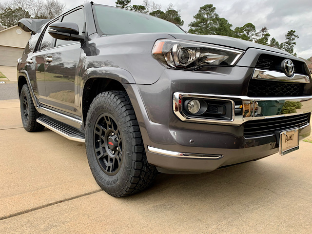

I just did this on my 2012 Limited. I swapped my 20in stock wheels (hey, anyone looking for a nice set up stock 20 in wheels????) for a set of 2017 trail wheels (complete with barely driven on tires). It's stupidly straightforward. I had Costco do the swap because I needed the TPMS sensors moved as well. It is a dramatic improvement over the 20 in wheels. There are a few people selling Trail wheels down in Colorado Springs - I'm sure there are some good deals up in Denver as well.
Obligatory picture, because I can. Running 265 70/17, and yes, the hideous running boards are the next thing I need to to "fix."
