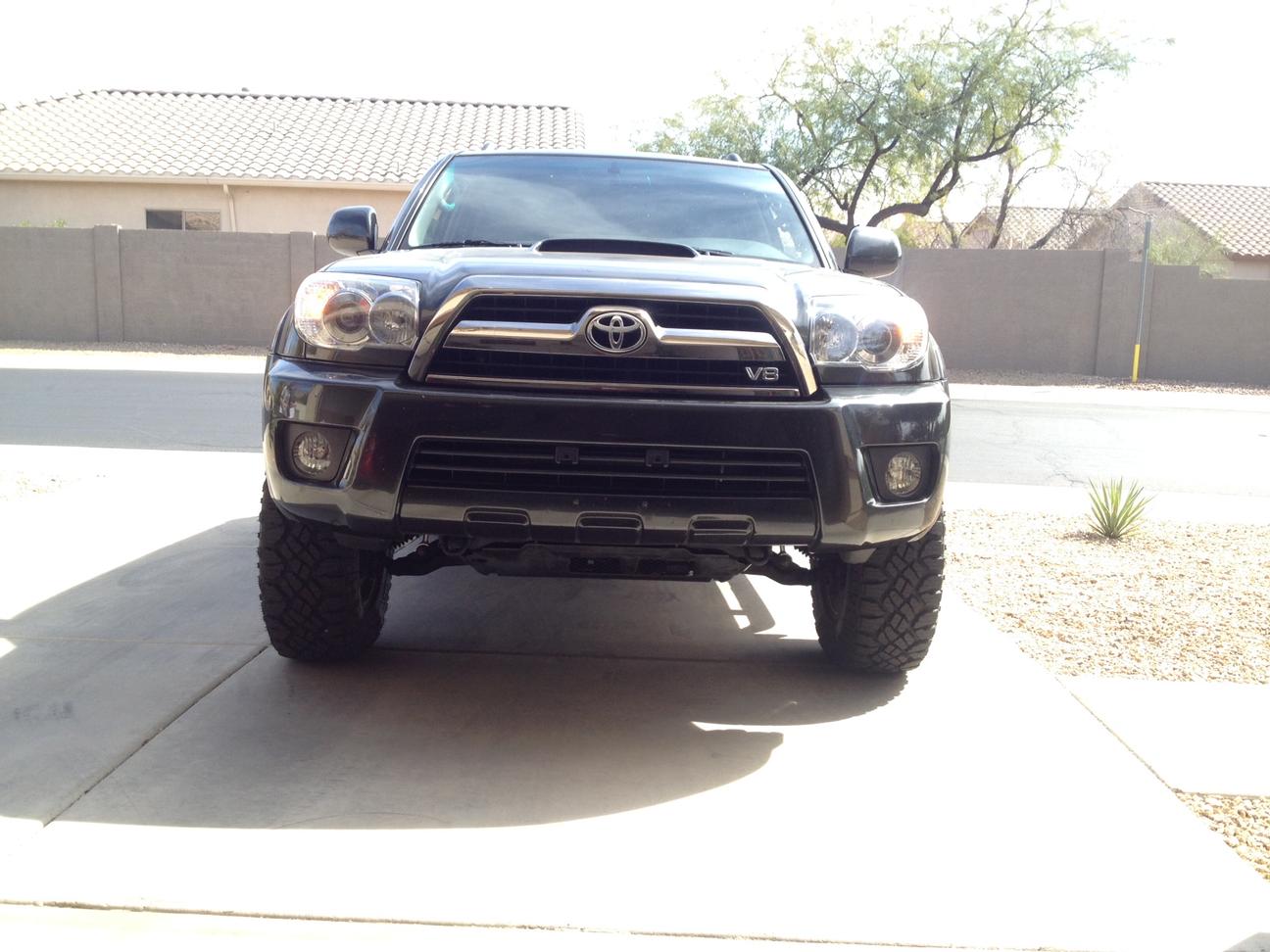

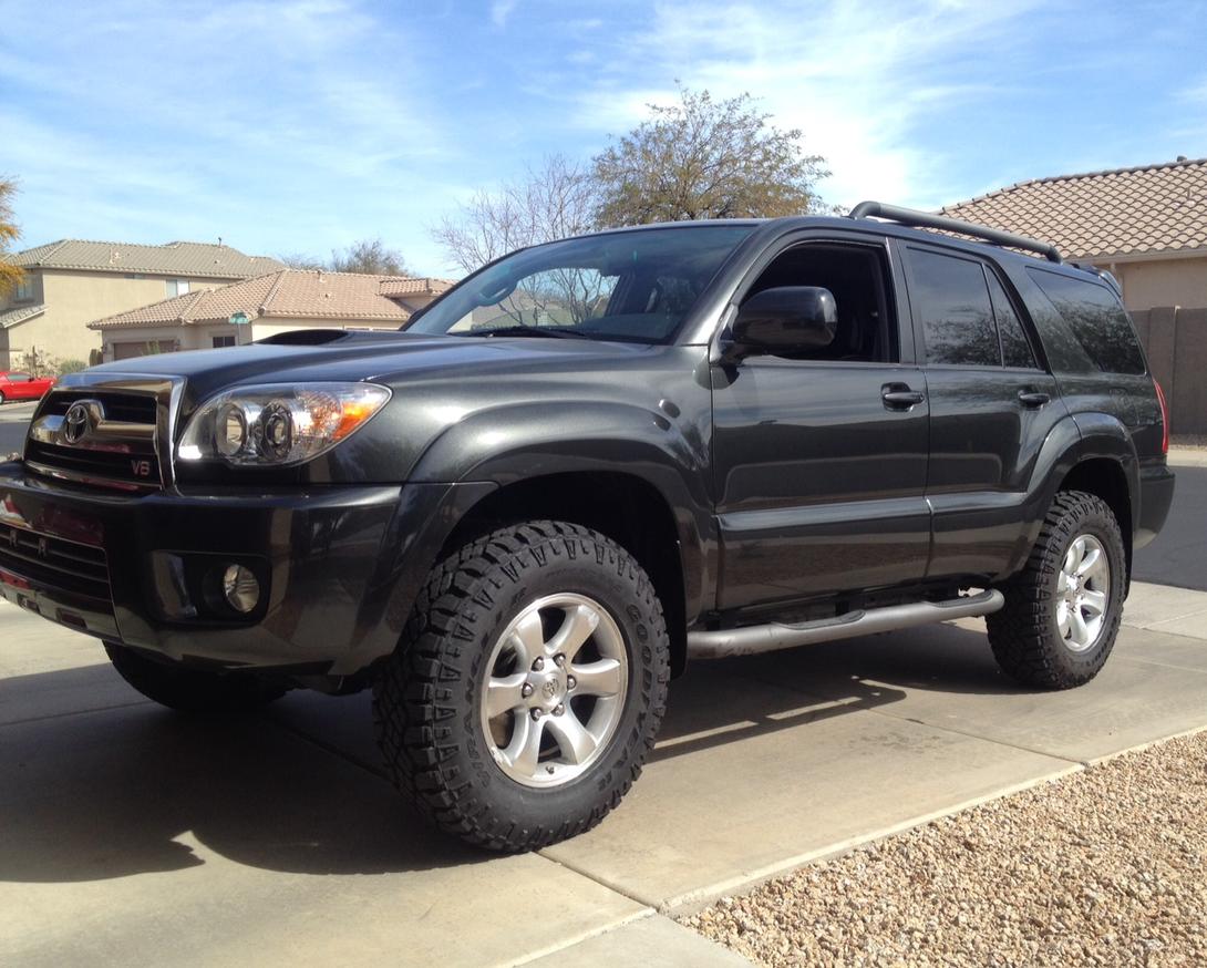

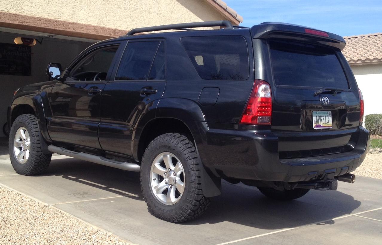

So quick background, my XReas took a dump and I went with brand new FJ springs in the rear, and adjustable Bilstien shocks all around and happy with the way it turned out. I am still up about 1/2 inch in the rear and that is just fine with me. However I do have the left to right lean when facing the truck. Its a about 1/2 inch lower on the drivers side. I have read about adding 1/4 inch spacers so I was hoping you guys could push me in the right direction. I am assuming that doing the new FJ springs in the front would have come out more on the level side from right to left, but now looking for a way to correct it without changing out the front springs. Thoughts and suggestions? Here is a pick of how my truck sits as of today...
I know its very minute and sure its more then 1/2 once I get into the truck, I am just super anal so trying to come up with suggestions. Also with adding a small spacer, will that change the alignment? My friend suggested adding an 18" subwoofer on the right side...lol.

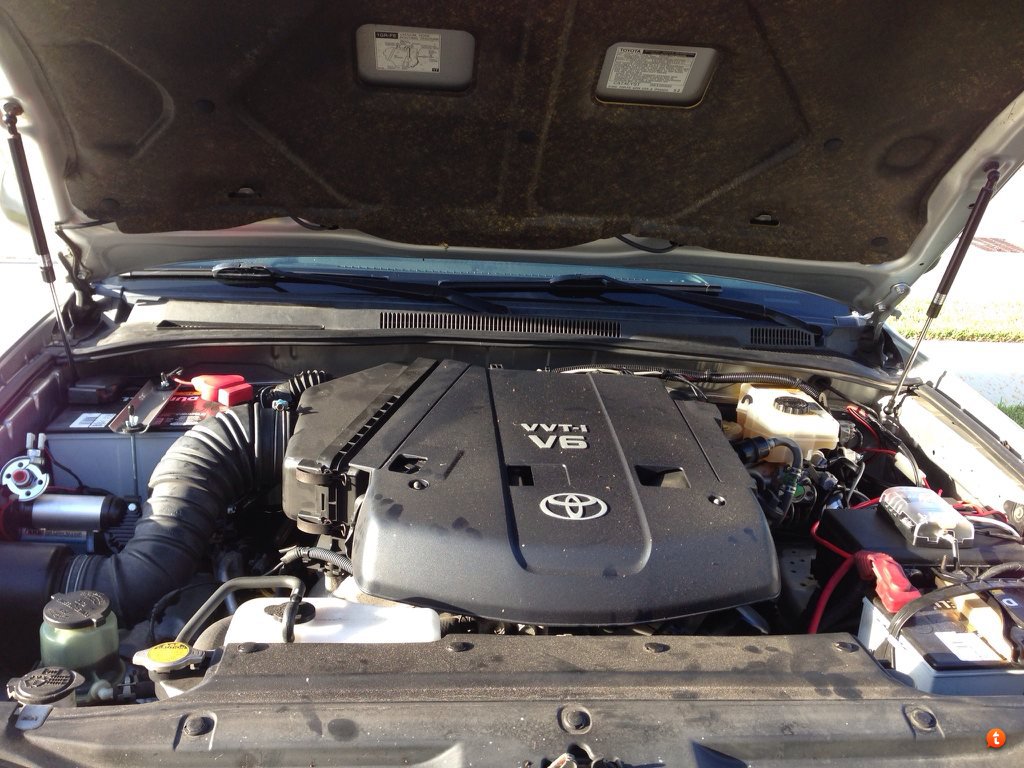

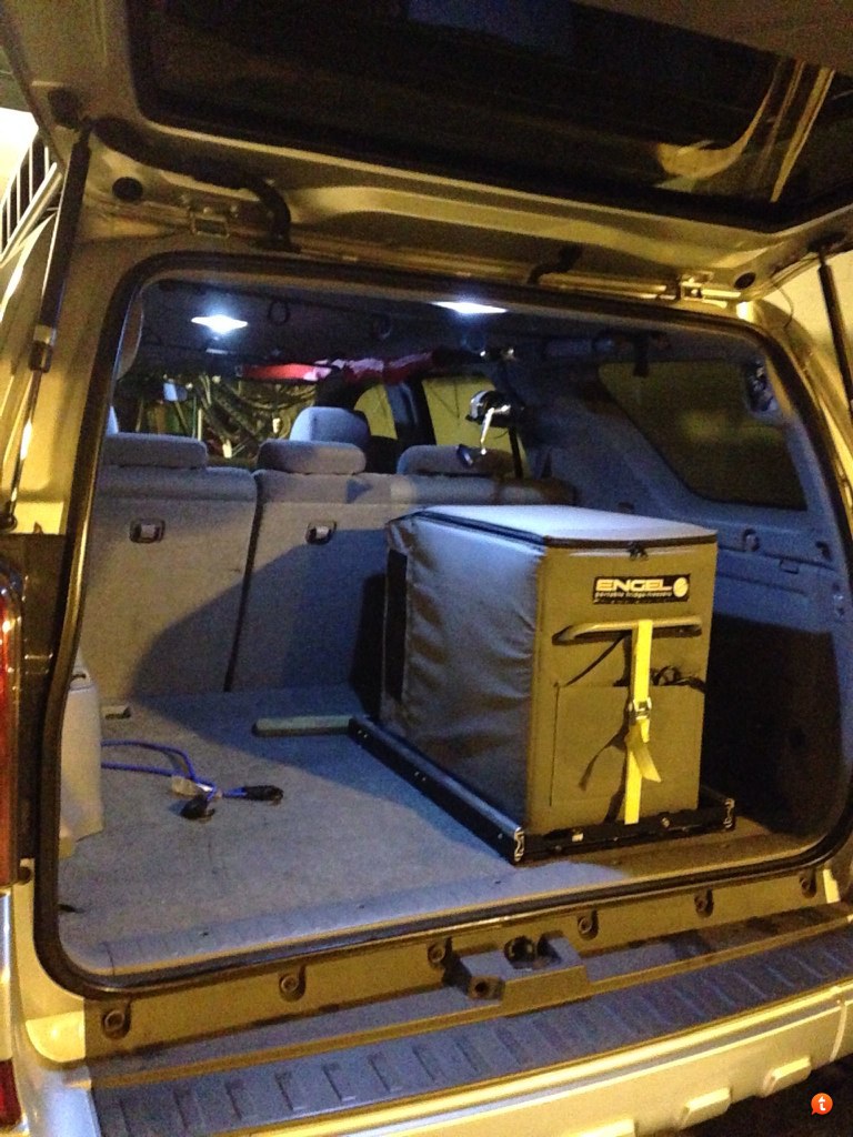

I took a 3 prong approach to fix the driver side lean.
I highly suggest it to anyone as I believe in function over form. LOL..
First I cranked the driver side front coil over just a tad:
Then I added a 2nd battery on the passenger side:
Then I added an Engel MT45 Fridge in the rear on the passenger side:
This combination may not be the most cost effective, but it did level everything off.
