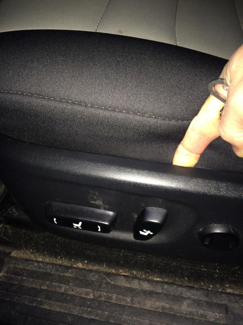

You can squeeze the buckle and strap down between the power seat trim and the seat cushion. Then you can reach under from the rear passenger area and pull it through. You need to be careful, don't just yank the strap through as you could rip the strap from the cover. So use one hand to keep pushing the cover down along the trim. It will take several minutes to get it all pushed into place and smoothed out, but it can be done without taking the seat out. (wow, my truck is pretty damn dirty!)
Where your fingers is and around that whole edge is exactly where I tuck it with a spatula :D Thats what trim tools are for right?
I used no special tools for my drivers seat. I just gently pulled on the plastic and fished the straps through. Just take your time and you'll be ok
Thanks folks!! Nothing like multiple success stories to give me the confidence boost to charge ahead. I used a wooden paint stir stick to get the strap past the trim on the passenger side. Perfect thickness and all smooth, rounded, soft edges. I'll get this thing done today!
Okay, job complete. If I was 50% younger and 30% smaller, this job would have been much easier. The routing on the side of the seat by the power seat controls wasn't too bad. There is an electrical "can" motor mounted on the inner side of the seat frame on that side. There is no going around it, so I opted to route the strap up an over the rail and the motor. The motor is mounted pretty firmly, and the electrical connections are on the bottom. I didn't pull that strap very tight, so hopefully will be fine. Everything else seemed pretty straight forward. Thanks again for the inputs!
