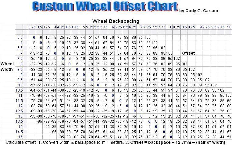

Here is a offset chart and our stock bs is 4.5". I wouldn't suggest more then a 5" backspace wheel or it or the tirecould rub the UCA's when the shock(CO) is fully extended.
